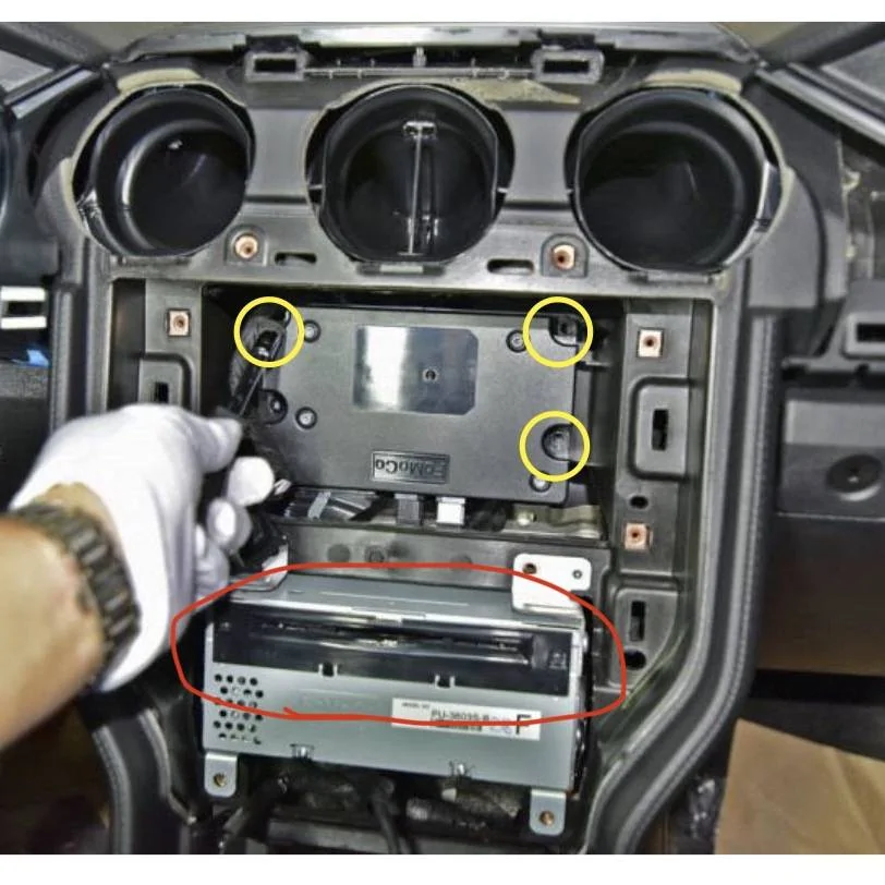

wow... crickets... I'm experiencing a similar buzz/subtle rattle on my 2019... don't know where to start...
Took me a while but I ended up figuring mine out. It was this black plastic piece surrounding the disk slot behind the radio panel, the part circled in red. I ended up putting a couple pieces of dynamat between the plastic piece and the metal it sits on and it has been silent ever since.

My god thank you. Been driving me batshit crazy for 2 weeks now
For sure, made me crazy for over a year until I finally decided to start tearing up the interior to find it. Hope it works for you too!

I knew it was somewhere in the radio bezel just wasn’t sure what it could be. You didn’t have to remove the console did you? Looks like a simple dash panel removal and a few 7mm bolts holding the radio and controls in place
I had to remove the dash trim, the center trim piece where the cup holders and shifter are, and then the radio trim bezel. It takes some time but it’s not too complex and only needs basic tools.

Welp. That wasn’t it. Same noise from same area. I also did the shifter rattle fix from Autofanatic’s YouTube video, even though that didn’t seem to be the issue. It sounds like it’s somewhere in the middle of the dash
