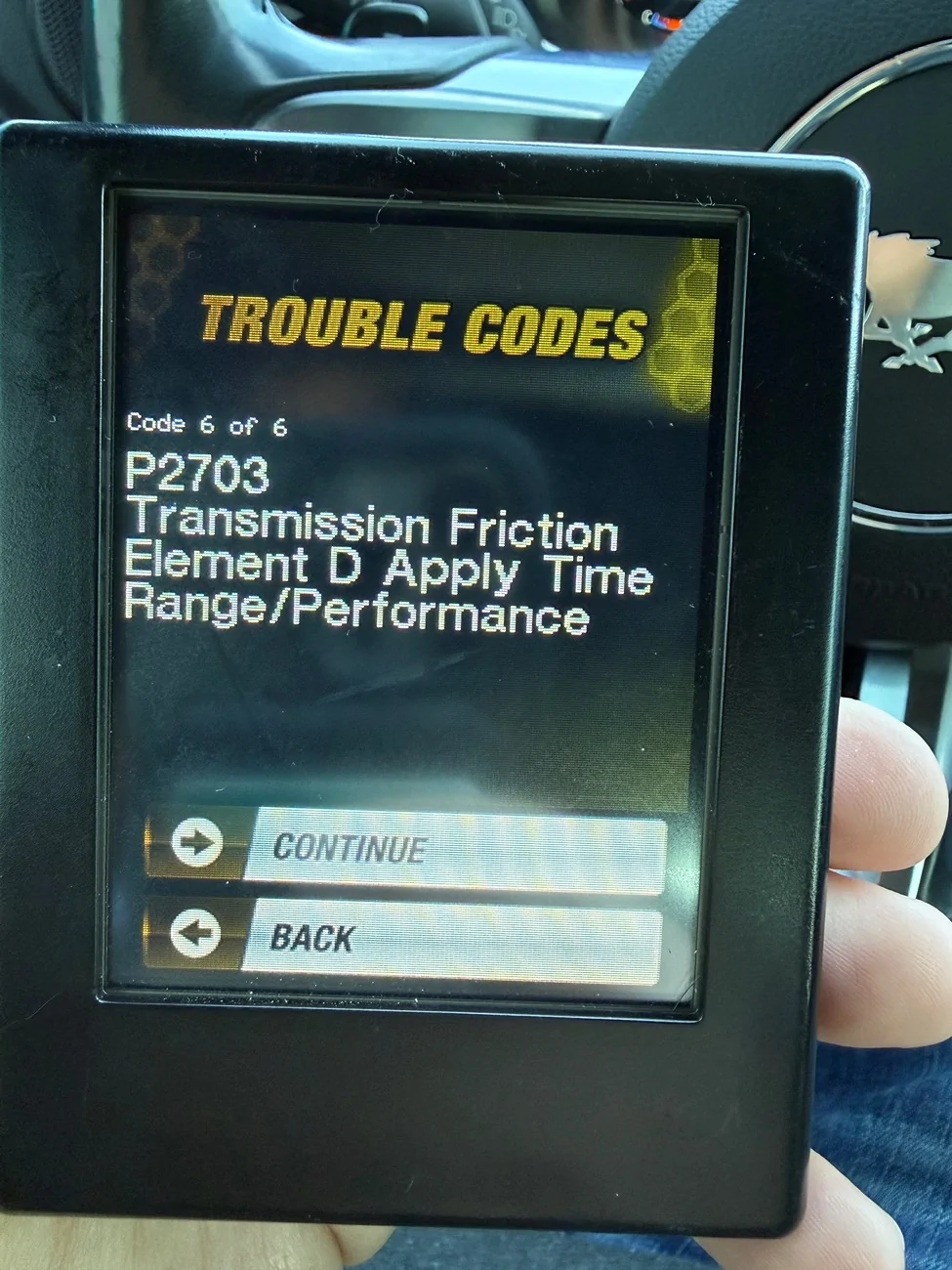

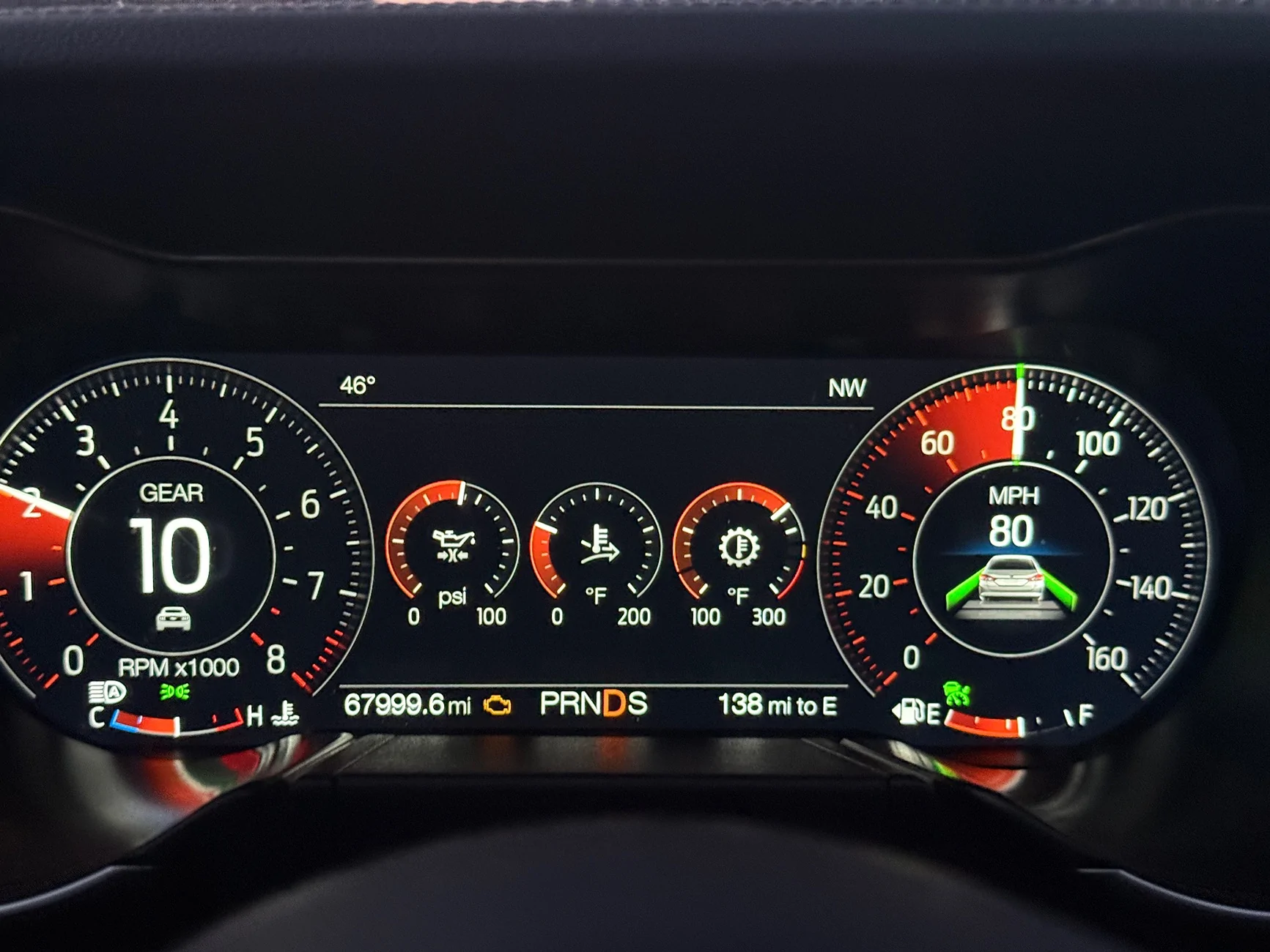

Drove it today to get the e85 out of it and flash the stock tune back so the dealership can read it.
Driving down the highway on cruise control and it does this:
Then threw the wrench and these codes and locked me out of every gear except 5th and 9th
Cleared the codes and it was fine again for the most part.
The dealership has it now
Keep us updated, definitely following. Sorry to hear it’s still happening!
