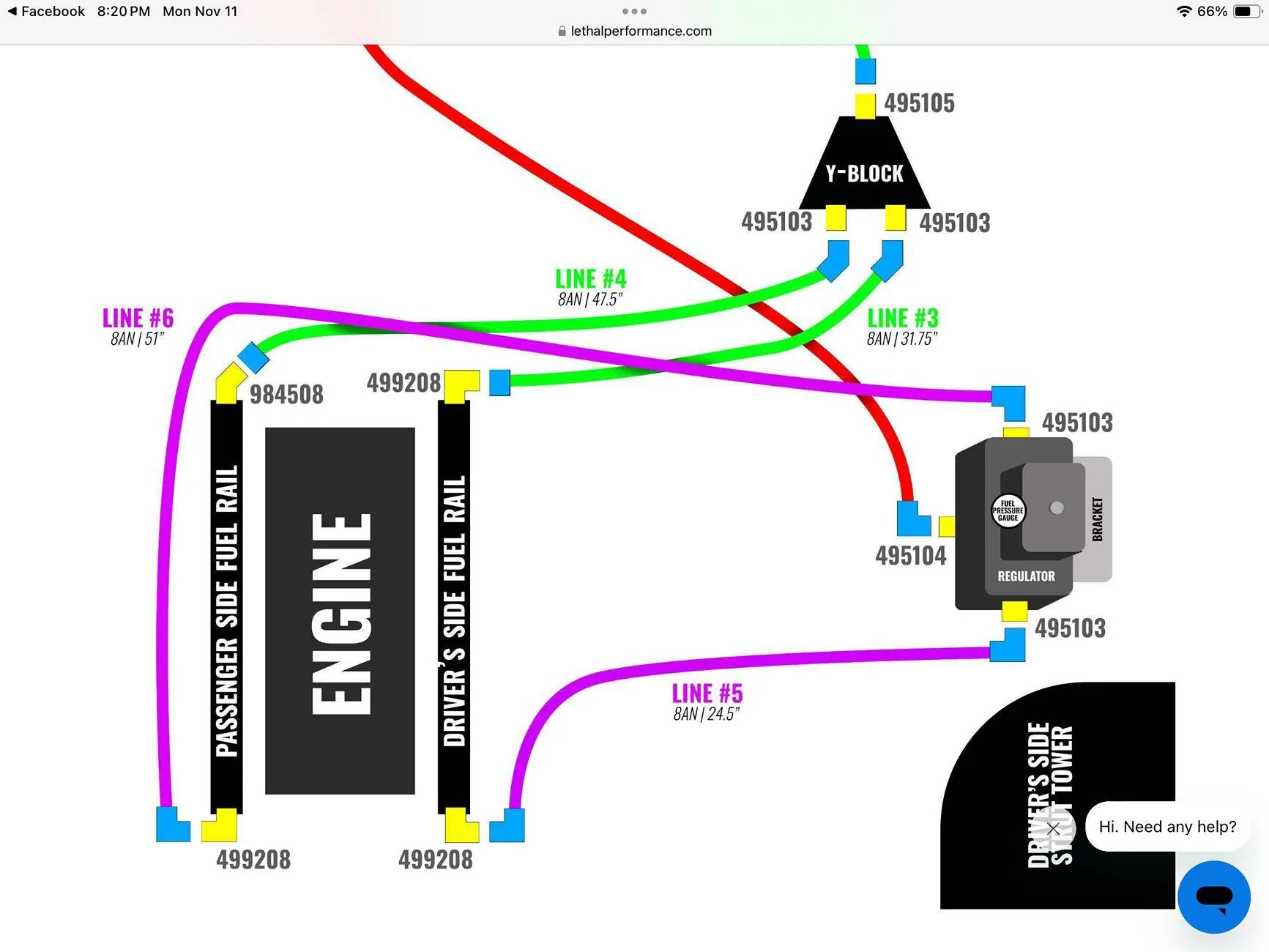

Now it makes more sense to me after seeing this diagram.
