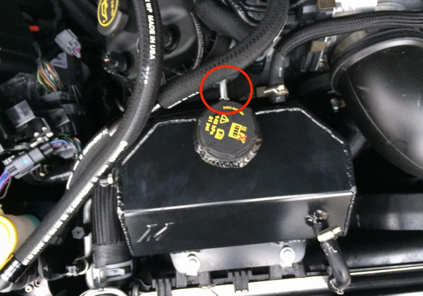

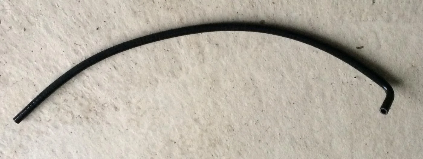

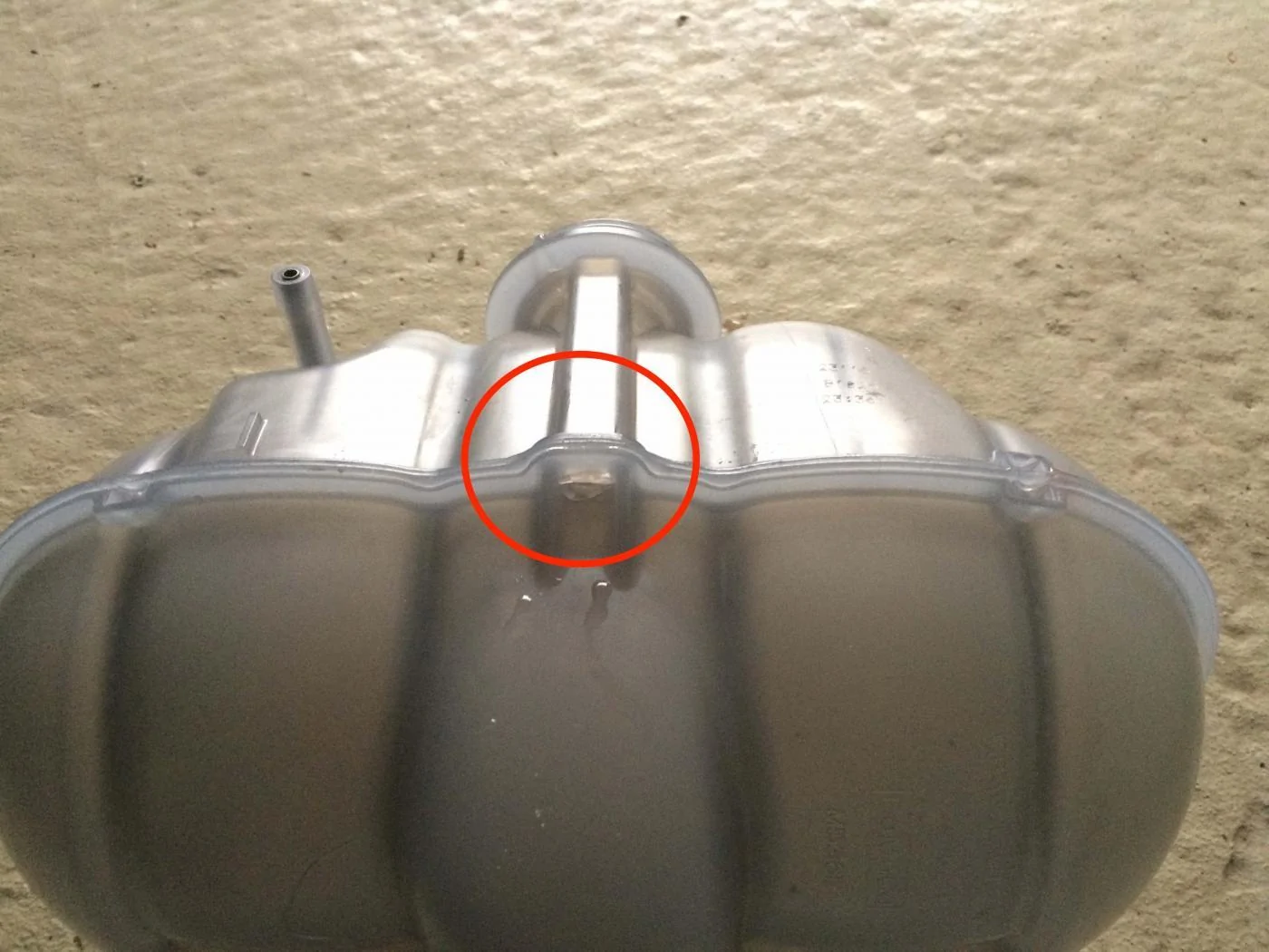

Outlet and hose
I already replaced my tank with the s550 Mishimoto. It fits just fine.
Sent from my SM-N920V using Tapatalk
The Mishimoto tank has an outlet under the cap and comes with an extra hose for it.
The original pumpkin tank has a relief outlet there too, but no hose. It's more of a slot. So, if anti-freeze drains, it's just directed straight down
Where should that hose run or connect to?
On the installation video, he connects it to something out of sight. However, the video is for a regular Mustang.
I could connect it and let it hang, but then it'll be flopping around near fan belts and fans. So, real options are--
1. Leave it off
2. Put it on and let it hang, but cut it to about 6 inches
3. Put it on and let it hang, but zip tie it to something
Just read the following: "Overflow nipple on fill neck allows for installation of additional NHRA-mandated overflow reservoir"
No plans to install overflow reservoir, so still in the same position.
Experience/advice welcome

I attached it and ran it straight down, then through a hole in the belly pan and put a thick o-ring on the underside of the belly pan to keep it from pulling back up.
I don't expect to drag race the car, so not worried about an additional overflow canister.
