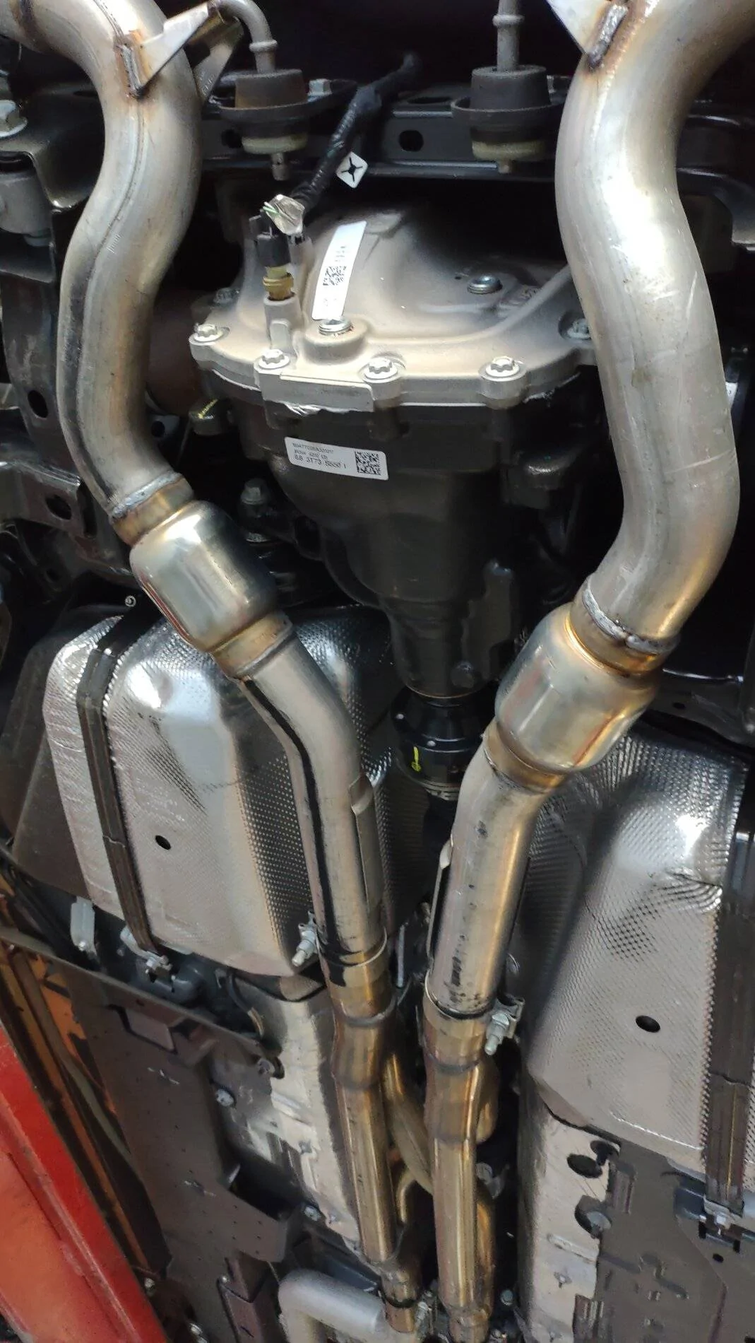

I don't have the Borla S type but I do have the Ford Racing Sport by Borla which has a very similar tone and volume. I went with these and it did knock them down a tad, just a tad. Still pretty aggressive.
Total Flow mini Race muffler
