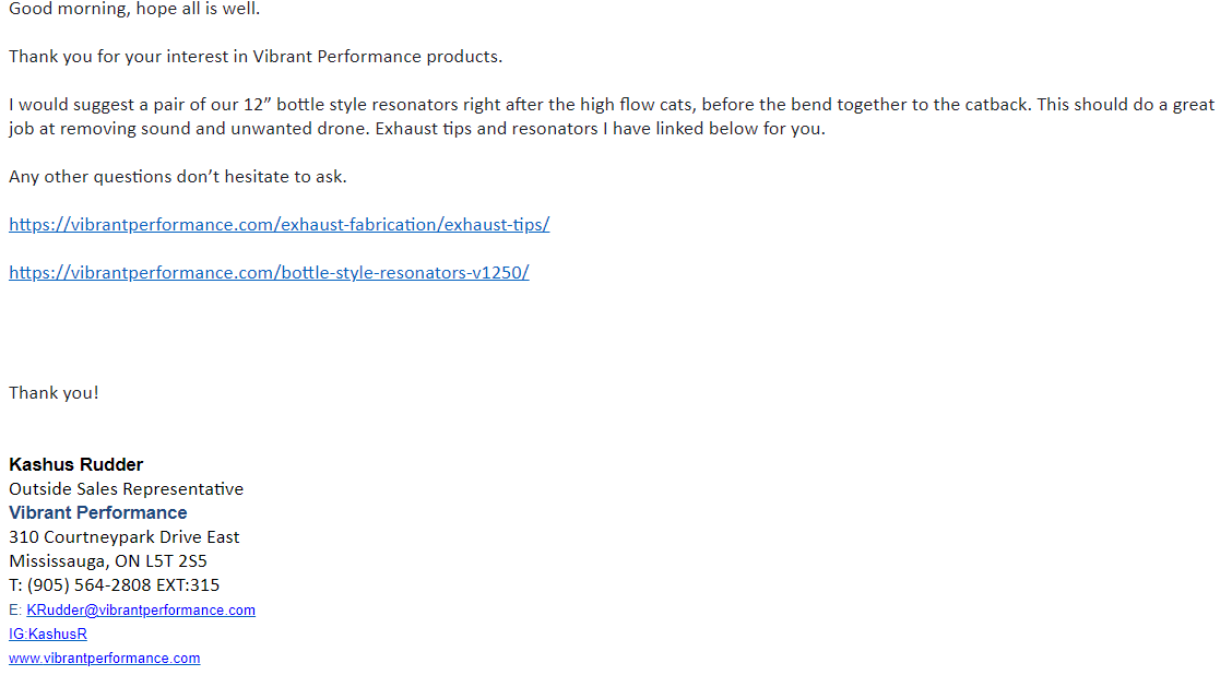

My 2019 GT PP1 with LTH and Borla Swithfire is now to loud for me. I am going to put TWO "HIGH FLOW" 12" Resonators just past my high flow cats to quiet mine down without negatively affecting my performance. This company is one that I am thinking of going with. Good Luck
https://vibrantperformance.com/bottle-style-resonators-v1250/

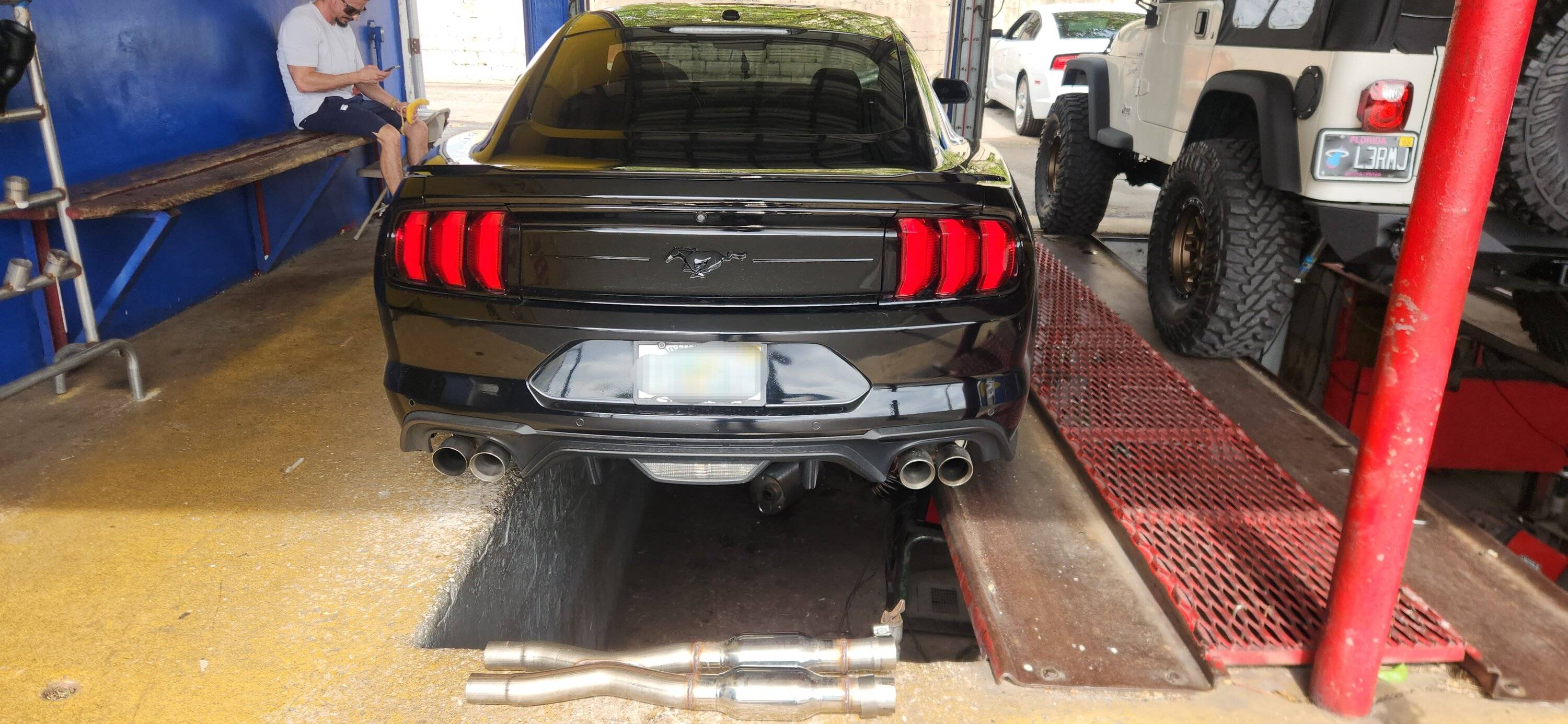

Pardon my forum rust. 1 st post on here but seeing how i literally dealt with this 3 days ago. The roush mufflers combined with any midpipe X or H do become obnoxious to daily drive, and are definitely not neighbor friendly on cold starts. I second the Dougs550 on vibrant resonators. Just installed on my premium. Steeda H pipe with the roush mufflers. Definitely an improvement. Cut the vibrants of the sr x pipe and welded to my steeda.
Anyway you can send me a sound clip? It’s exactly what I’m looking for, specifically. Thanks!!!
