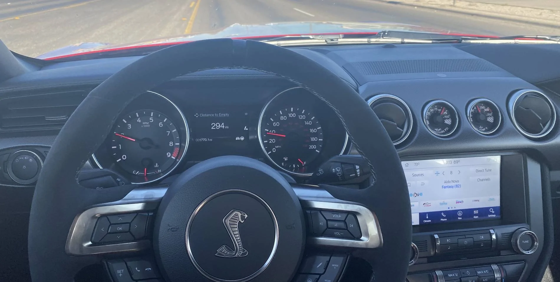

It’s losing about two quarts every 300 miles, so far. The oil pressure is a consistent 98 at 80 mph-ish. I’m not running it hard at all. Being very, very careful to keep the psi as low as possible. I don’t want the leak to get worse before I get to my destination.
Here’s a pic of the current situation. Note the rpm and psi:
So, before I get it to the dealer, I figured I’d ask your opinions on the cause. See if anyone has dealt with this situation prior.

First, your oil pressure is right where it should be. That's not a problem.
There are only a few places it could be leaking, If it's the filter, then the housing needs to be replaced - it's not a spin-on filter so the torque is easier for the dealer techs to get right. There are two other candidates for leaks down there - there was a TSB in 2017 or 2018 about leaks from the oil pressure sensor on the filter housing. Symptoms were what you're describing and the fix was to take the sender out, clean it up, put on thread sealer and reinstall it. The last possibility is the plumbing that runs to the oil cooler. It's unlikely, but possible that one of the two cooler lines is leaking, although they've been very reliable in the past, so it's unlikely.
In any case, your dealer is where the solution is and driving 1,000 miles to the selling dealer makes no sense. Is there another local dealer that sells FP vehicles that you can go to?

+1 on the oil pressure sensor. Take the intake tube and air box out and you'll be able to get a good look at it.
I had this problem and a bit of Permatex Seal & Lock on the threads took care of it.

And if he's noted puddles on more than one occasion then something is actively causing it. The oil pressure sensor is a known issue and needs to be verified. In my case the only thing that kept it from falling out competely was the wiring harness and connector preventing it from spinning any farther. It's easy to pull the air box and and put eyes directly on it.
