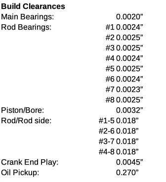

Here is how my engine was built and it has given me 0 trouble on the road course. Rod bearing clearances are towards the upper limit, main bearing clearance is actually 0.0002" over max limit. If this engine ever needs to come apart I will be reducing main clearance to 0.0015".
Compression ring is gapped at 0.019" and second ring is gapped at 0.022". These might need to be opened slightly for a boosted application.

are there preferred machine shops you guys would send a short block out too? im in DFW/north texas
whats the consensus on 8-12psi on 11:1 comp for ring gaps?
@thelostotter how were oil pressures with near max bearing clearances and are you running a heavier weight?
I originally ran 5w30 and 0w40 with a very efficient home built oil cooler and oil pressure was 80psi at WOT. It is worth noting I had to block off the piston squirters because I used Wiseco pistons. I also used low leak GT350R lash adjusters and cam phasers, I don't know how much affect these really have.
That oil cooler sprang a leak so I tried the Harrop kit which is way less efficient and now I need 5w50 to maintain 70psi at WOT hot. Not really that happy with this oil cooler but I know the loose mains are contributing so that’s why I’d shoot for tighter next time. I’d also use a piston which would let me maintain the piston squirters if possible.
