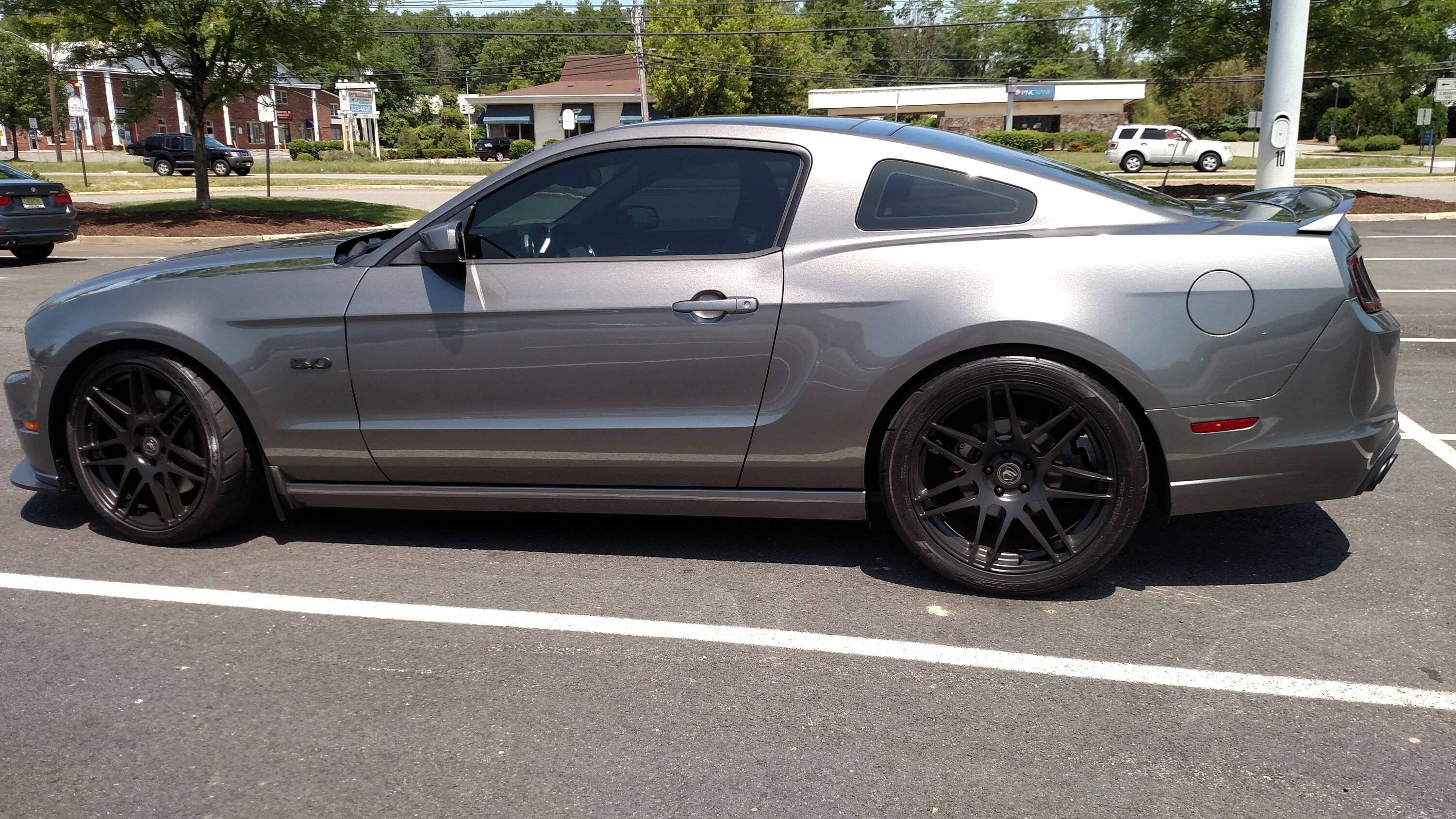

I ran the exact set up on my 2014. I dont think this looks like a truck tire. Am I missing something?
