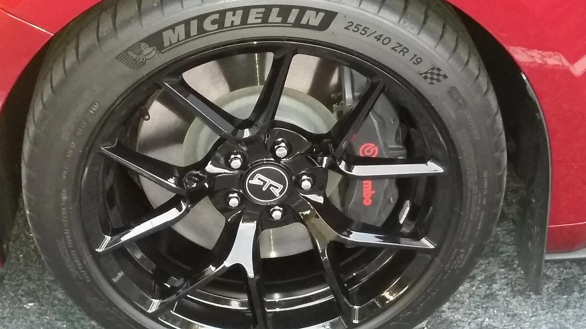

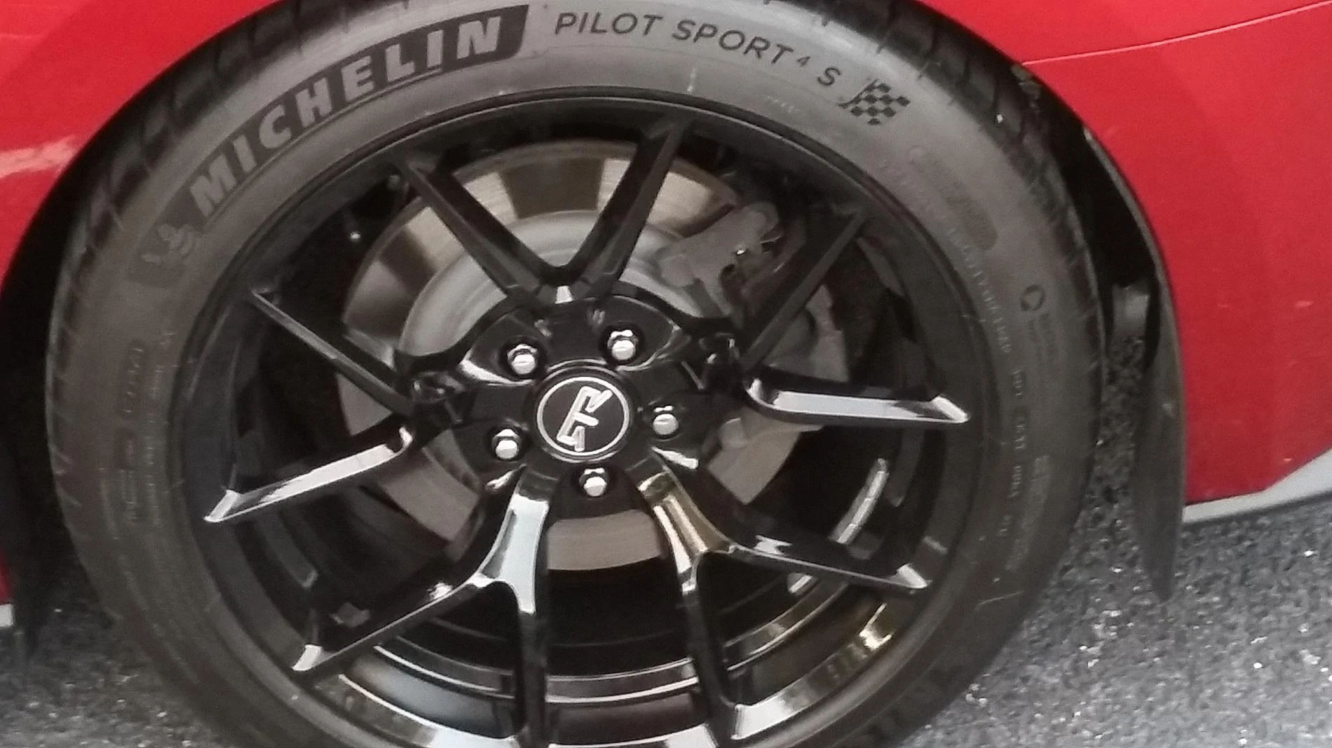

" wheels what would 275/40/19 PSP4S tires look like on a 19.5 x 19 33et look like, I purchased a set of the RTR 19" wheels-19 x 9.5 et 33 fronts and 19x10.5 et45 rears. I put the stock set up on the fronts and rears(255/40/19,fronts and 275/40/19 rears), I'd like to square the set up with 275/40/19 all around, your thoughts,thanks for your help, also any other tire size options would be appreciated also,ex.(275/40/19 front,305/35/19 rears),thanks again:amen::amen:

275/40 would be good to square it up. A 295 would be the ideal fit on the 10.5, but 305 would fit well too with no problem at all.
