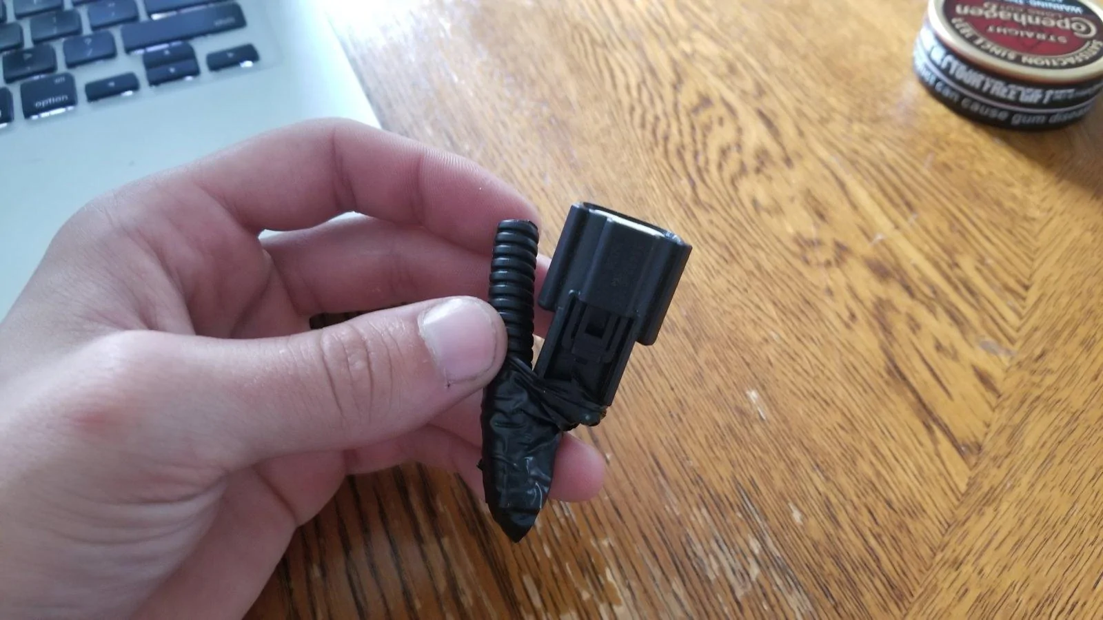

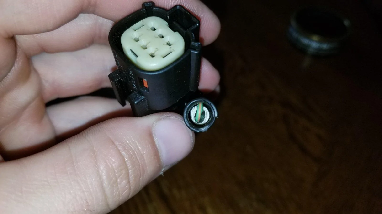

I've been driving around for a few weeks now with the #62 fuse pulled until I came across this thread. So this morning I put the fuse back, no more dash lights (obviously). Pulled the plug and the dash lights come back on as they were, which I expected. What's confusing me is the plug on my car. It seems it was jumped. I haven't undone the tape yet to look but when this was plugged in there were no dash lights on. I'm trying to figure out if the previous owner jumped the plug to itself to avoid having the dash lights on. Does the wire normally go somewhere or is this plug a remote piece that talks to the system?
Hivel
Jan 2, 2018
249
105
NorCal
Mustang GT
That plug is wired as a jumper. It is simply connecting two of the contacts in the male connector.

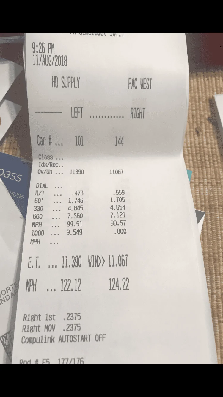

Yep. My MPH was down about 2 MPH. The DA was between 1300&1600; so, I thought the MPH loss was caused by my failed 100 octane test.
Maybe it’s all the wild fire smoke we’ve got here in NorCal right now.?
The track mph could be a little off

Advance Trac coming back on is a common problem with some 5th gen Mustangs as I recall and definitely with S550 GT's and GT 350's in autocross and open track. It has been discussed in various threads here. I've never seen a solid explanation for why it happens other than very rare reports of major "loose hub" or similar situations. My 15 experienced the problem a few times when I first got it and then never again despite hundreds of autocross runs over 3 years. My 18 took over 150 runs before it happened 3 times in one event and then did not happen in 9 runs at the next event. Pulling the jumper plug pictured above seemed to work fine for me and still appeared to allow MagneRide Track mode setting.
Details of my experience here https://www.mustang6g.com/forums/th...eryone-done-so-far.24778/page-51#post-2321807
Lots of input from others in that sub forum and in that thread.
