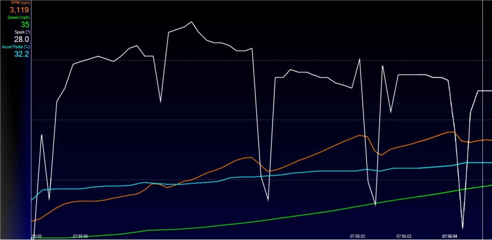

I finally got my data logger. So, at tomorrow night’s TNT; I will have proof that drag mode doesn’t pull timing. I already have logs showing A10 shifter in S does cut power before each shift. See the waves above.
I also now know the ECU correctly infers the 91 octane California calls premium. I’m gonna run GT260 tomorrow night and hope the ECU infers at least 93 octane and advances the timing.

Agreed, while in S and Drag Mode I got the cut in power, I'll be darned if I remember if this happened in D and Drag Mode. I may be going to GLD in Wisconsin this Friday where I can run the car with more knowledge than I had before.

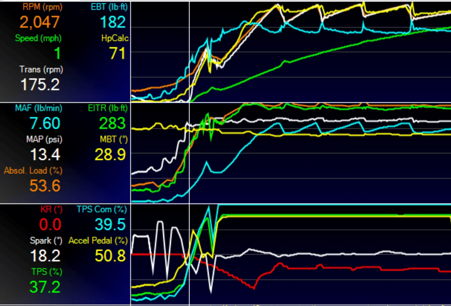

I know this thread has been hijacked to an almost evangelical level of FUD. But, I wanted to post my drag mode data log in case someone made it through all that...
2018 drag mode with Advancetrac off does not pull timing. The yellow line in the bottom box is my throttle position. All the other lines are controlled by the ECM. The green line in the top box is vehicle speed. The “bumps” in the green line are traction loss. I pedaled the car too much and it shifted into second way too early. But, there was still massive wheel spin. That run was about 4 tenths slower than the others.

I'm reading TPS and Spark being constant once you were in 2nd, right?
Am I seeing gears 1 through 6 here?

I think you’re right. The spark held steady at 22 degrees after it hit WOT. When the car hit second while I was pedaling the launch; I held the pedal position until the tires stopped spinning. I floored it for the rest of the pass when I felt the tires grab.
It’s a PP1 car and the car is in 6th through the traps at about 117 MPH.
