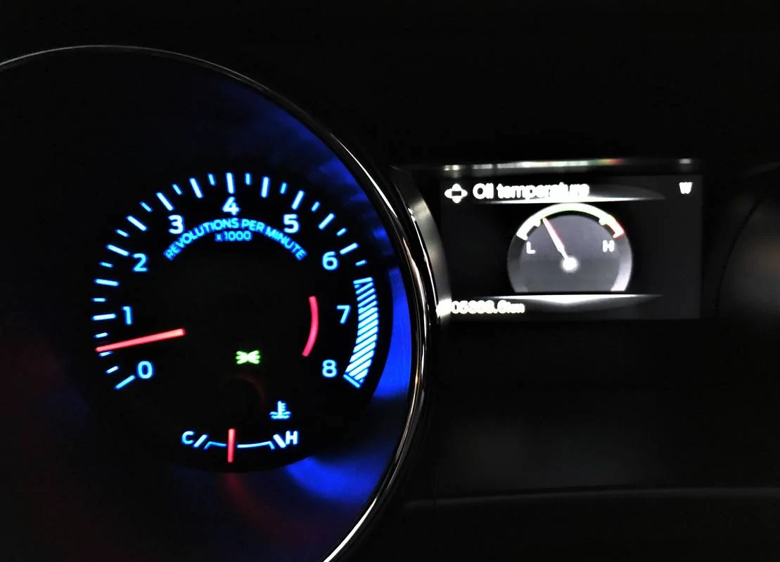

I have been told by numerous people over the years that the best way to warm up your car is to just drive it. Start, let idle for the time it takes to buckle up and set the audio, then drive gently until the oil temp is in the normal zone.
I took this image to display that just because the water temp being normal, the oil temp takes longer to reach normal operating temp.

I wait until the oil temp. gauge is settled or nearly settled in the green "normal" zone before getting on it - on a cool morning that takes about 6-7 minutes of driving - shorter on a hot day. If it's close like in the pic above, I may let it go to 4-4.5k rpm, but not redline. Once it's settled at almost 12 o'clock (usually around 11:30 or so), then I am free to rev. to the moon. It is true that on my car the coolant temp. settles a few minutes before oil temp.
