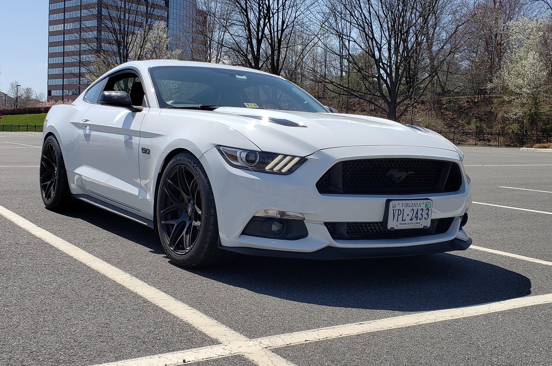

The Ford kit includes all you need for an alignment within Ford specs. It is meant to run more camber than the base coupe suspension. If you want to run the alignment specs that your car came with, you may need camber plates/bolts. If you wish to run the track suspension within the specs Ford recommends, you won't need camber plates or bolts. Mine is a daily driver within Ford track suspension specs without the camber plates or bolts. My tread wear is very good.

The difference in parts compared to original PP suspension are: Shocks, struts, springs, front sway bar, rear stabilizer bar, toe knuckle bearings. The toe links are the same as the PP.
I did all my suspension modifications at the same time, so I can't comment on the Ford track package alone, but I daily drive my car and the NVH is not that much greater. But NVH is a very personal measure and what is not noticeable to me, might drive someone else nuts. It handles much better with less body roll and less brake dive. It is much more planted when accelerating from a stop. I have no regrets on any of my suspension mods and wouldn't hesitate to do them again. The drop is also very manageable for a daily driver and I do not find the car bottoming out on speed bumps, etc, but I use common sense when driving.
