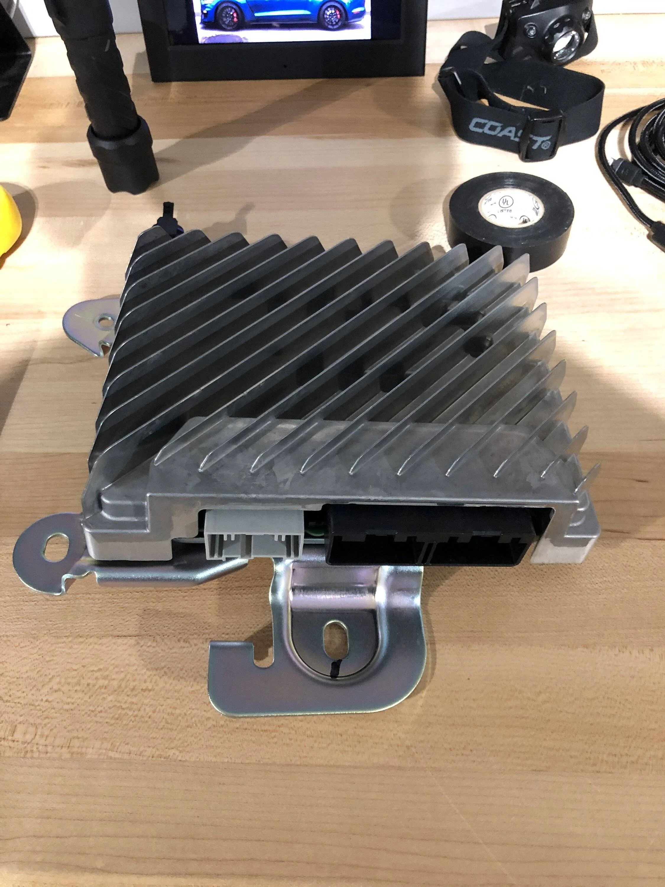

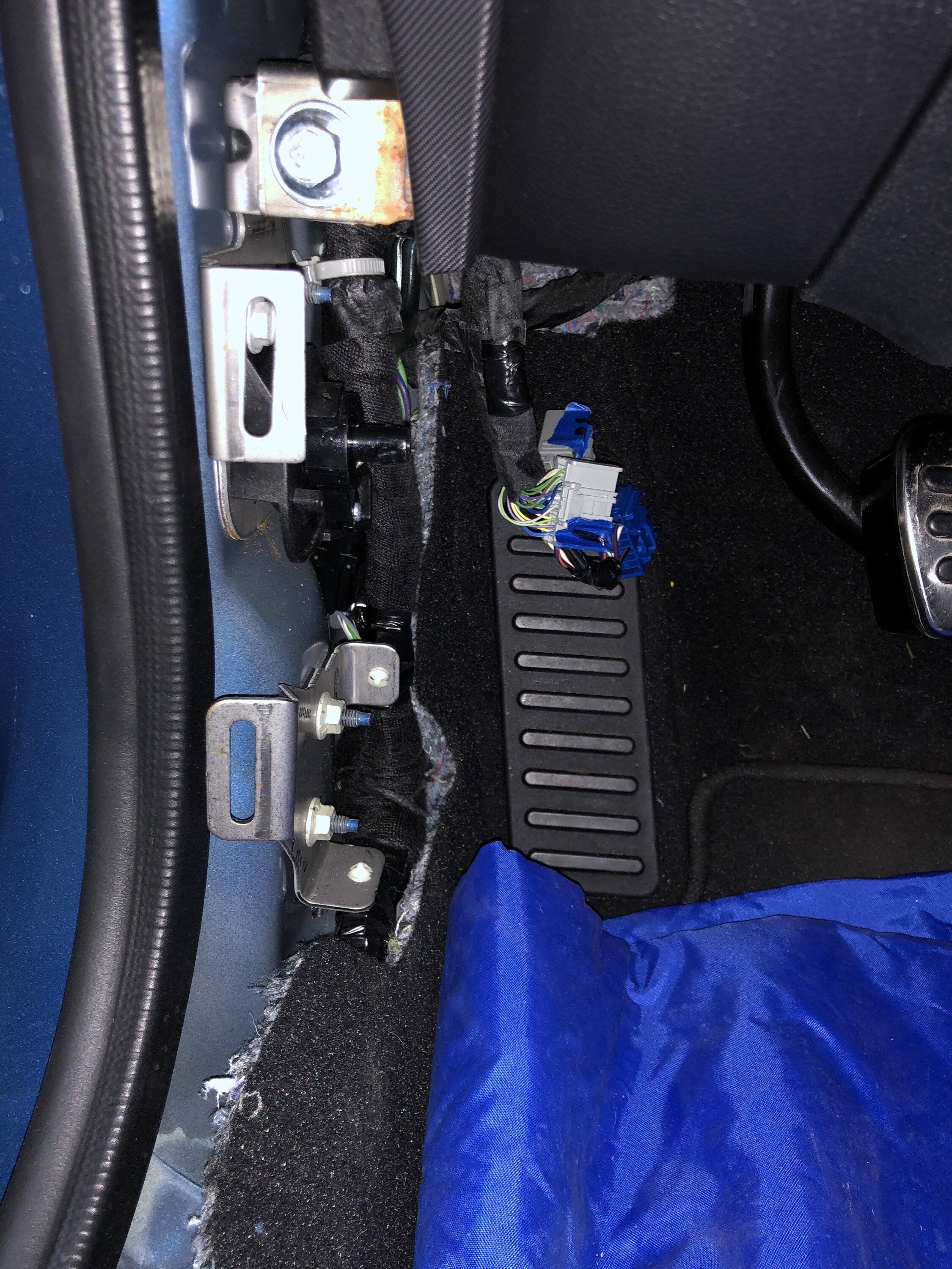

An update to my original post.. I was able to remove the dead pedal plastic cover and then pull the carpeting back from that area which allowed me to then drop/slide the module down to clear the clutch sensor assembly.. what a pain, but now that I look at it it's setup just the same as the old module.. metal on metal...
i don't have pics of the carpeting pulled back, but this is the general area where I removed the dead pedal and pulled back the carpet...
