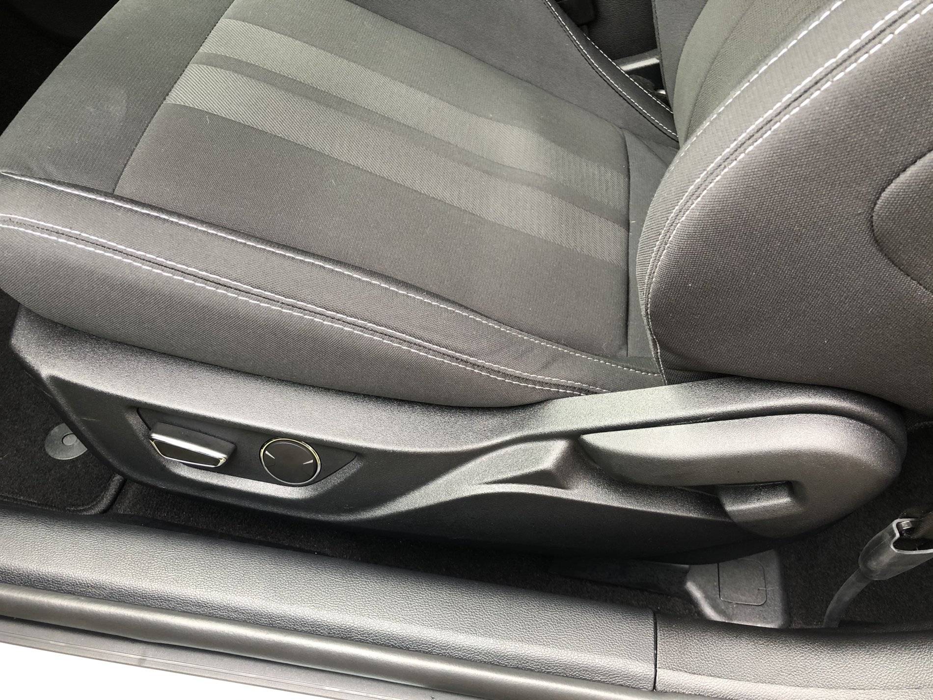

I had a similar issue in the passenger side of my ‘19 Bullitt. Turned out to be the seat control panel on the side of the base of the seat rattling against the plastic seat valance that runs down the entire length of the seat base. Drove me crazy. A small bit of rubber gasket between the two has solved that issue for me.
Good luck and let us know what you find.
Interesting, I didn’t think of checking that plastic part of the seat. How hard was that piece to remove? I’ll have to check that part next along with the A pillar trim

Didn’t remove any pieces. Isolated the two plastic pieces by placing some small rubber material in between them.

It’s the piece on the side of the seat with the seat adjustment buttons, correct?
Yes. That piece would rattle against the larger valance piece that covers the side of the seat base. I put a thin piece of black rubber gasket material between them.
I will definitely look into this. Either it will fix the issue or we can rule it out!

So I went out this morning to check a couple things and it turns out when I bang on the upper portion of the drivers seat, the control panel portion of the seat does give out a rattle/vibration. When I beat on the passenger seat, it was solid. I pressed on the actual button part of the seat and this is not the part that is loose, something is loose behind the panel that runs along the length of the seat itself, near the front. Anybody have any clue how to pop this panel off? I see a torx screw up front, will attempt removal tomorrow when it will be a little warmer. I also tapped on the A pillar and it is issuing a vibration but nowhere near as pronounced as the seat is. I’ll attempt to fix the seat first and then move to the A pillar :fingerscrossed: Fingers crossed that one of these is the issue. If not, I have a strong feeling I’ll be searching underneath the car again

As far as the plastic area of the seat base - it’s possible there is a harness behind it that is rattling. I think the easiest fix would be to unbolt the seat from the floor, take it out and position it so you can see exactly what’s rattling when you tap on it.
