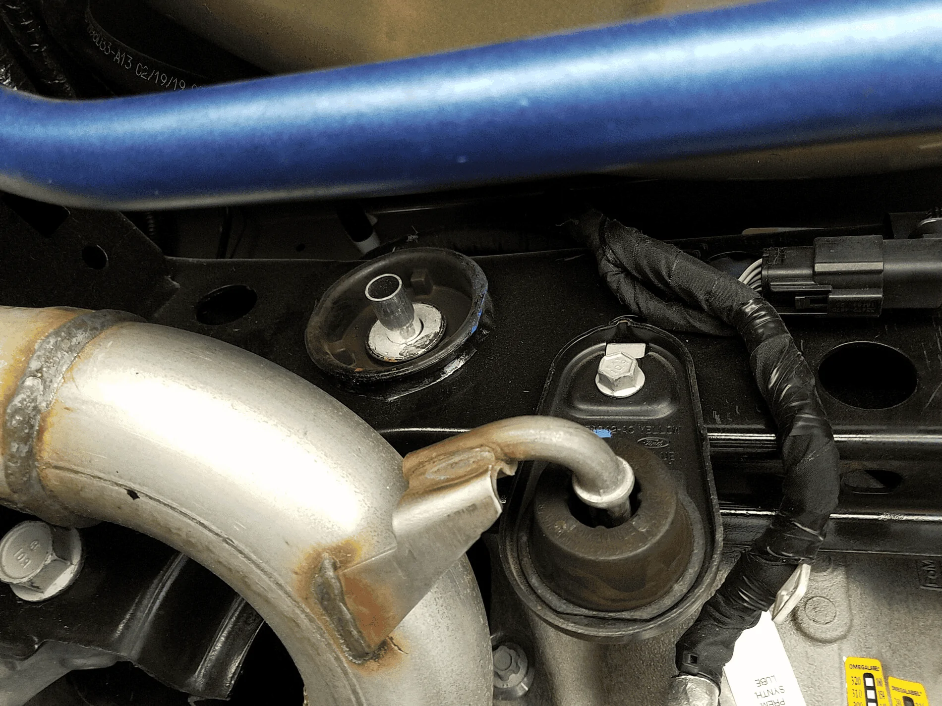

Did anyone install the other aluminum sleeve hat looking one. No idea where it goes & for some reason I'm not being allowed to upload a pic
