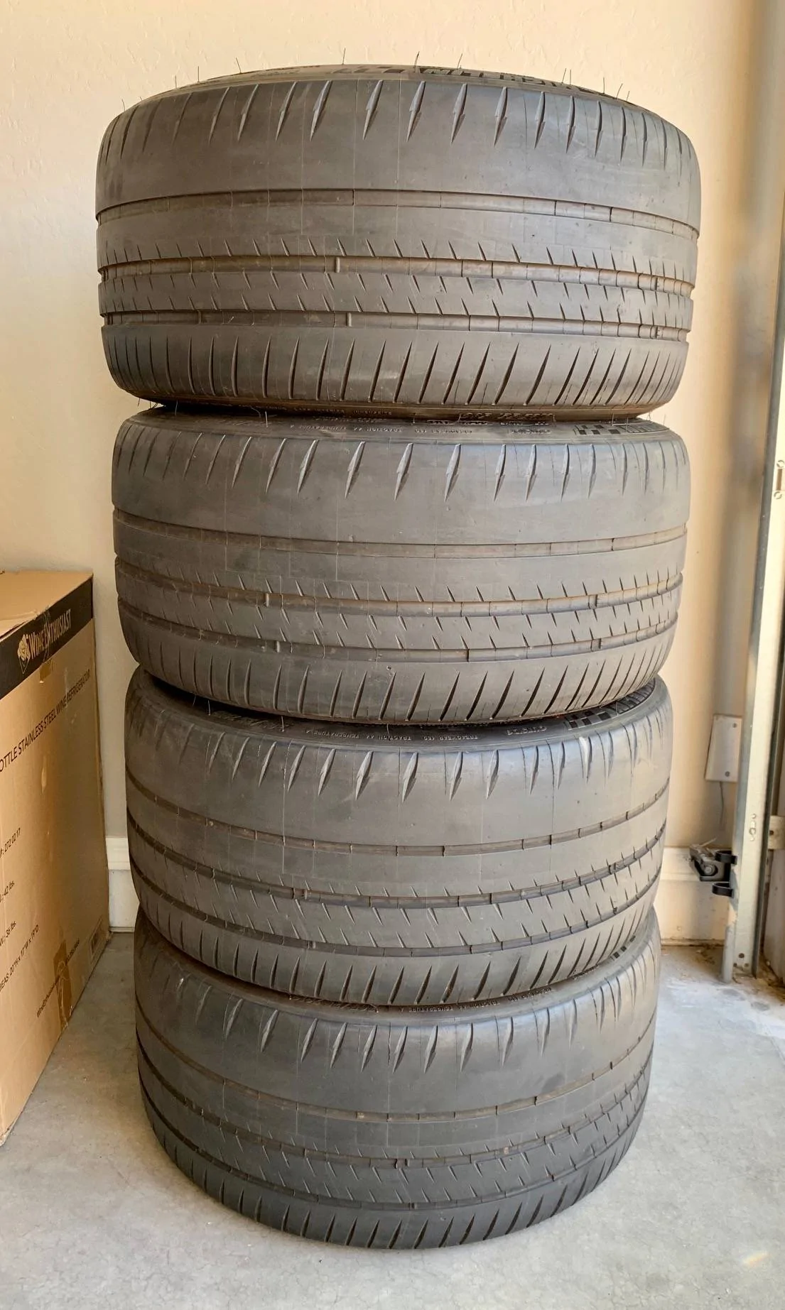

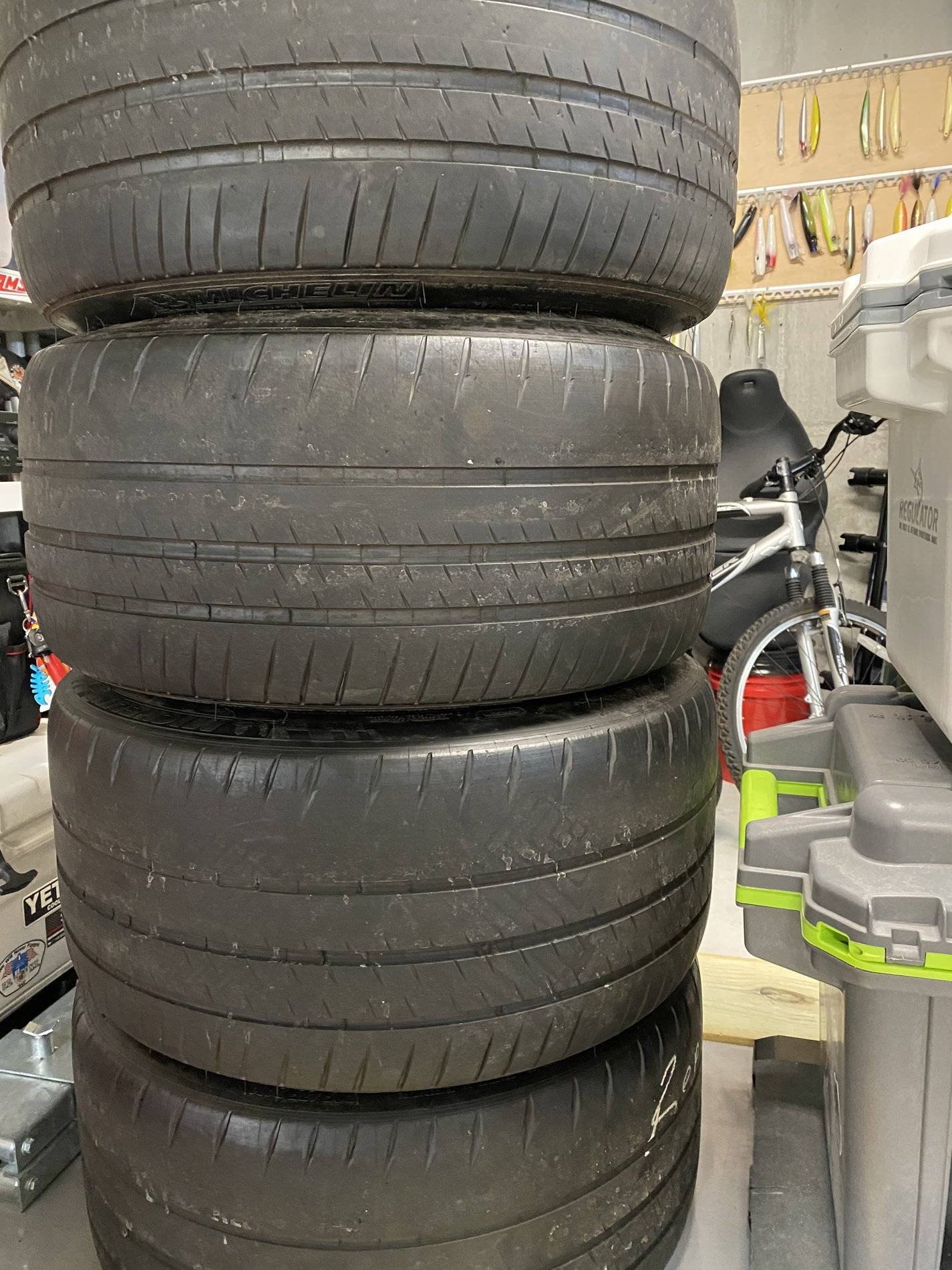

They had to equip it with the Cup 2's to get those impressive media reviews.
I wish I could have specced the car with PSS - it would have saved me $1400+ and I wouldn't have a stack of Cup 2's in my garage I can't sell.
What size's
I have the same stack. LOL
