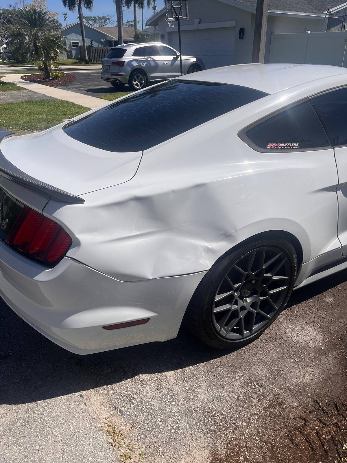

Sister hit me in her truck pulling out of driveway going 2 mph, how much do you guys think this would cost to repair?

Unfortunately that’s probably expensive beyond what she’d be willing to cough up.
Insurance is the answer here unless you’re okay with some backyard tomfoolery.
Edit: I support backyard shenanigans, I’m probably one of the worst offenders on the forum. If you don’t about resale grab a pry bar and hammers LOL.

That is a full quarter replacement. Will be costly. $10k or better.

No yea I understand lmao but you don’t think a body shop can just pull out the dent? I get it, it’s the quarter panel but it looks like it could just be pulled easily

Not a chance! Several areas are bent that won't cooperate well at all. If you get into pulling it out you can improve the damage but it won't look right. It's driveable, though if you can live with it. Bummer.

Absolutely, it’s up to you to decide how deep you want to go into this.
That would definitely be cheaper than a cut/replace of that quarter.
Depending on who you ask “recovering” that panel might cost more than cutting/replacing.
Grab a few quotes! Our cars are still pretty late model so doing this properly in the name of resale/aesthetics is preferred (in my humble opinion).

That's actually not a bad idea. Ask around your local area and find out who a few reputable Paintless Dent Removal guys are.
They could probably work some magic on that.

PDR will not be able to pull that out to even closely resemble before panel damages…
PDR may be able to just pop some of it out (the real low lying areas), but you’re talking HOURS of work for any Pro PDR to do such a job and not having it end up looking half way decent.
As others said, to repair its a definite 1/4 replacement and won’t be cheap by any means. The only way to cheapen the hit on a full 1/4 replacement is:
- tell them you will remove as much as you can prior to dropping it off…. which would be bumper cover, taillight, trunk lid, rear seat, and entire rear 1/4 interior plastics on that side of the car. They will need to remove any other major parts if needed.
- Just have the shop properly hang the 1/4 and prep in primer without paint….
Unless there’s a BillyBob nearby with a 20lb can of Bondo and 10 Rustoleum White Spray cans….
