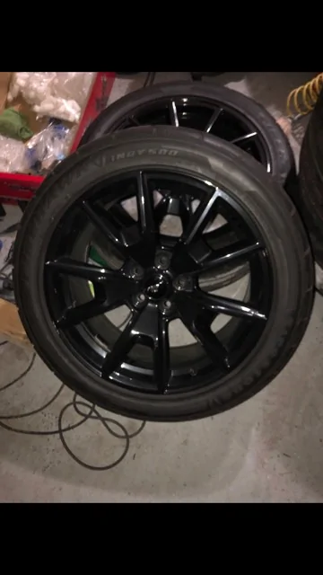

The rims I have though are only 8.5" wide. I have run across someone with the same rims I have that has installed 275/40/19 Indy 500's on them. The specs on tirerack for that tire say a 9" rim is minimum recommended so I'm a little leary of running that size tire on my rims, even though I know its physically possible now to install them.

These are the same rims i have, but some has installed the 275/40/19 Indy 500s on

Oh sorry, though you already had 9.5" fronts. Better stick to 255s then.
