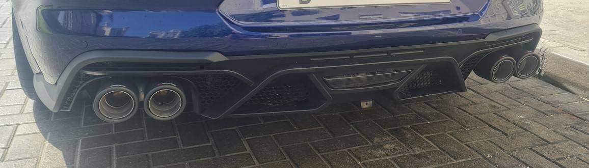

Does Anyone put Heat Tape above their exhaust tips on the rear diffuser to prevent heat damage caused by exhaust Muffler tips which go through the rear diffuser? Thanks
already melted one diffuser :)
You need to make sure tips has enough clearance from the top and they stuck out far enough

What type of exhaust do you have and what tips are those?
I have the roush catback kit . Previous owner installed it but he did not install the tip so there was 20 cm between exhaust and the fake tips that comes with the diffuser . Result melted diffuser after 15 mins of high revs .
These tips are aftermarket tips . The shop I found d had the borla quad tip chrome color and these ones which is wrapped with carbon fiber. I liked the look of these so chosen this one
