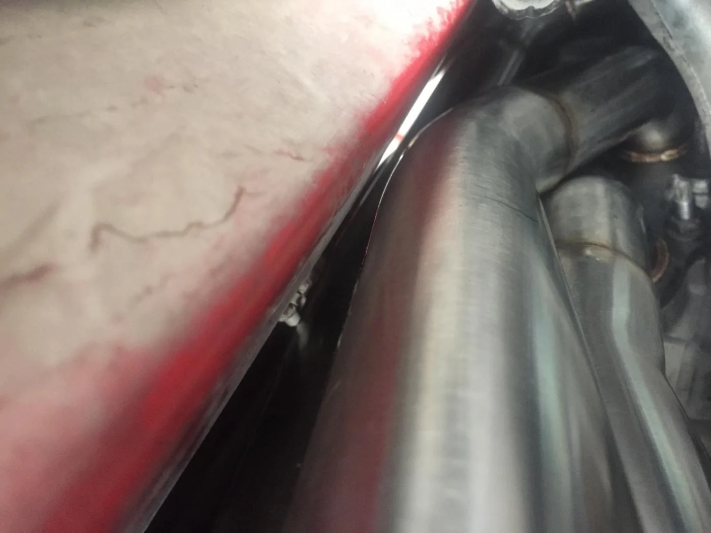

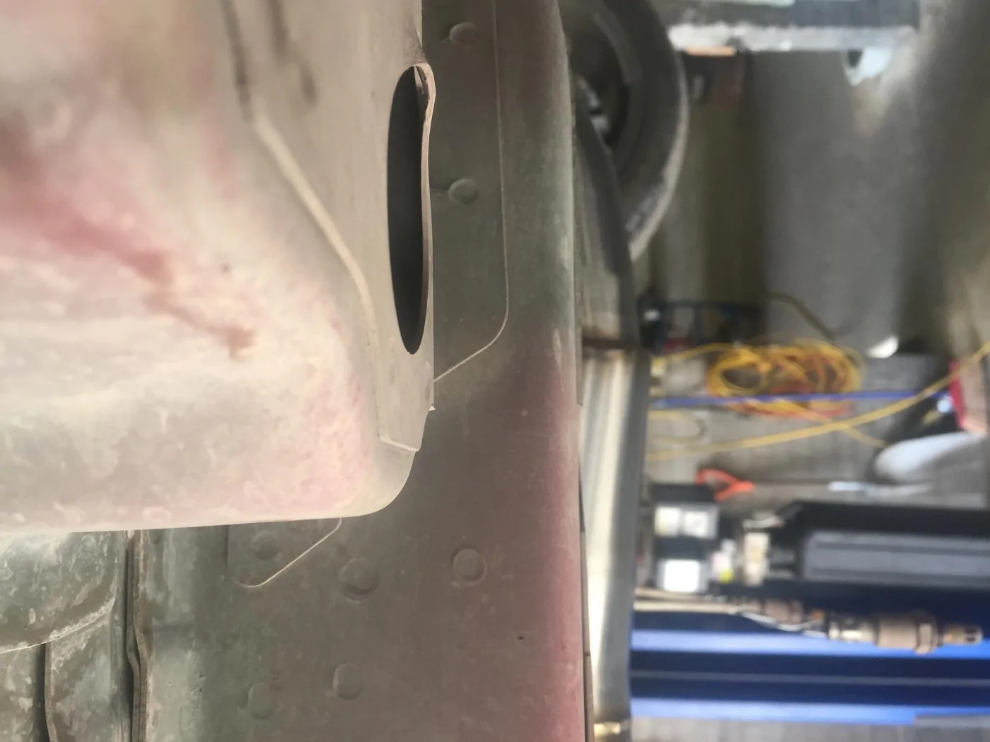

Yup im here at the shop trying to get the ac bolt out of the way. Took the chance to take some pictures of my clearance issue with my o2 bung
Thats with the L shaped 02 extension i bought. Without it theres no way it would clear the brace.

So just left the shop and im finally rattle free! We had to cut part of the bolt sticking out and all is good now.

Sooo umm I'm a little confused whats the point in the "L" shaped adapter???

The o2 senor would not screw into the pipe because the crossmember bolt head was in the way.
