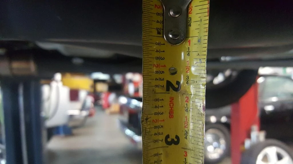

I will relocate that bolt. What is worrying me the most right now is ground clearance! These headers hang way too low for lowered cars and mine isnt even lowered that much. I tried measuring and i have close to 3 inches of clearance.

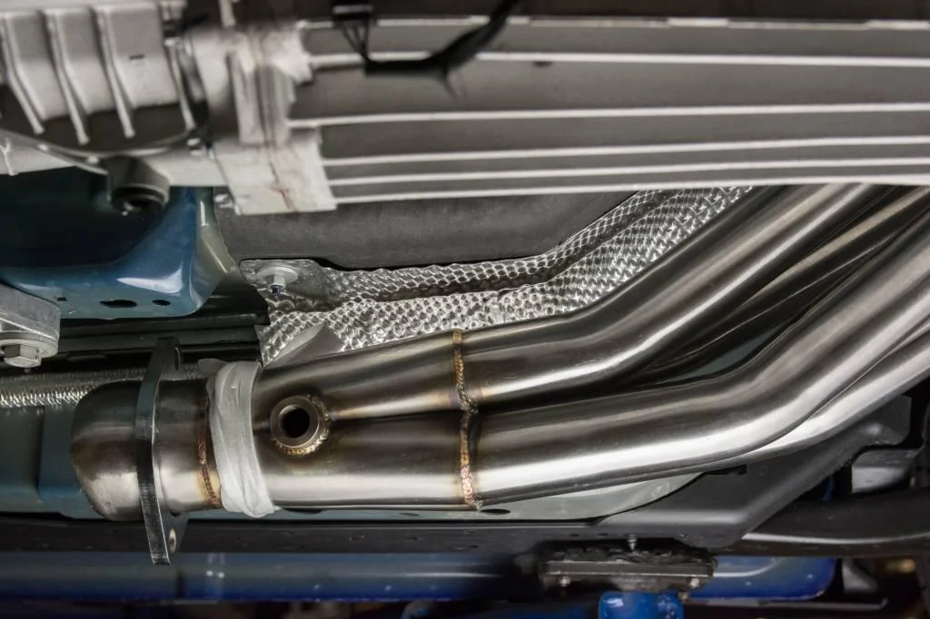

heres what you should look like pretty close
again, we didn't install and i'm not there in person, so i can't say for sure whats going on, but this is about what weve installed looks like

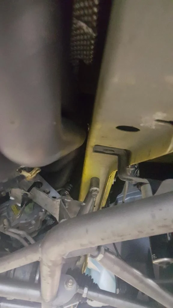

this is from the inside, but you can clearly see, they sit below the frame rail

the headers are a big solid piece so not sure what can be done differently on mine. [MENTION=10926]beefcake[/MENTION] what about ground clearance? Do none of your customers have any issues with that? When we talked that was one of my main concerns and you told me i wouldnt have any ground clearance issues. Is mine defective or do they all hang this low?

cameras can be funny on angles, just looked at one we have on a lift with sw headers, and measuring, your about 1" below the frame rail with the header,
i also looked at my car thats on the lift last nigh with ARH 2", didn't measure it yet, but it hangs below the frame rail as well. we'll be working on it tonight, so i'll measure it as well.
but i don't think your actually way outta line if your car is lowered already,

OP, you have a few options correct the firewall "frame" issues. Loosen up the motor mount bolts and shift the motor over, or loosen up the cross member and move it over. That will help correct your side to side issue. Unless you're really close on the driver's side already. I did my install with the MBRP headers and I had more than a 1/4" on my passenger side, but on some turns, they still made contact. I shifted the motor over and the cross member over and it was perfect. Mbrp still sent me a revised header in case.
Looking at your pics, you're way closer than I was. So I can't guarantee that'll work...
Also, the hanging low seems to be a pype thing. MBRP, SW/SP kooks and so on, don't sit like that. Mine are even with the subframe.
