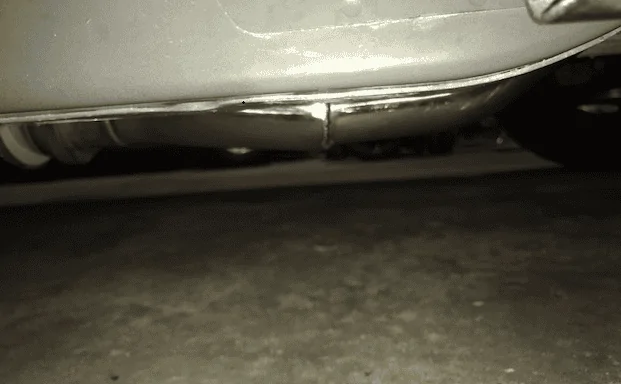

I dont see how i could do anything to pull them higher since my driver side header pipes are almost touching the heat shield already:

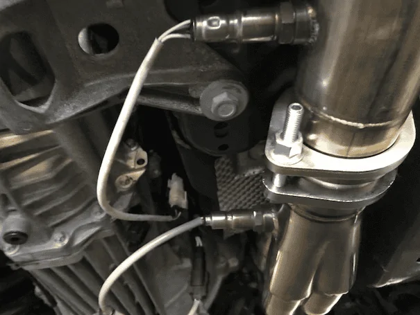

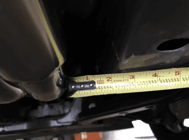

Here are some pics of the passenger-side. I have about 1 1/8th" clearance between the frame and nearest primary tube . Then 2 1/4" at the collector. I took a pic of the o2 sensors too. I have no fitment issues. "HDR78SK-2" label on the Pypes box.

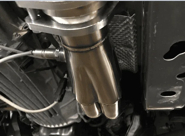

Here is a pic of the collector taken from the passenger-side. Farthest point below frame box is 1/2".

Thanks for the pictures GTBOB! My clearance in the spot where you measured is similar to yours. Its a little higher up the headers, near the engine bay, thats almost touching. You DO have a lot better clearance where the O2 sensors are. Maybe its because i have the catted version.
Mine seem to be hanging just like yours judging by the pictures but i measured a full inch in mine. My car isnt even lowered that much and i cant get a full fist under the pipe and i have small hands. The scariest part is that the part that is exposed is exactly where the weld is.

[MENTION=10926]beefcake[/MENTION] do you know if a muffler shop could maybe heat up the pipe and bend it a little inwards? Some types of stainless steel crack others bend.
My pipe is just waiting to get ripped by a speed bump!
