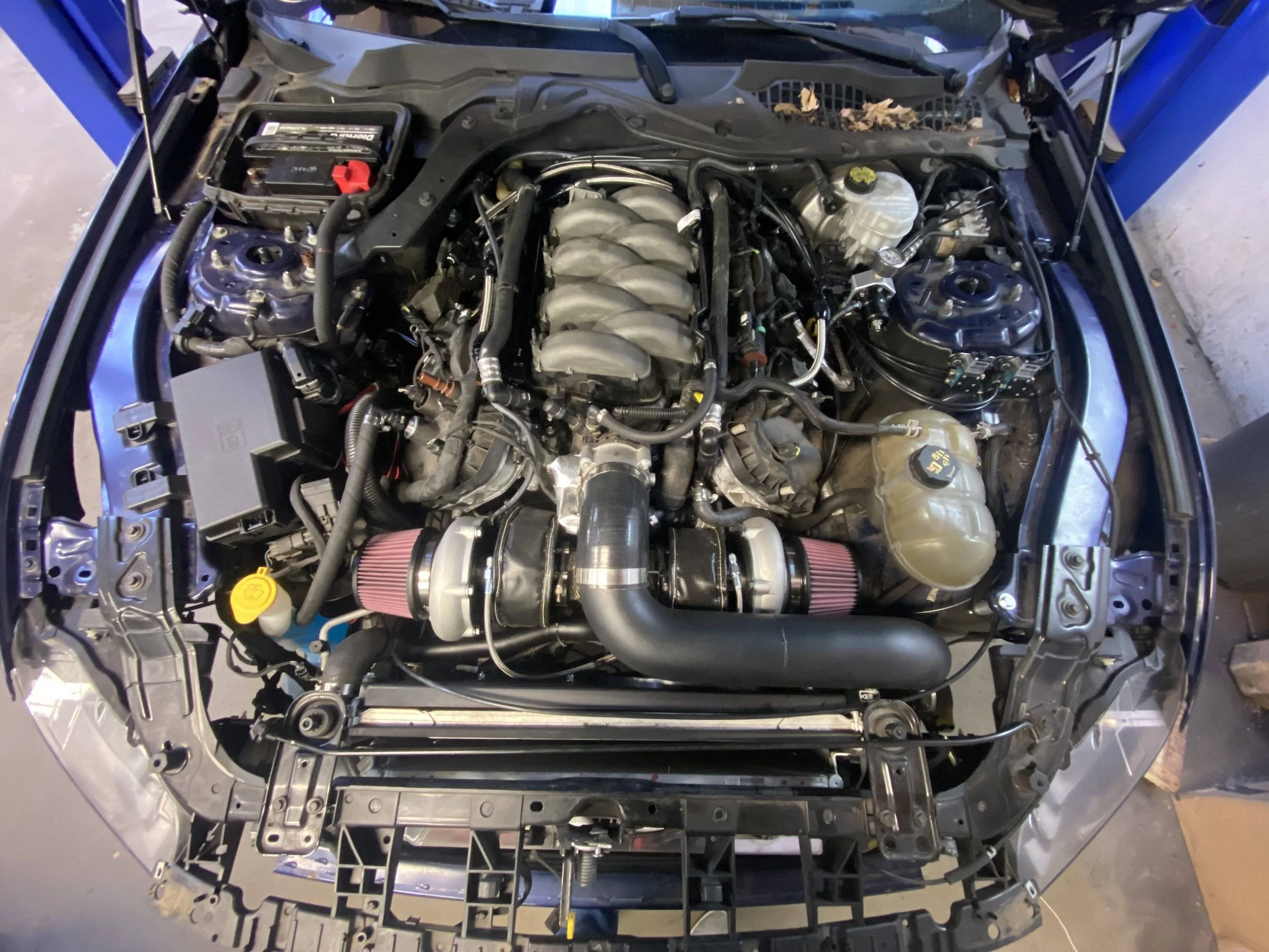

I recently installed Hellion TT top mount kit on my 18 Mustang (Manual). The car was pulling knock sensor for timing on both e85 and 93 fuel, so I'm pretty sure its a false knock somewhere but I can't figure out what is causing it. My shop went through the installation and piping multiple times but they couldn't find what was triggering the false knock. Do you guys think I should go ahead and get me a BMR k-member and see if that would eliminate the false knock ? many people mentioned that the stock one could be causing it. Anyone here had similar issue and an aftermarket K-member solved it ?

I'm really lost, my shop went over the installation multiple times and couldn't find the issue. we ran both 93 and e85 and still getting the knock. which make you think its false knock. Someone in some FB group, said that he fought the knock for a long time and didnt go away till he replaced his K-member. Trust me if I can avoid it, I would. I'm just trying to do anything possible to eliminate that stupid knock. I don't want to desensitize them yet, but its a possibility down on the road.
i remember on the older cobras once they started making big power knock sensors got deleted because they would do the same thing. i guess if overboost is accounted for and the onboard widebands are GTG you should be fine, i'd hate to ditch a knock sensor unless i had to with such an expensive build.

I have the steeda drag racing k member, which I installed myself, and it was perfect. So much more room to work around the low mount turbos. But, I'm not sure and would be highly suspicious on how the stock subframe would contribute to knock.
