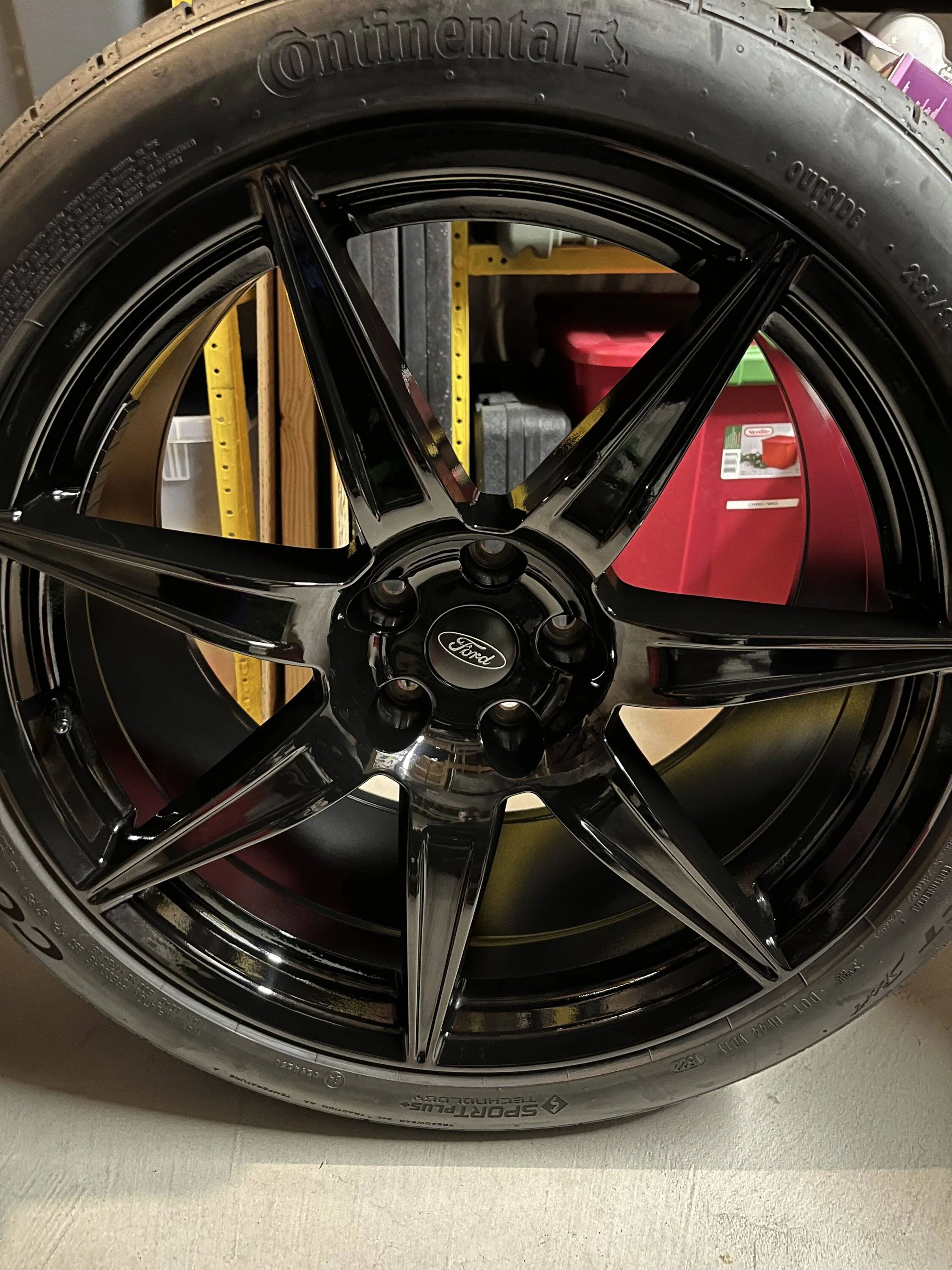

I bought the FP center caps for my SVE wheels and they fit perfectly. So the FP caps should fit your 6GR’s assuming they do indeed accept the OEM caps
Nice, I’m sure they’re the same. I’m thinking with the bronze wheels that I’ll either go with those caps that you bought or ones with a blacked out pony.

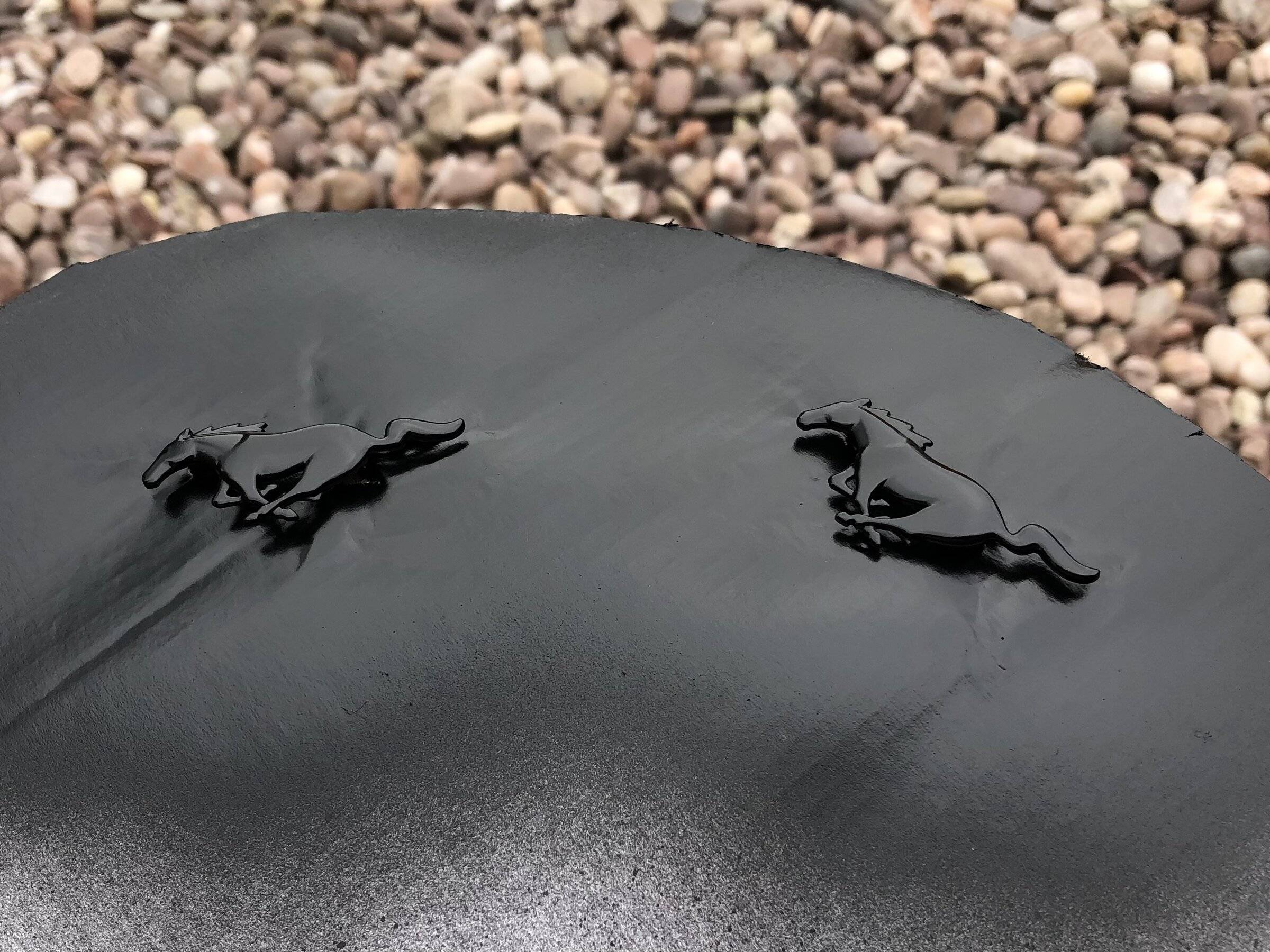

I had taken the chrome pony’s out of the rear wheel caps when the rear wheels were off. I scuffed them up with a 3M pad, cleaned them with thinners and then added two coats of etch primer and two coats of satin black :
I will let them cure on the window sill for a few days and then pop them back in, they should compliment the blacked out wheels nicely :like:

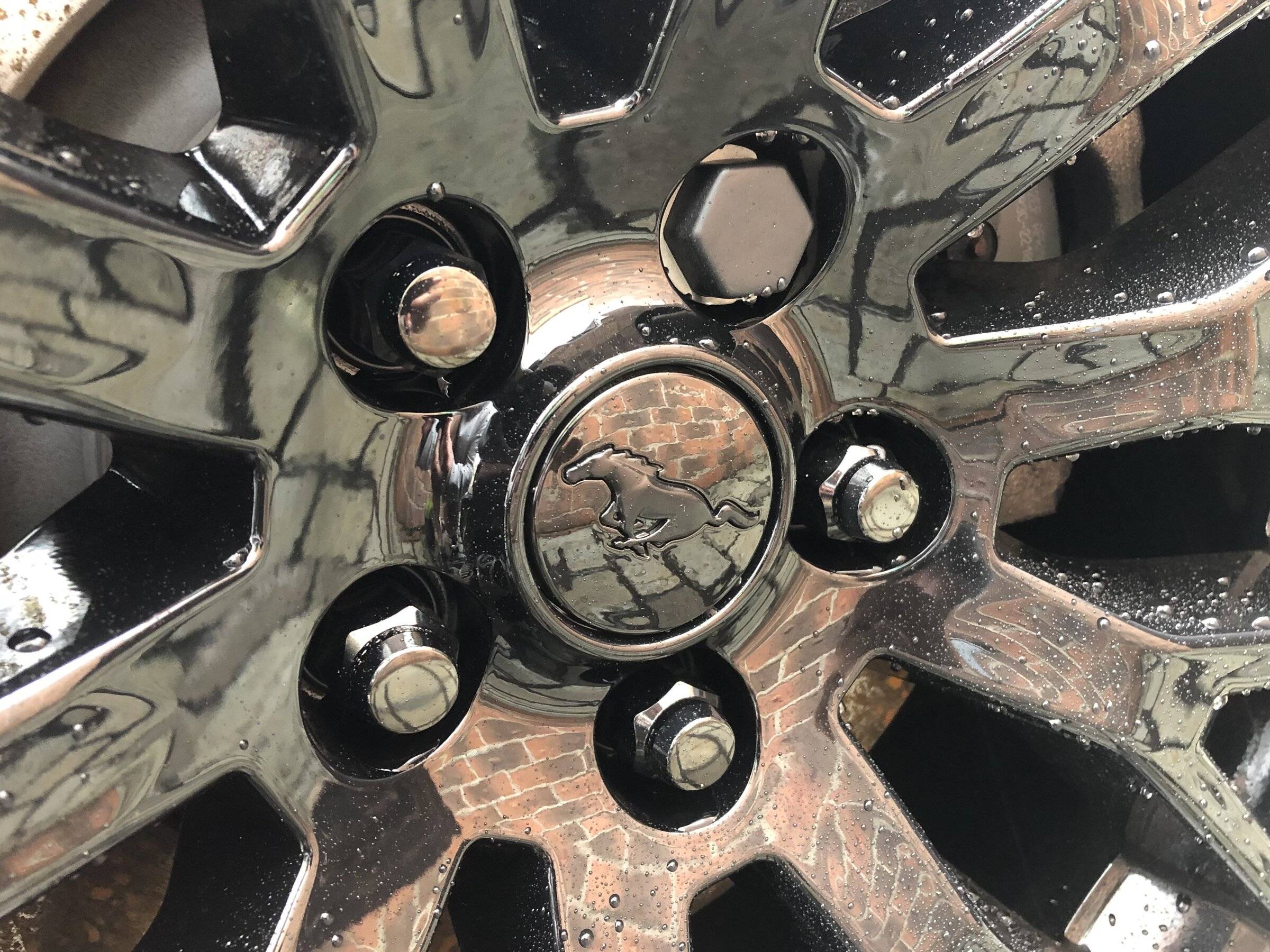

I de-chromed mine :
I popped the caps out when the wheels were off, scuffed the ponies up with a wire brush and 3M pad, degreased, then etch primed them before the top coat :like:
WD :like:
They have been on for two years now, I regularly hit them with the power wash and wheel cleaner, and they still look like the day I did them :like:
Hope that helps ?

Absolutely, thank you!
