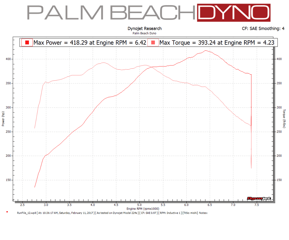

Forgot to share this!
-Mishi Tube
-K&N Panel Filter
-Pypes Touring Mufflers
-Palm Beach Dyno E85 Tune

It actually made 430 uncorrected.
Its a runner for sure!

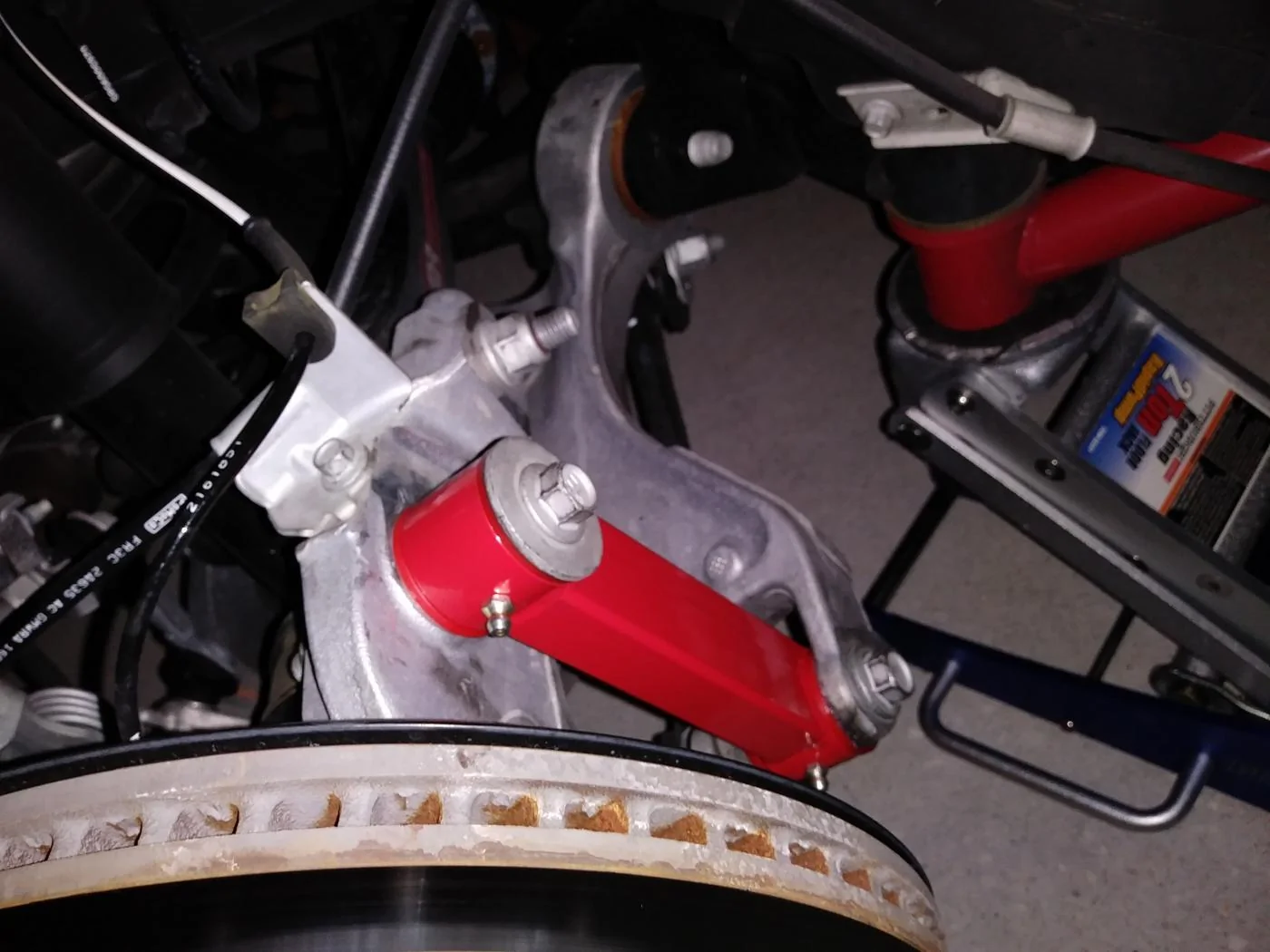

Testing these "econo" Poly Vertical Links out for a while.
If all goes as planned, these should be a homerun.
I put a little over 5,000 miles of SERIOUS abuse on the Super Pro Links - a quick review will come soon. Great parts!

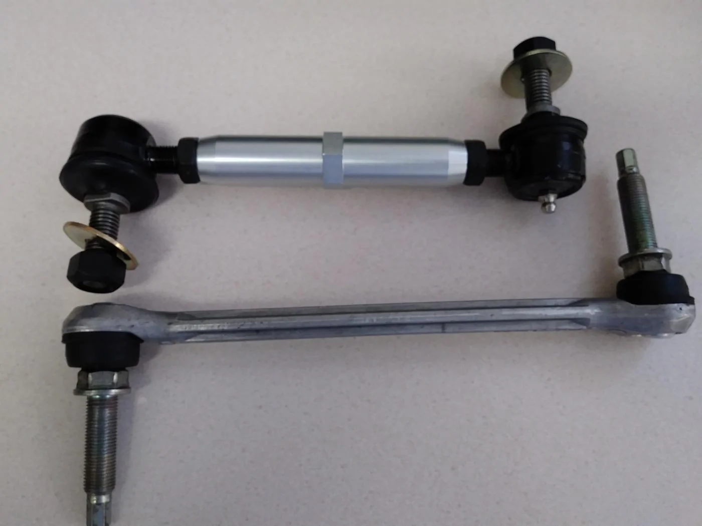

Also forgot to add. My custom valved Viking Double Adjustable Front Coilovers are in.
I am going to use the following combo.
Viking DA Front Struts (AK valving)
300lb/in Coilover Springs
BMR Custom End Links (pictured)
Stock Front Sway Bar (PP)Rear BMR SP085 980lb/in SpringsViking B358AM Rear Shocks
Stock Rear Sway Bar
BMR ELK014 Rear Bar End Links
Once I get this set up tested - I will move onto sway bars based on what I feel the car needs.
We have a SUPER BADASS new front sway bar coming....and also a revised front sway bar mounting system - so I will likely be showing those off soon. I am thinking thr 35mm front and 25mm rear will be the ticket. But we shall see.

Kelly, I really like those custom end links. Can you tell me the length from mounting stud to mounting stud in its shortest form? I have switched to Airlift which comes with their shorter end links but I'm not a fan and I would like to change them out.
BMR Tech
BMR Tech
Sep 4, 2014
168
5,141
3,711
Tampa, FL
www.bmrsuspension.com
Dion
2018 GT, 2010 GT500, 2019 F-150 5.0
Theyre 7.5" as pictured.
Should shorten up to approx 6.5"
