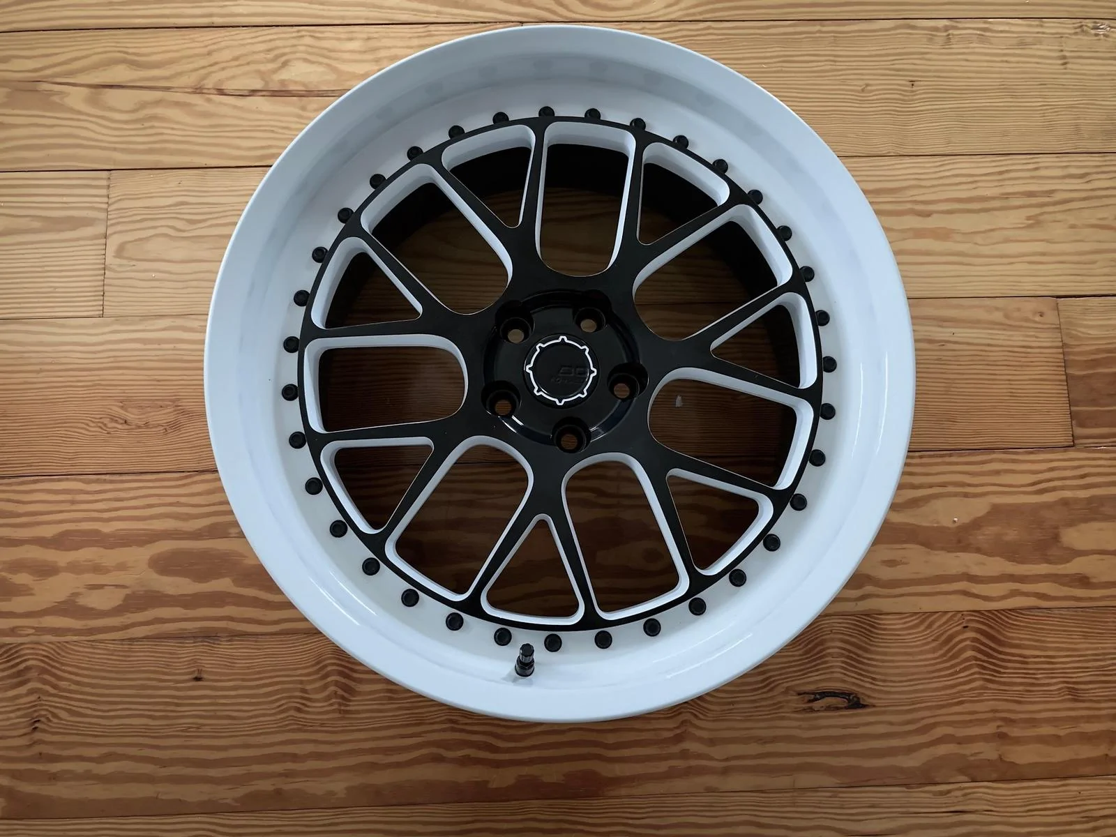

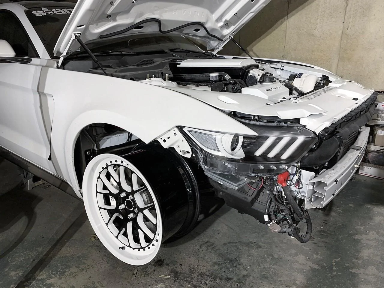

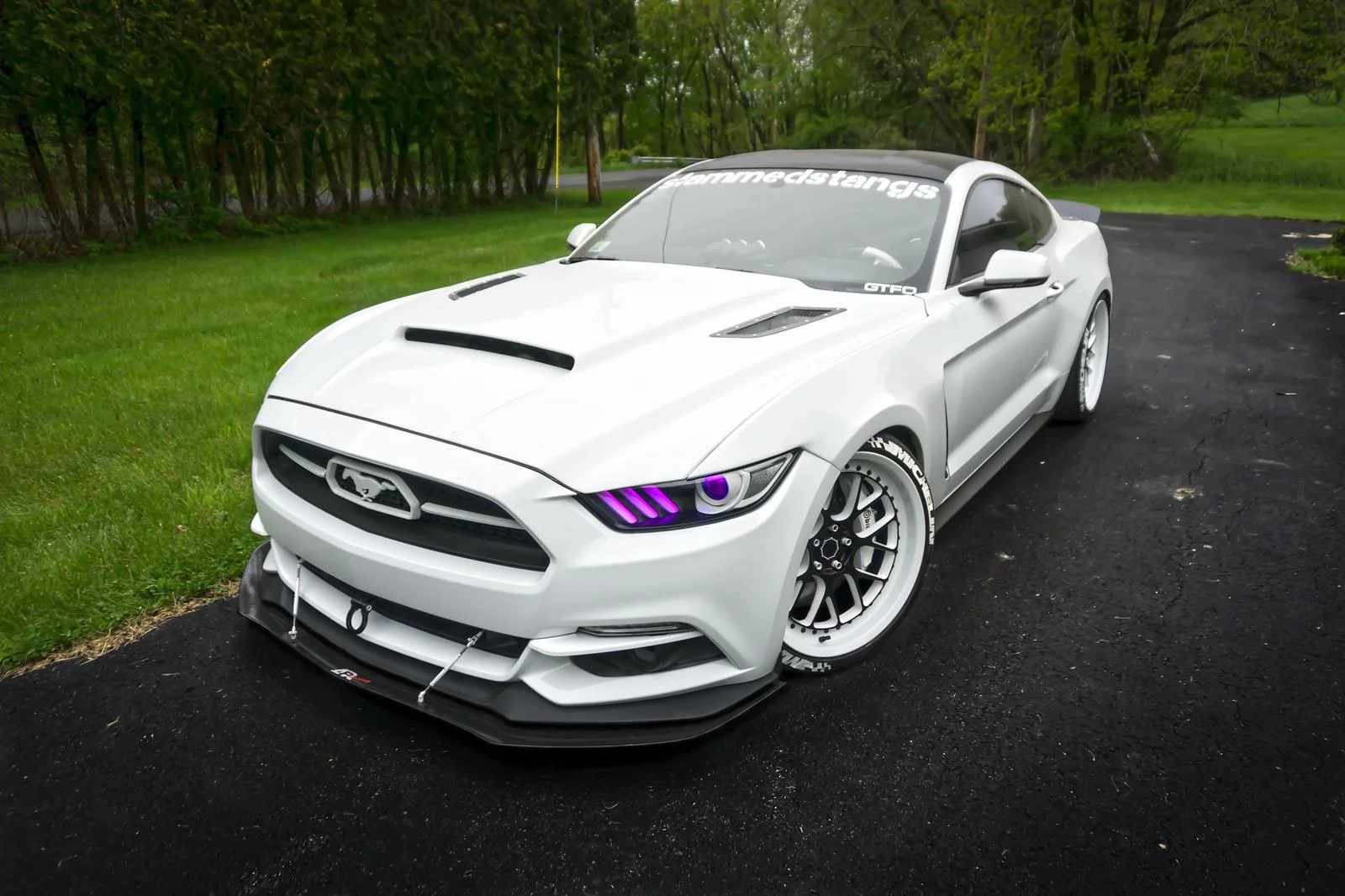

Wheels are done. Took longer than I wanted... but they're done.

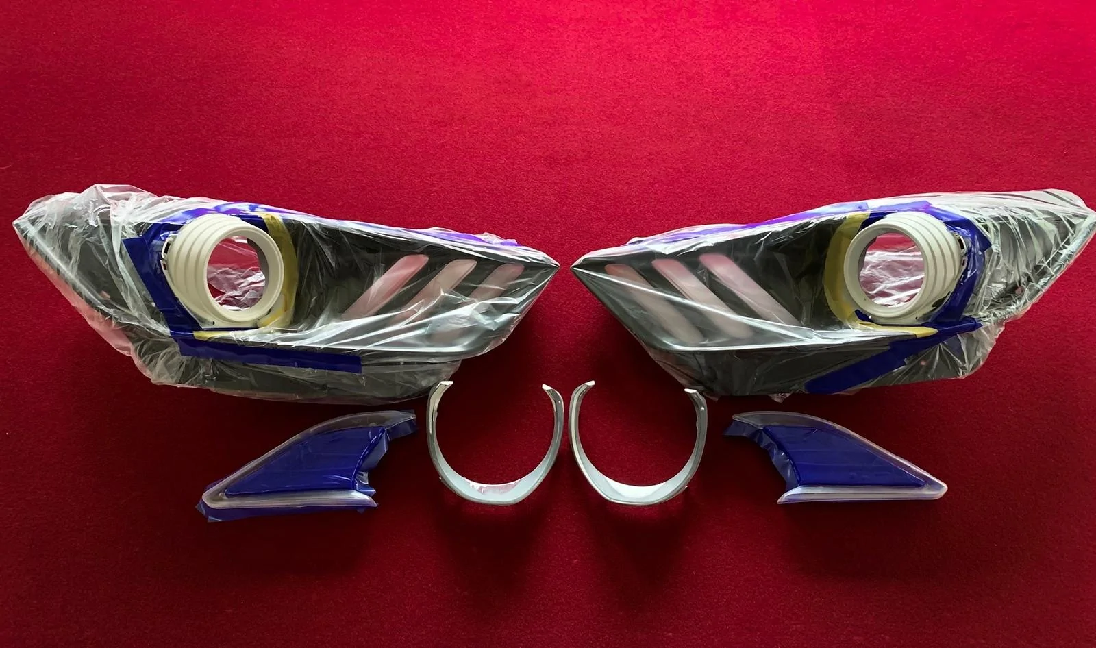

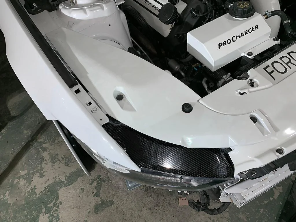

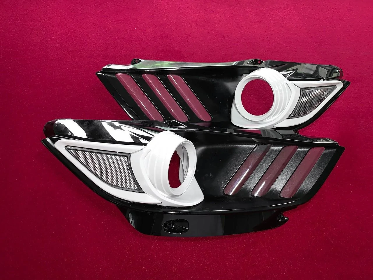

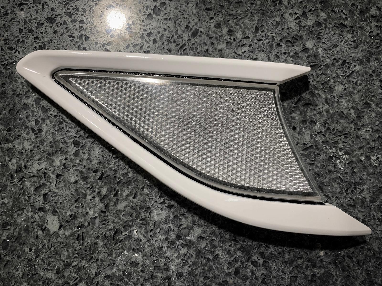

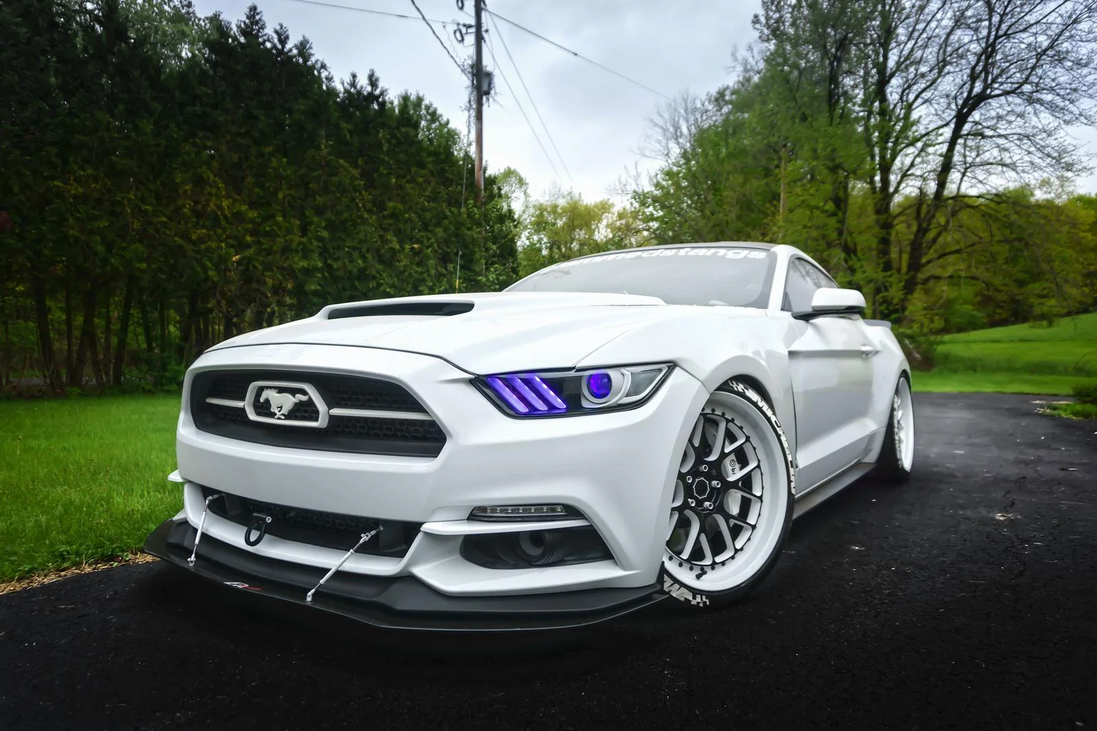

Also went ahead and tore down the headlights so I could swap out the side markers for clear "Euro" styled ones to tie in with the rest of the lighting. Took the opportunity to repaint everything, too. Went ahead and threw some carbon fiber vinyl I had laying around on the top to keep the light from bleeding through the gap between the hood and fenders.
Between the headlights and the wheels, the front-end already looks much better.

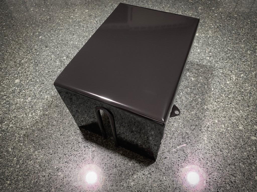

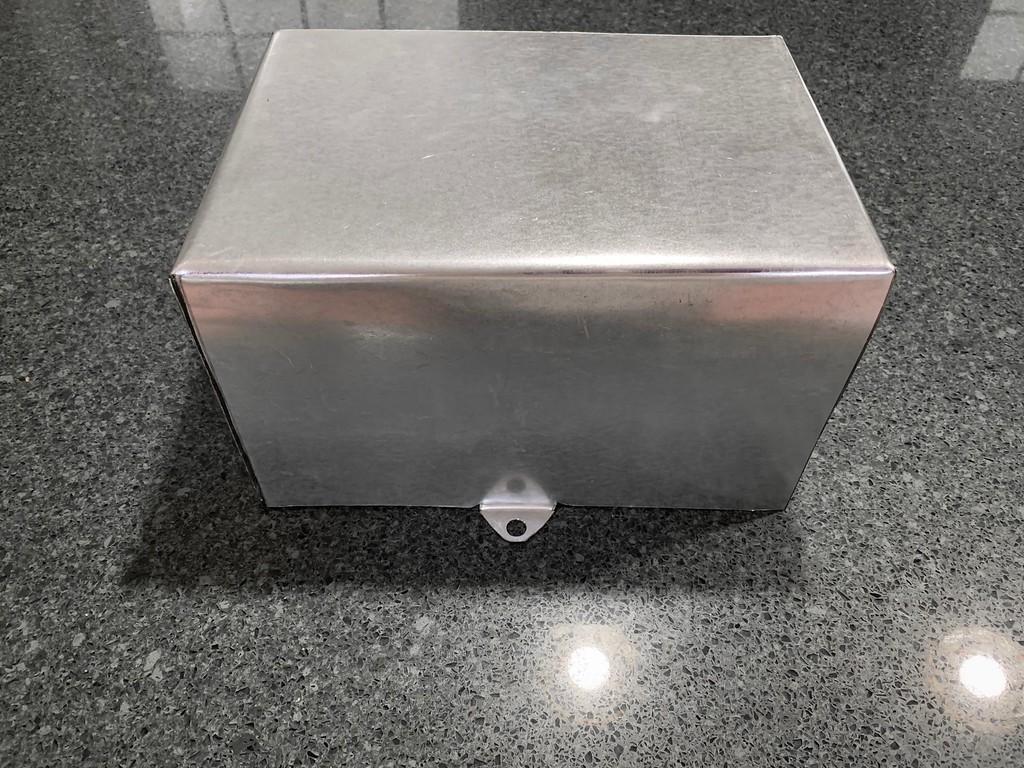

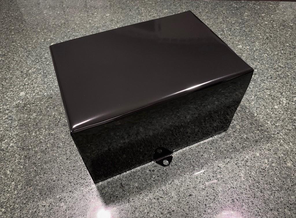

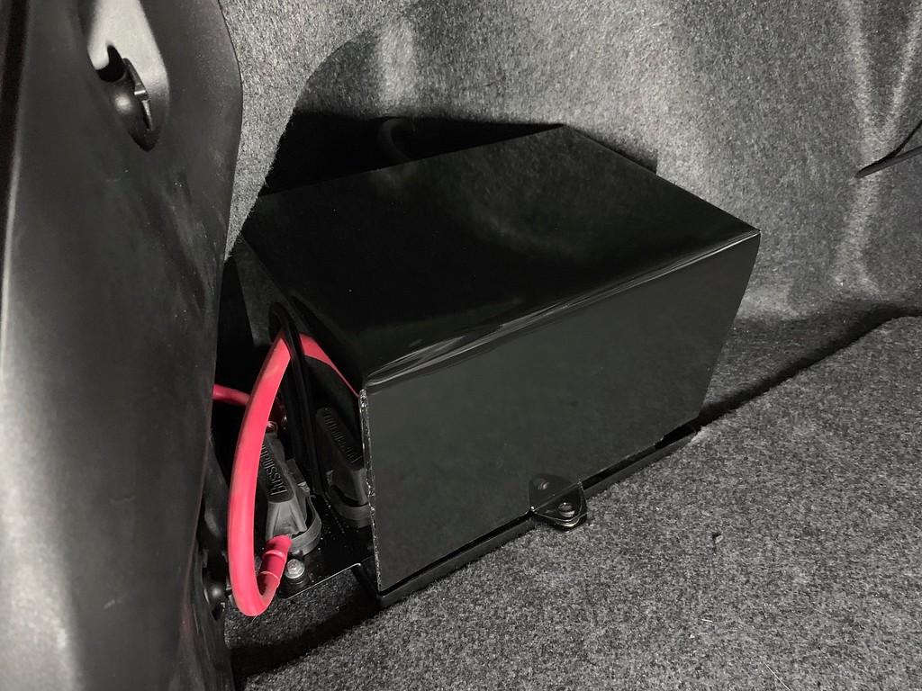

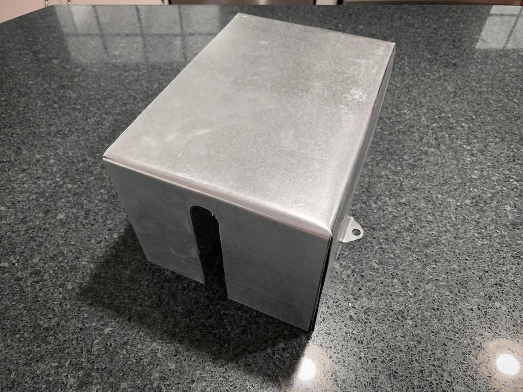

Moving back to the trunk... one thing that bothered me was that the Watson Racing battery kit did not come with a cover. Even with a Lithium battery, it looks unsightly. Grabbed some aluminum and quick bent up a cover.
Just sitting in place, but you get the idea

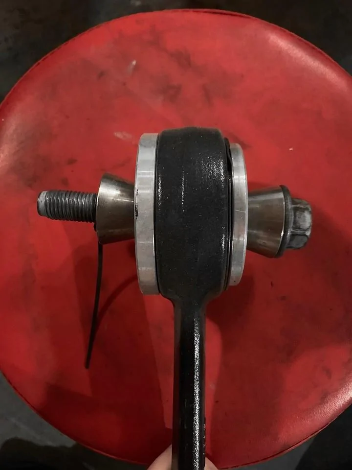

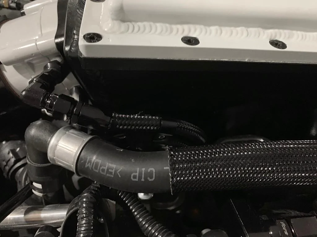

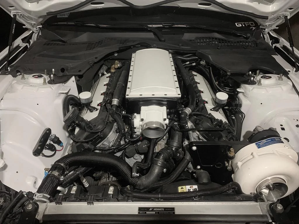

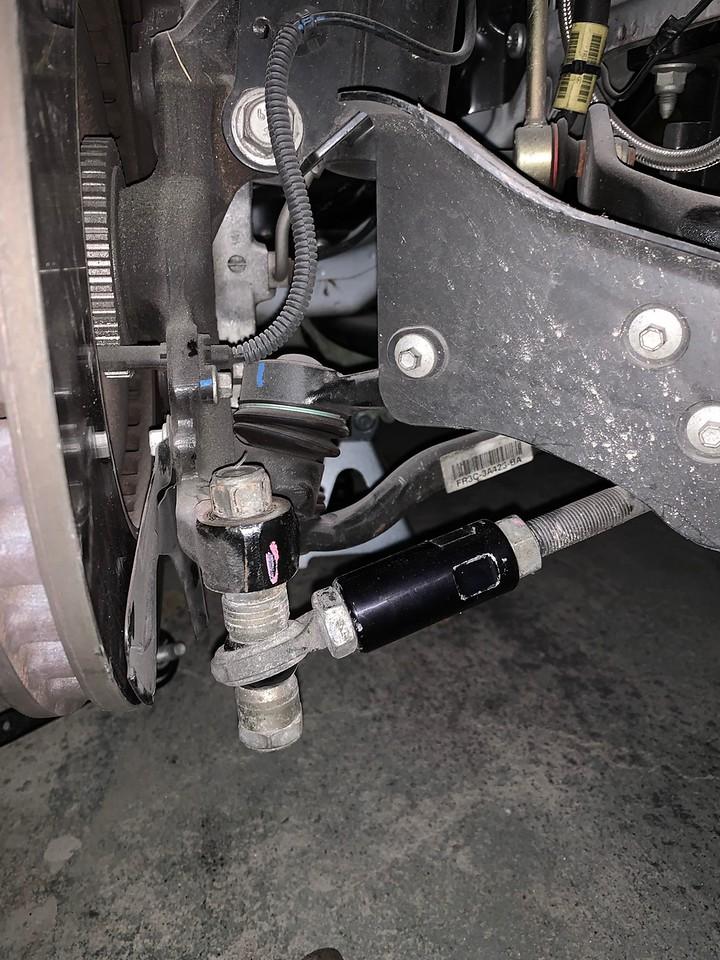

Jumping back up to the front, I swapped out the methanol lines for some a bit longer. Ran them through the intake valley, so they're tucked away and clean. Also swapped the radiator over to Mishimoto's larger 3 core. So hopefully we'll see some real cool temps. Rounded out the front suspension with some spherical bushings for the control arms as well as a bump-steer kit.

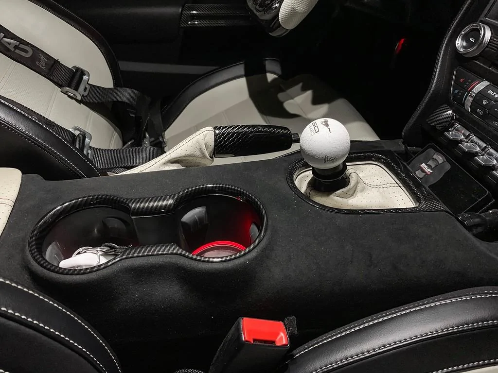

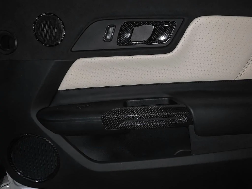

Finally made my way back to the interior to take care of a few more small details. Swapped out the start button cover for a "carbon fiber" version. Wish I could have found a real carbon piece, but this will do just fine. Also added a carbon trim ring on the cupholder, as well as the upper and lower speakers.

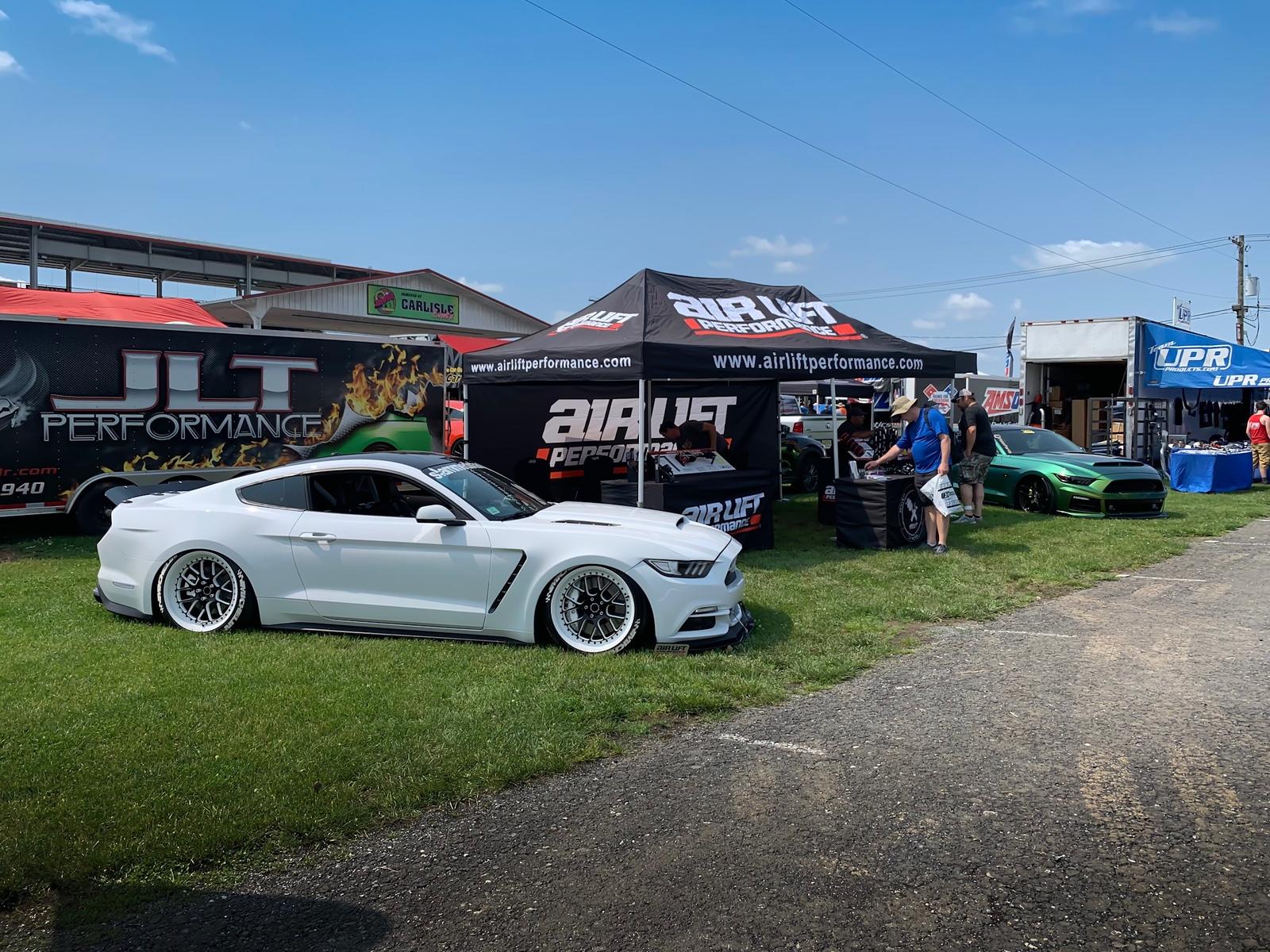

Got the car back from Bill just in time to load up and head out to Ford Nationals. Car is running great (first time in a long time). We had to dial it back a bit, but it still hauls. Didn't have enough injector for E85 and the 4.38 pulley, and Bill doesn't trust that much psi on a bone stock block- he's probably right. I didn't have time to order a different pulley, so just went back to the 4.88 for now. More than likely just keep it on this pulley until a built motor goes in. Anyway, dyno video:
And a couple of pics from Ford Nats!

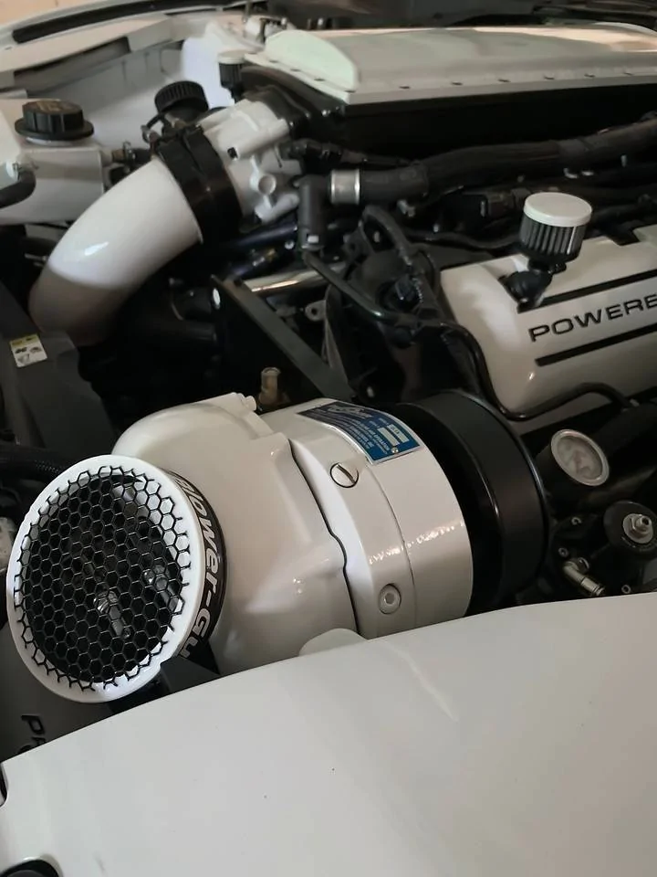

Where did you pick up your breathers by chance?
I got them from here. Thought it was the best looking and most functional breather option. So far they've been great

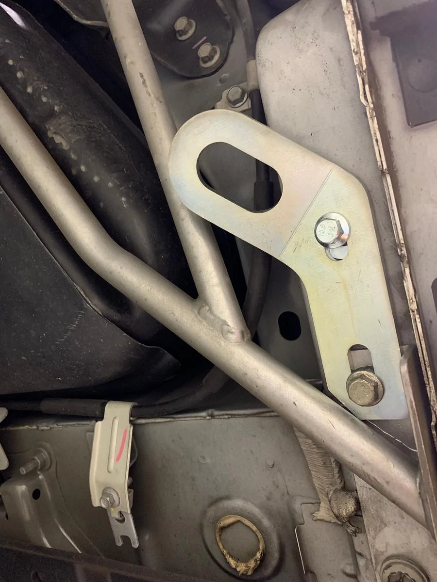

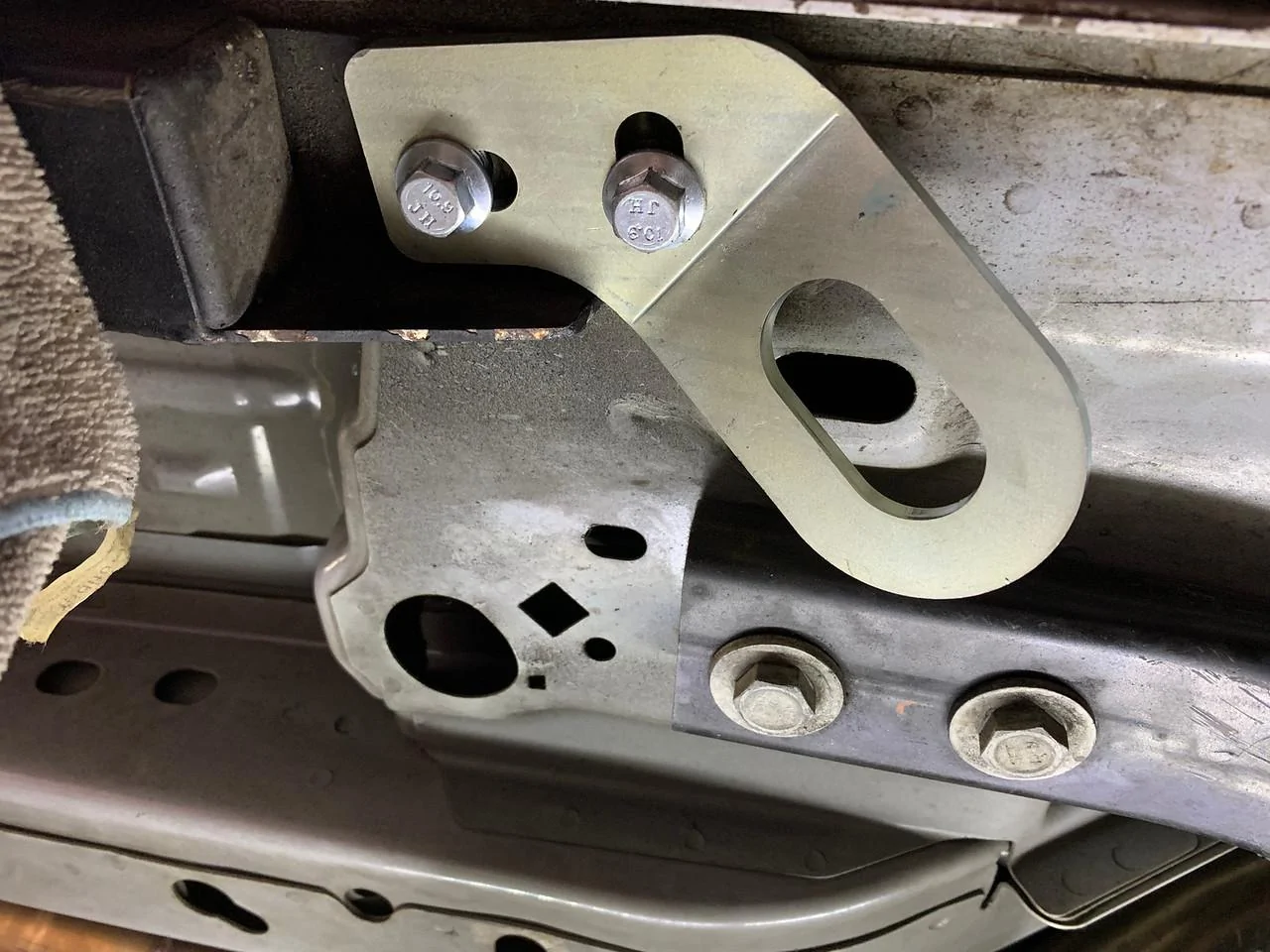

Got tired of my previous method for securing the car onto the trailer. Time consuming and total pain in the ass.
Ordered Ford Performance's tie down kit and decided to figure out a way to make it work with jacking rails. Got them, took a good look at everything and realized this was probably the easiest task I'd given myself on this car in a long time. If anyone was wondering if the two could work together, the answer is yes. Unless you've got full length rails... then you've got a totally different puzzle to figure out.
Trimmed the back corner on the rear tie down and placed a small shim (roughly 3mm thick, I believe) and that was it.
Notched the ear on the jacking rail and the front was in. I really should have done this sooner.

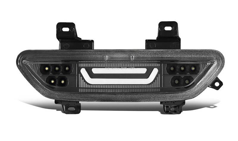

Happened to find a replacement reverse light that I thought would complement the Euro tails. Really like the frosted housing and the fact that it operates as a "4th brake light" and not just a parking light like most aftermarket options. I did find one small problem after I installed it, though. The light simply uses one wire to tie into brake lights. Doing it this way means that when the single tri-bar (whatever one was tapped into) is illuminated, the new brake light comes on. That's all well and good until you turn on your directional and it flashes out of sync with one side and not at all with the other.
Our tails use a single power wire to each tri-bar. So, when you hit the brakes they all get power. Directionals stagger power to each bar. Decided to make a small harness that would tie into both tail assemblies and allow the light to blink with both sides, but that wouldn't allow for any power feedback between the two sides.

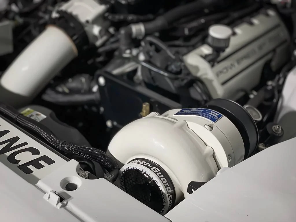

Also got my new Blower-Guard on. I don't know if it actually makes a power difference. Would like to make some pulls on the dyno to compare it to the upgraded ProCharger inlet pipe. Either way, it looks a lot cleaner!

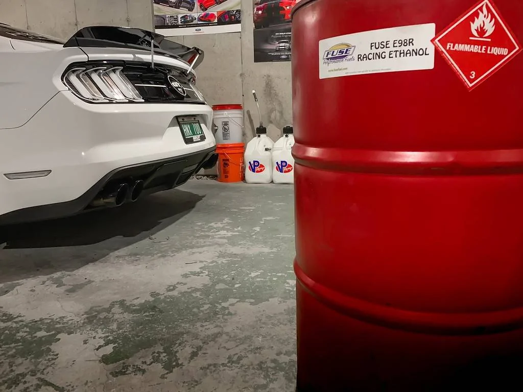

Speaking of power, I went ahead and picked up a couple of drums of Fuse E98. Should hold me over for a while.

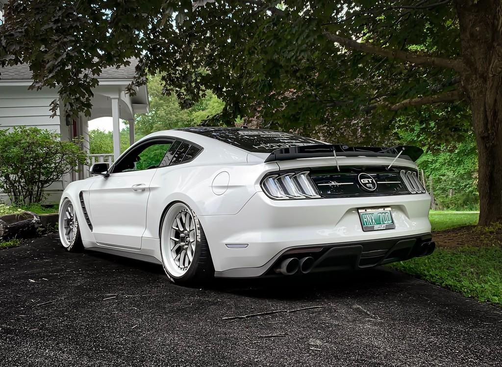

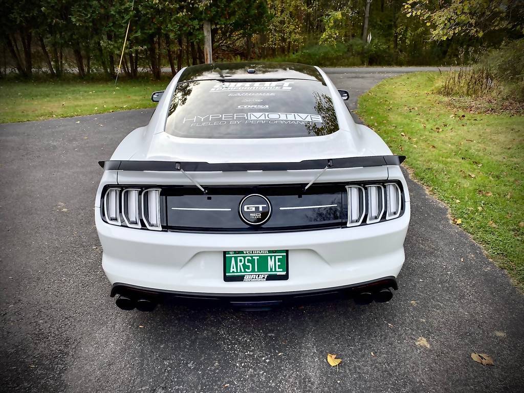

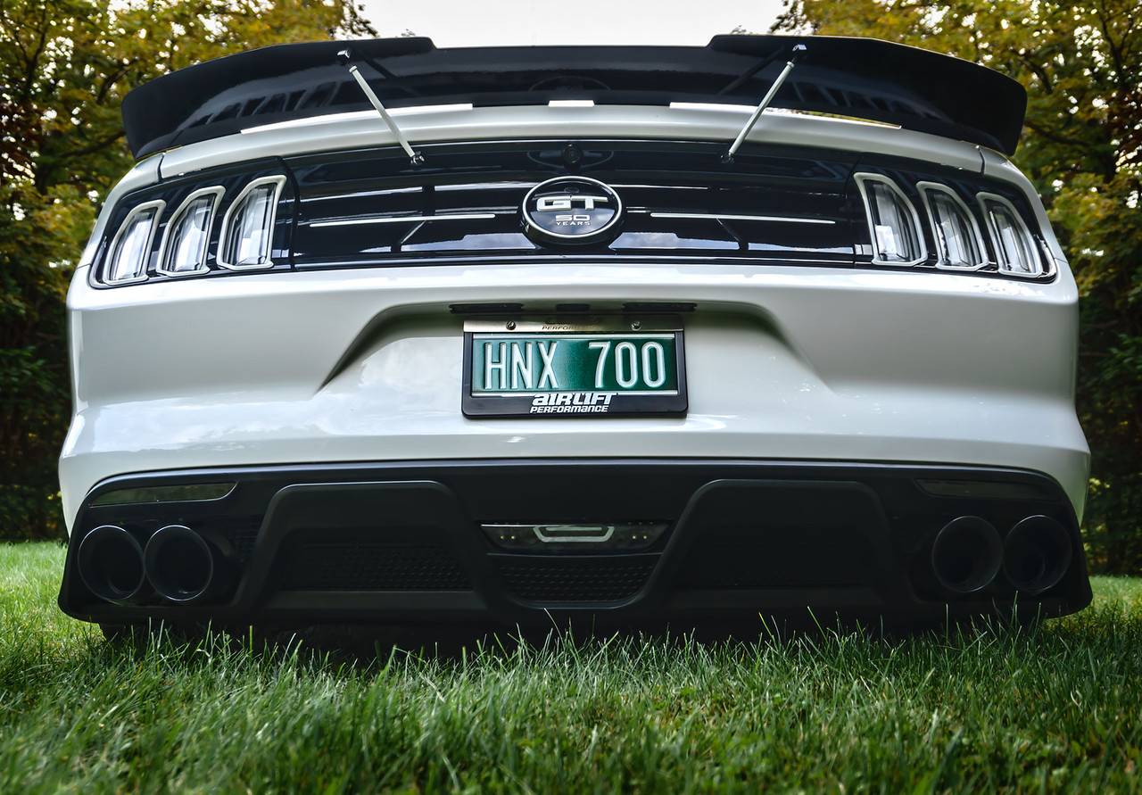

But, the most important piece came in last week. My new plates!
