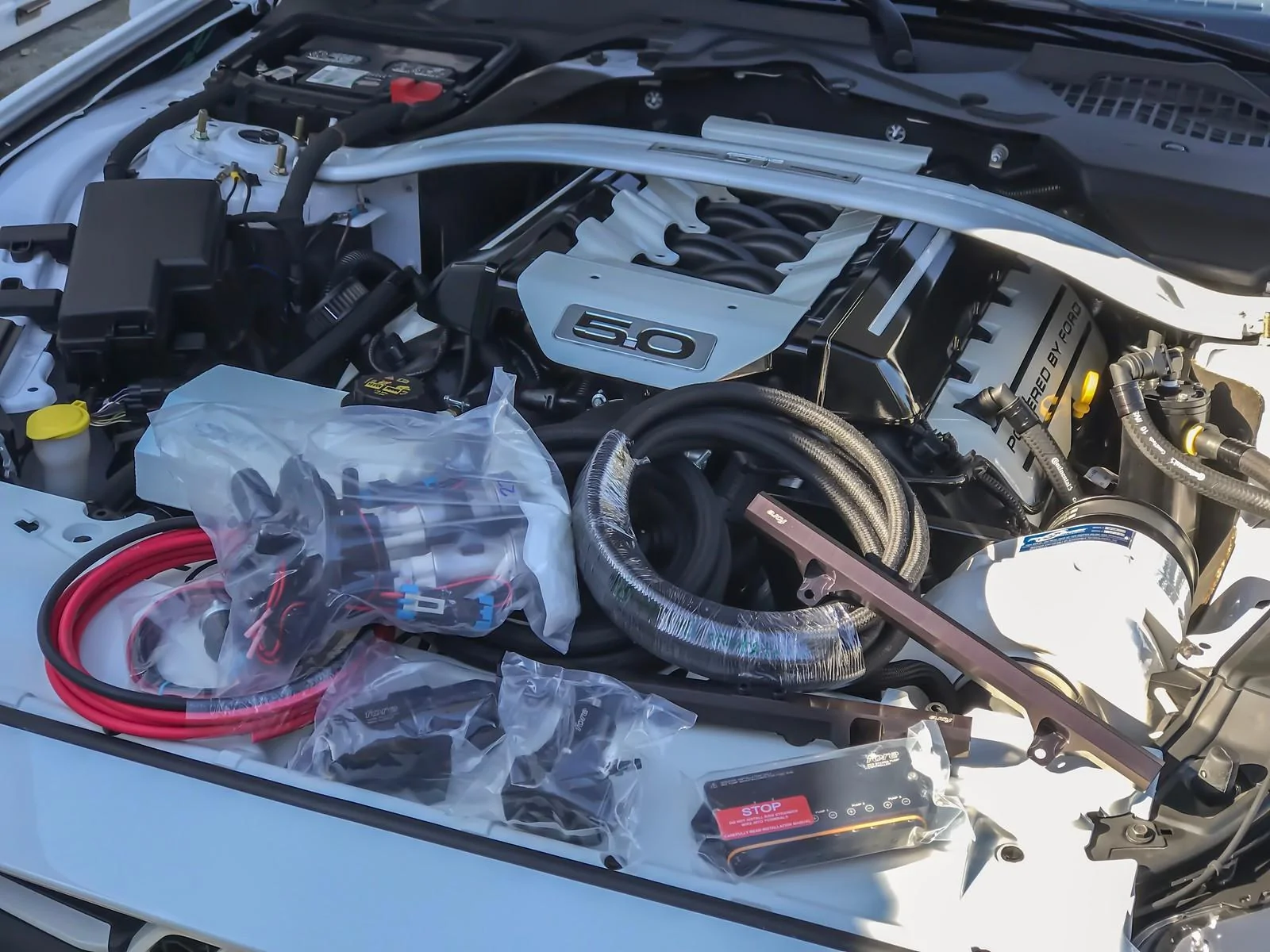

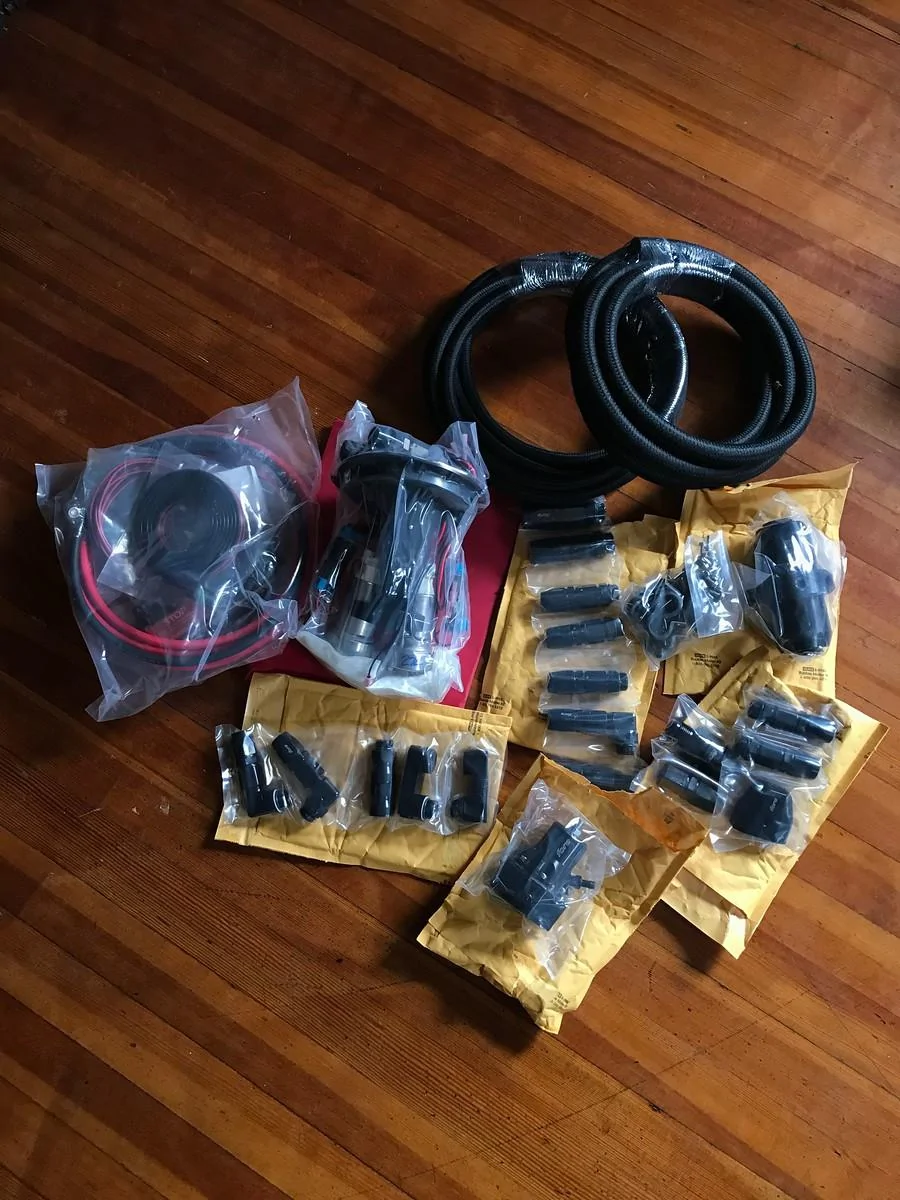

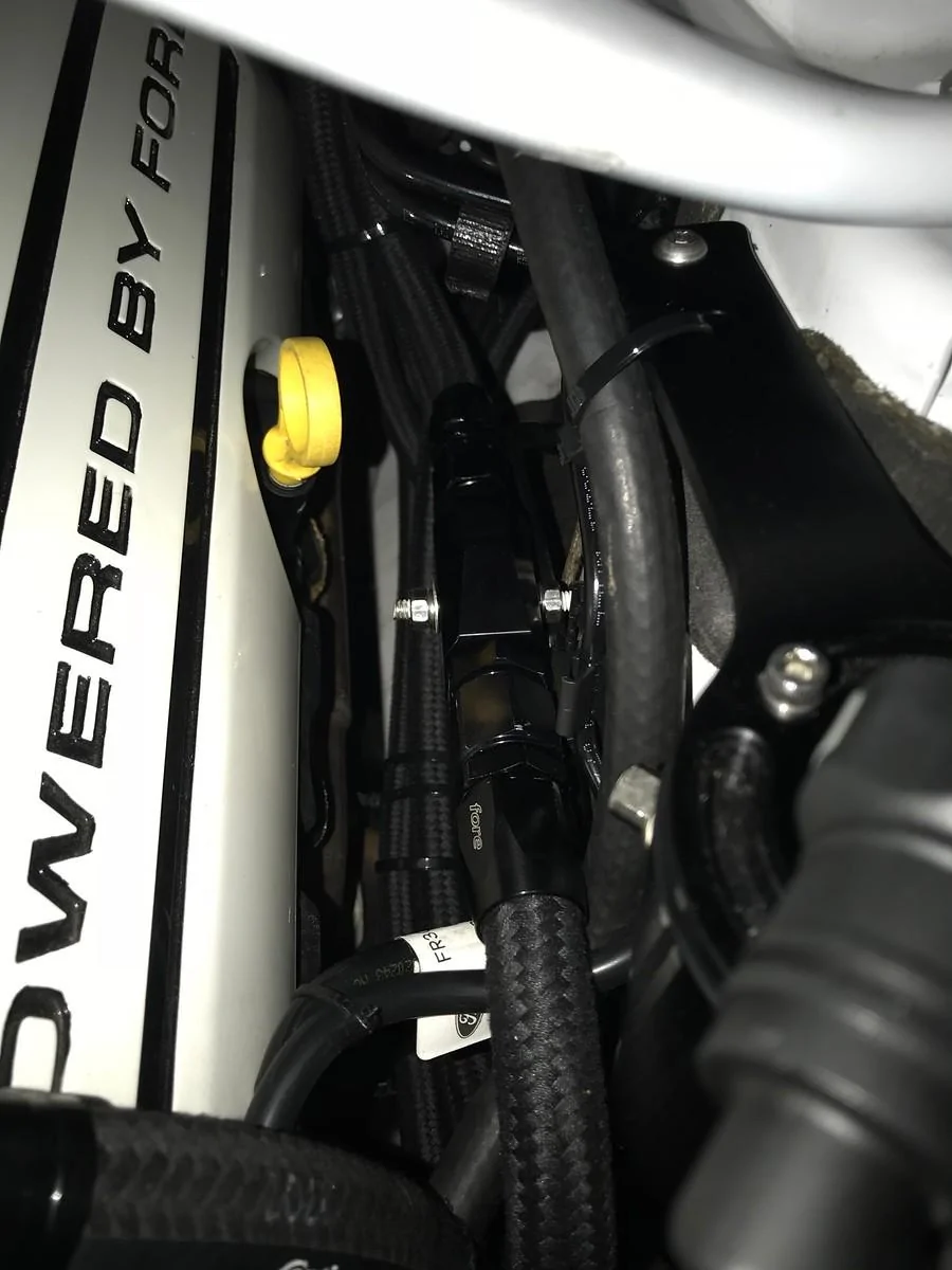

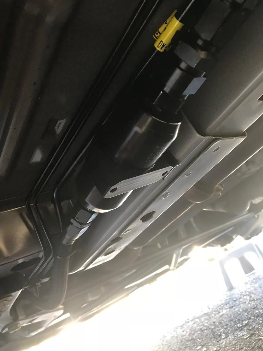

Fuel system is in :headbang:
Fore stage 4 kit with dual TI274. Paired the pumps with the FC3 controller, F2i reg and -10/-8 Starlite lines. Huge thanks to [MENTION=9610]jayman33[/MENTION] for the setup!
Going to try to get some revisions done this week and then finally hit the dyno on Monday

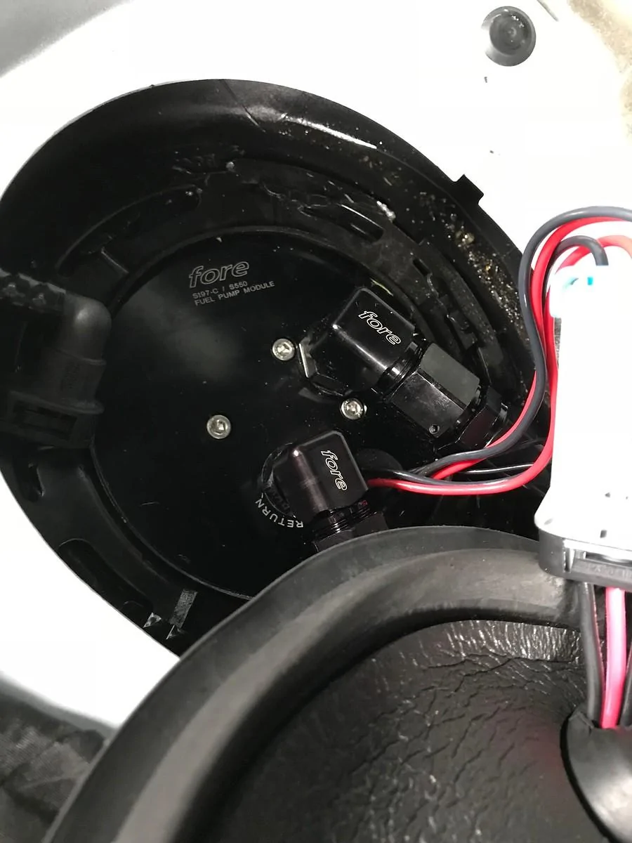

Fuel pump
Inline filter and check valve mocked up before final mounting

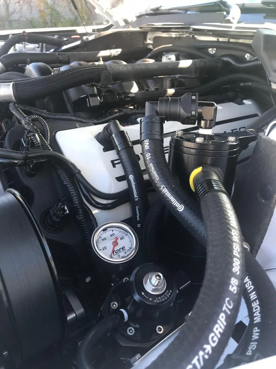

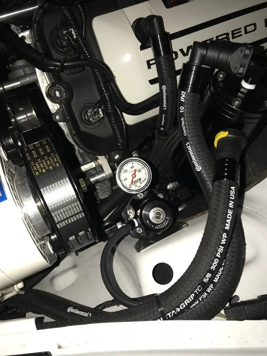

Regulator mounted/ fuel rails. Run parallel post-regulated
Regulator clearance between catch-can and pulley

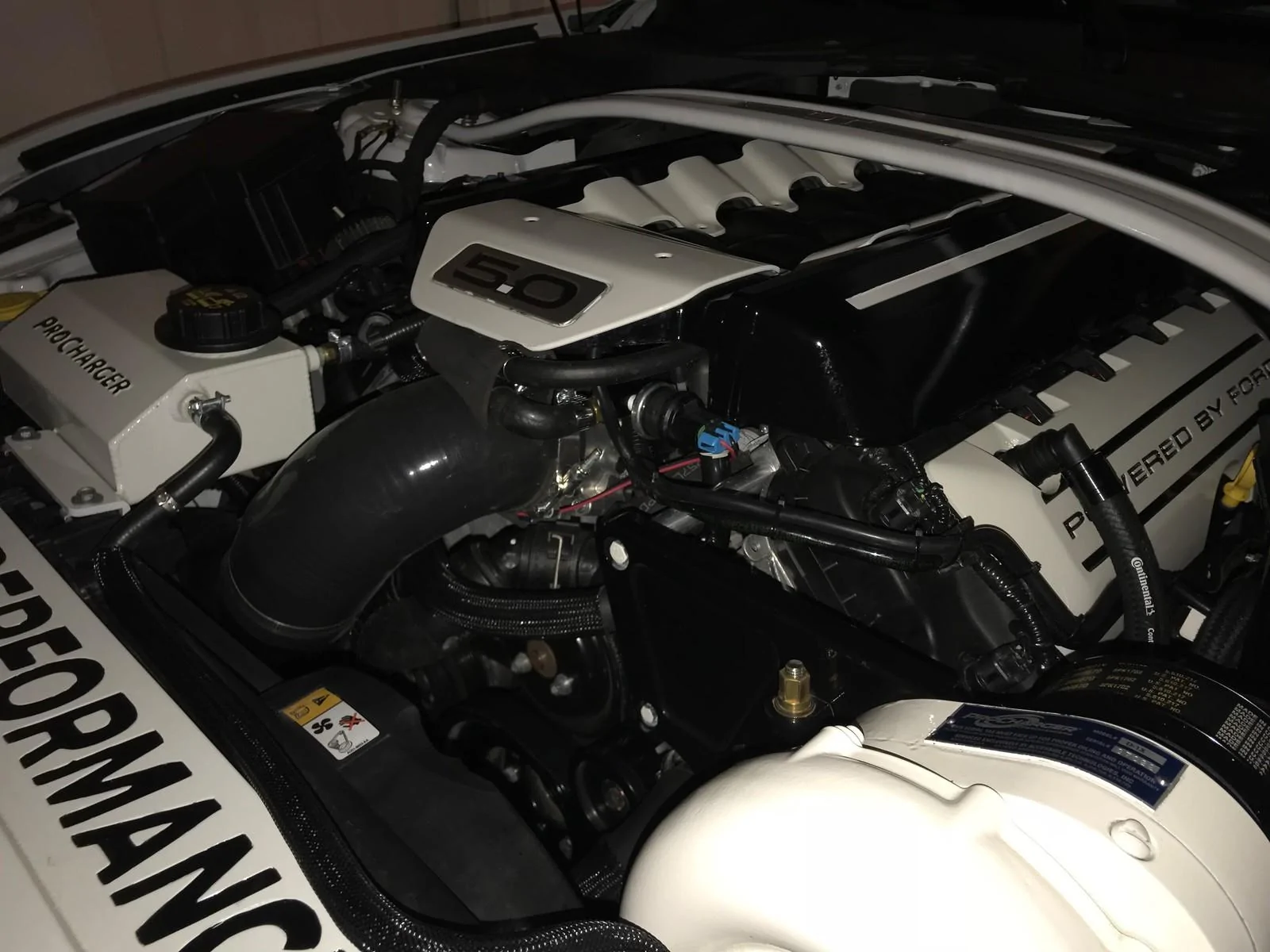

Relocated ProCharger's boost block and mounted the hobbs switch
Y-block tucked away on strut tower

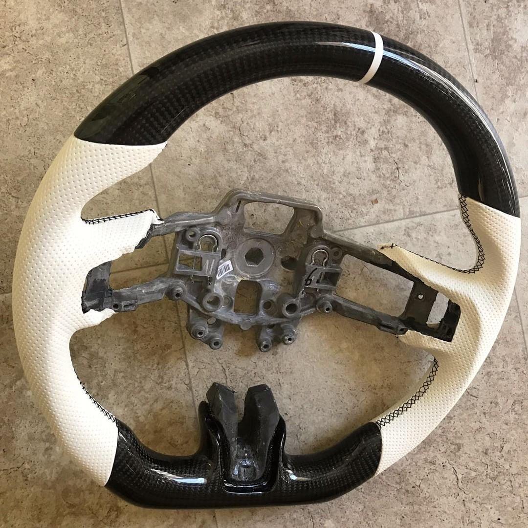

Picked up a little something from [MENTION=25687]Beith Performance Parts[/MENTION]
Should complement the rest of the interior perfectly
