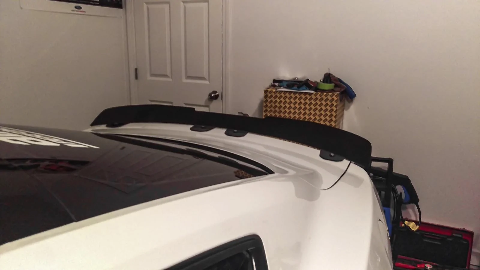

Spoiler is ordered. Made a last minute change in decision- think it's going to be a perfect balance between matching the theme and functionality.

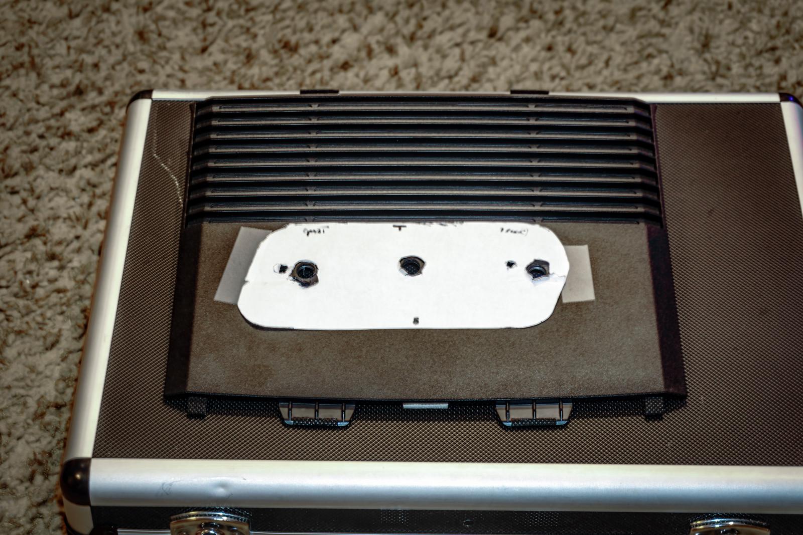

Until that gets here, I have a different project to keep myself busy. Bit of preparation for things to come. Or, I may just be putting the cart in front of the horse :lol:

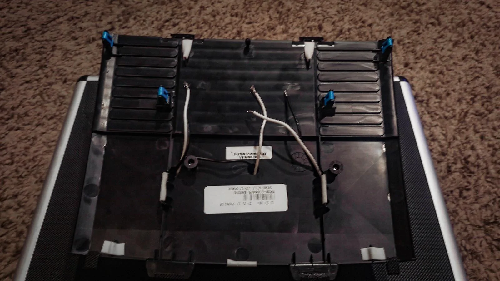

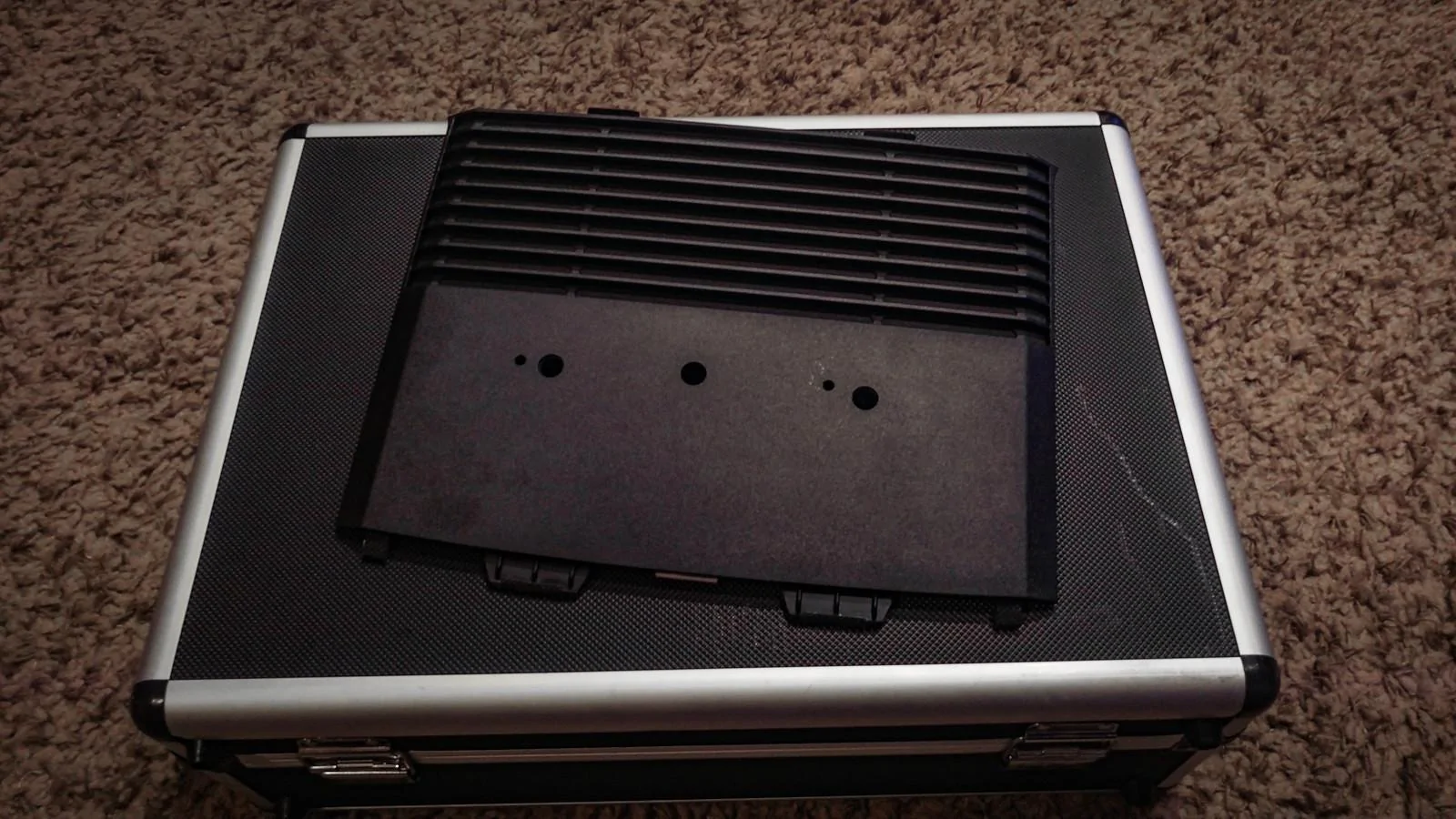

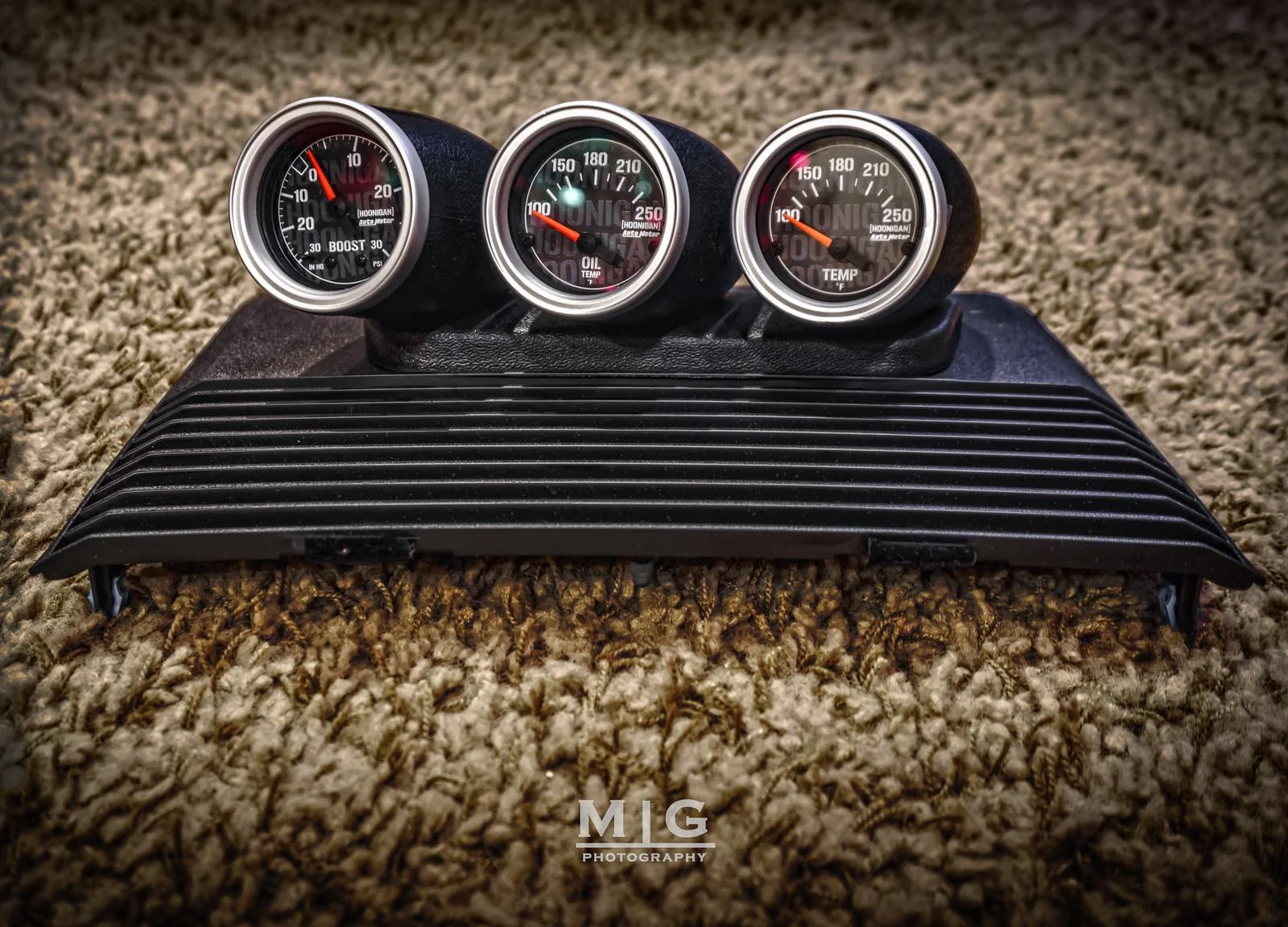

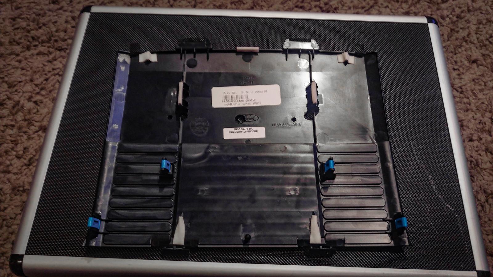

Started with an extra dash speaker grille from [MENTION=9199]LevittownFordParts[/MENTION]. Made a quick template and got to drilling some holes.

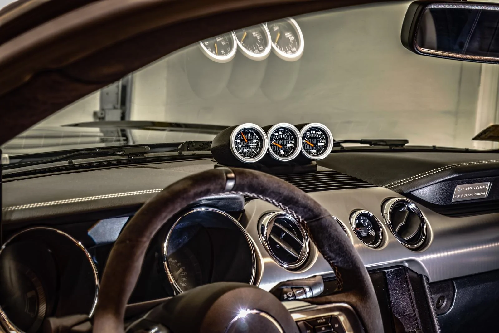

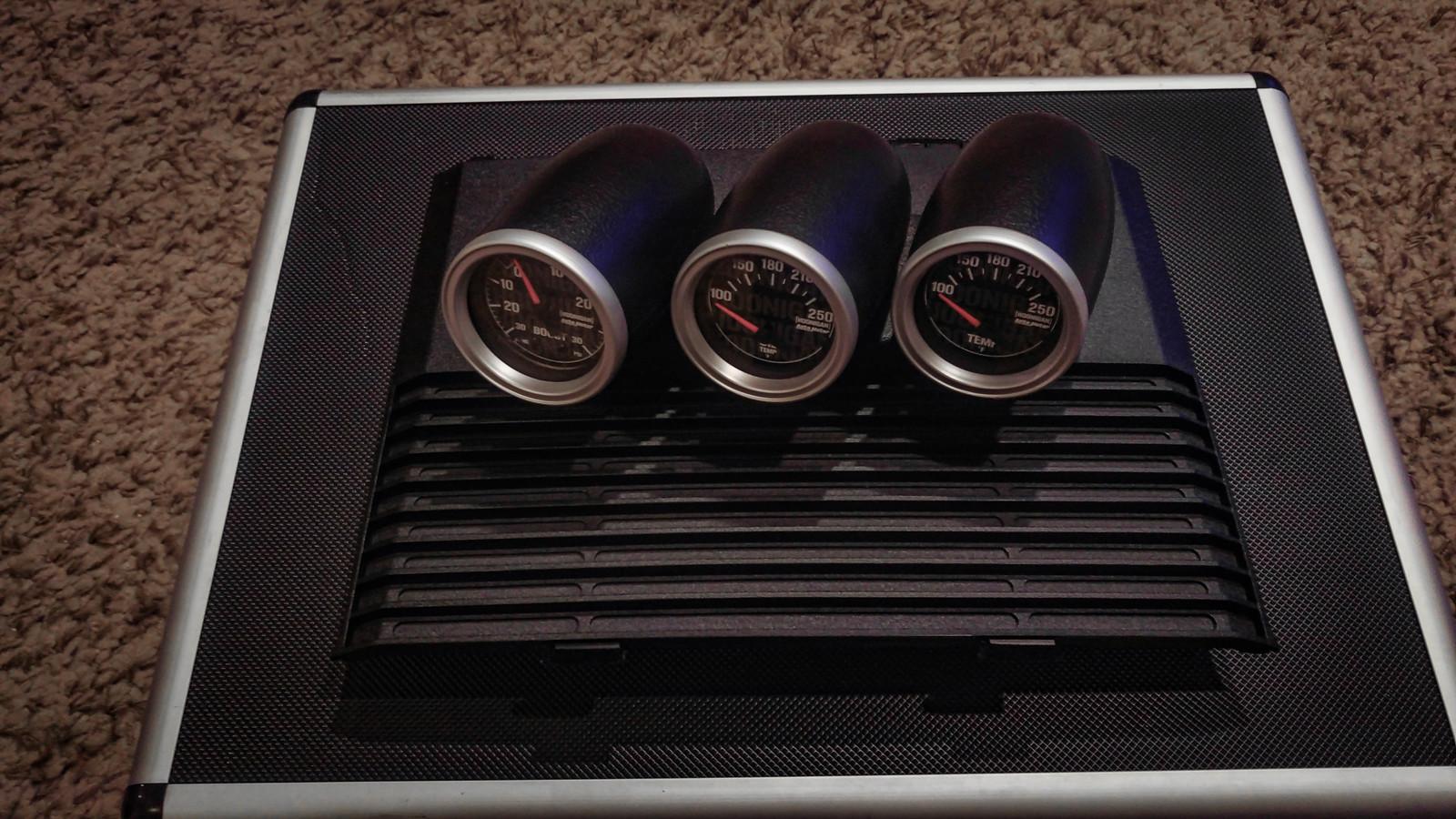

Just a quick test mount as I still have to run the rest of the gauge wires and everything, but it all lines up well. Speed of Sound pod with AutoMeter Hoonigan gauges.

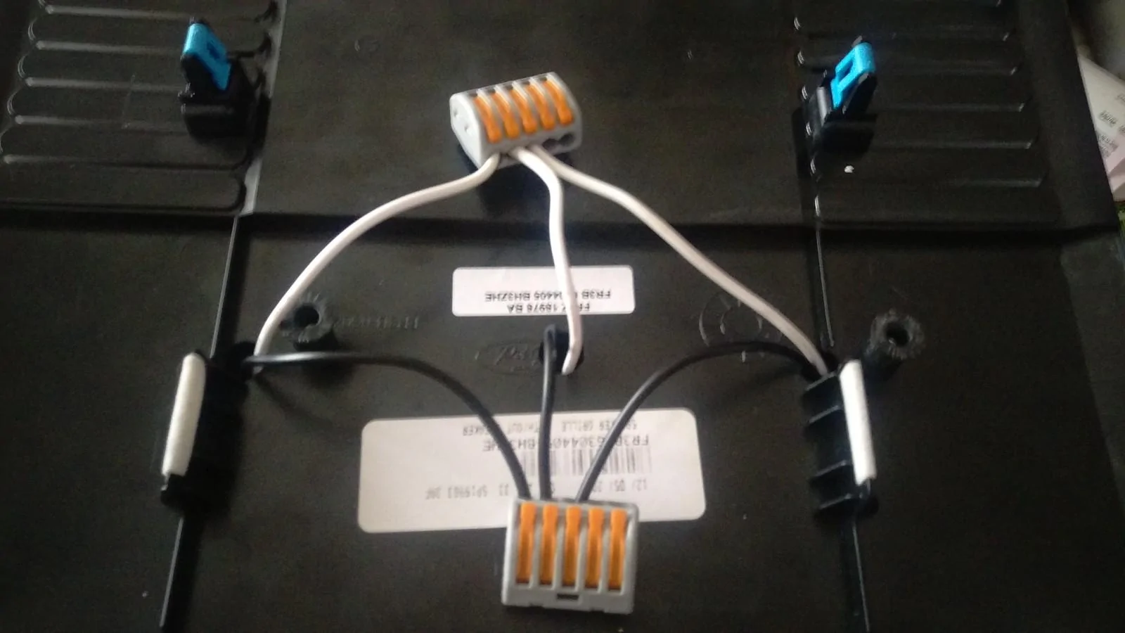

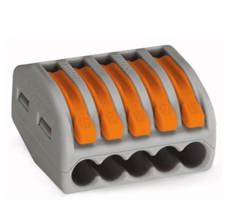

To simplify things and make it easier to remove gauges, if necessary, I'm going to use these bad boys to tie all positive and negative wires together for the lighting. 3 +/- goes in, 1 wire comes out and to ground/12v
