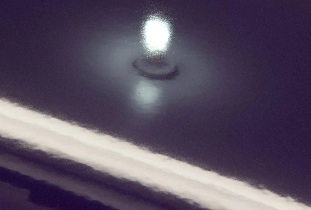

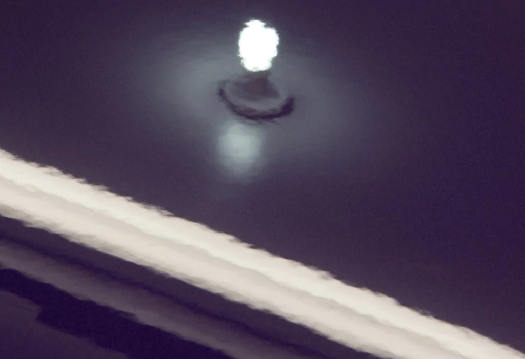

To reinforce @Bikeman315 and @Vettel-ish recommendations to polish even a new car before ceramic, check out these before and after polishing pics of a brand new Hellcat. I thought polishing was just for removing swirl marks but looks like it actually makes reflections sharper.
Think of it like you are locking in the imperfections with the coating. so why would you not want to make the car perfect before "sealing" up the paint. You will notice the difference.
