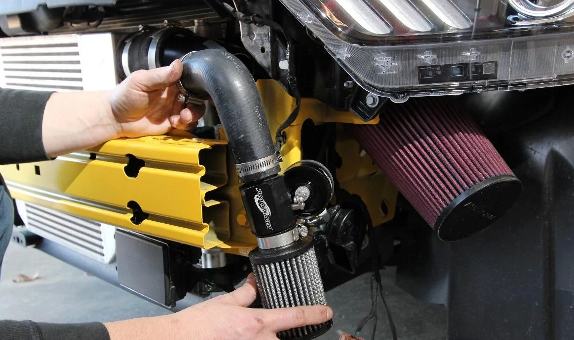

I also know there is not enough space between the front bumper and the front support for the surge valve hose. Going to look at an alternative.
If your running our standard valve, there is a lot of room.
Almost to much actually. Does your install look like this?

I gotcha. Yeah mine worked out but man it's a closer temperamental fit with self cut-to -fit kit parts. Would be nice if the kits had custom fit parts but you can't have everything in a $6k kit I guess lol
Tapatalk spelling errors inside!
Sadly over the 20 years of making kits, we had WAY WAY WAY more complaints about people wanting us to NOT cut any of the tubes, because they would rather do it themselves. (Honest fact)
Some people want long rubber/silicon connectors, others want short as possible and to make sure all hose clamps line up exactly.
Either way, its easier to cut a tube, then try to make it grow. :) :)
