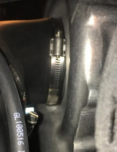

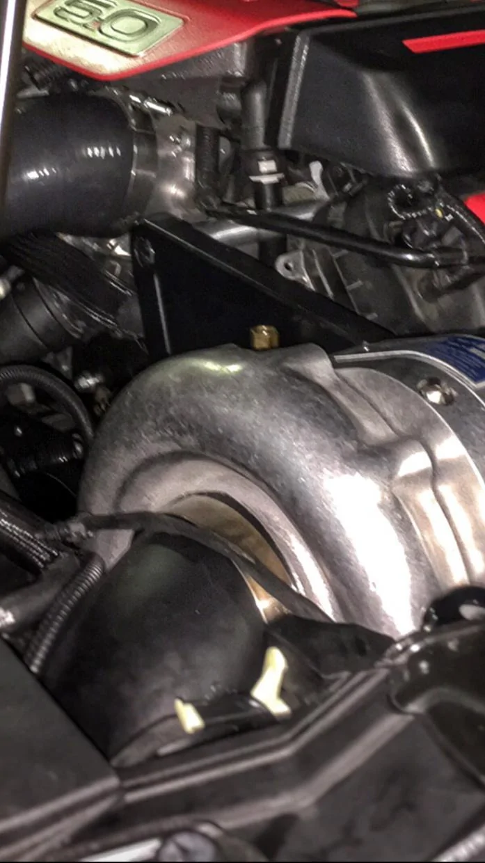

First I'm having a bugger of a time getting the clamp on the blower to fit well over the hose. I've even had someone help me by pushing the clamp on the topside flush with the face of the blower while I do the same on the underside and tighten the clamp at the same time. Everytime I get done it seems to "smudge" the clamp off the end of the hose creating a gap everywhere but where the clamp screw is. I have T-bolt clamp that I was trying with and was getting the same results. I see the end of the hose is pushed up against the blower, but the clamp is just all jacked. Anyone? Not sure if I should run it this way?

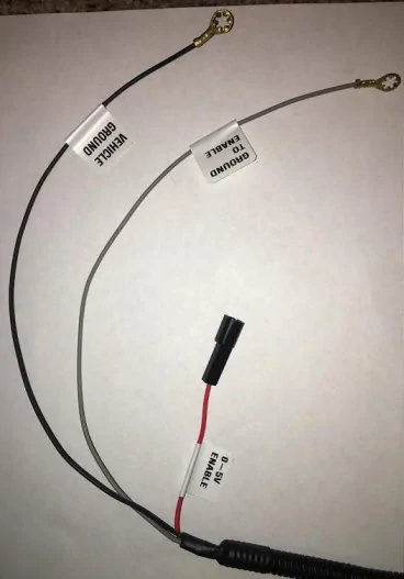

Next, following the JMS fuel pump booster instructions it says put the grey and black wire lugs onto the pressure switch on the vacuum manifold. Here is a pic of that end of the cable, just wondering where the red wire gets plugged and why they are labled "vehicle ground" and "ground to enable" guessing that's just what the pressure switch terminals do?

I just wrapped up the red wire with they other 2 wire and taped them together. There is no connection for that wire. As for the firewall I drilled a pilot hole then a 1/2" hole just to the left of the steering bracket and above the center of that bracket. I taped up the end that goes to the vacuum device and fished it thru the hole and then up along the wire harness by the injectors to the vacuum device.. Not sure what to tell you regarding the clamp. It may be time to take a break and throw a hammer at something. Seems to help.

Anyone else have any input? I'm worried about that hose clamp on the intake. I must have tried 4 times and it keeps slipping off by probably 1/16" (maybe a hair more) opposite the clamp screw. Weird I can only keep the screw side fixed against the blows even though it starts off fully seated all around by pressing against it with a couple screw drivers. It's like the clamp is sprung wanting to back off. It feels locked solid on there, just sketchy to see it catywompus like that.

That is the hose clamp I told you to ditch and go buy a 4.5 inch T clamp to replace. It is wider and easrier to get on. There is no way to get that worm clamp on there IMHO

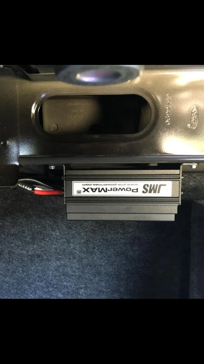

Here is a pic of where I put mine. You can also hide it behind the driver side trunk liner.

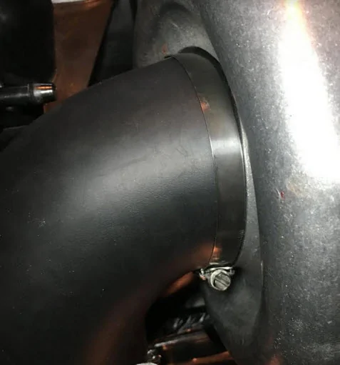

See how much wider the Tbolt is
Well I went and bought a T-Bolt clamp after your suggestion, found out today it's a touch too big. I'm going to go try and buy a smaller one tomorrow and give it another go. I see your clamp is also pulling away showing some rubber on the backside of it too, see where it touches on the blower on the driver side and starts to separate at the top. That's basically what I'm seeing with mine and has me worried. I'll see where I end up tomorrow (hopefully with a new clamp).
