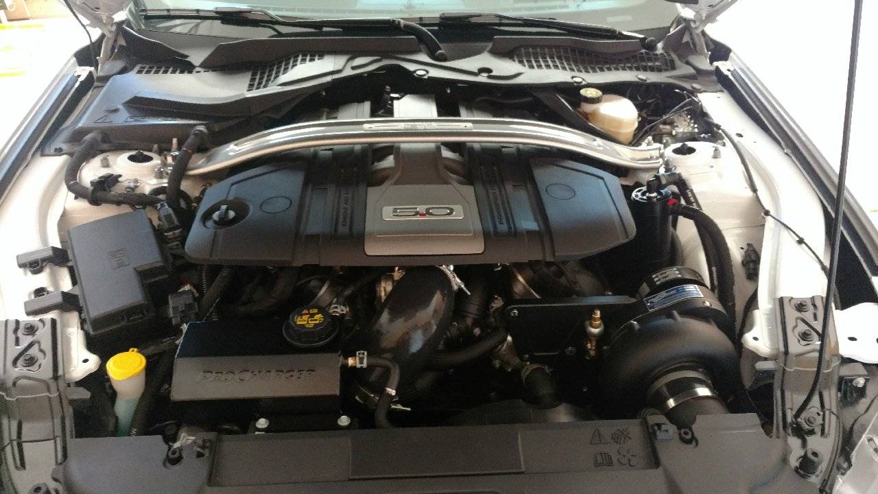

I modified my JLT 3.0 passenger side to work with my stage 1 d1x set up, now I'm looking for a driver side that will work with no modifications? I've seen some people just dump them as well but not too sure about that.

Honestly, unless you make 900+whp, venting the driver side to atmosphere will be perfectly fine. There isn't much blow by at all coming from that side. It's mostly just the passenger side.

Thanks for the reply, I'm right at 900 actually. Can you show me what I need to unplug to vent into the atmosphere?

I run the UPR Procharger can. It’s not cheap but does a great job.

I run a UPR ESS "Clean Side" version.

Have either of you looked inside the intake since running this? Pull the TB off and reach in and see what you find. I have tried several catch cans (including UPRs PC one), yes it catches oil but plenty still gets by and into the intake.

I don't believe I have enough miles on the setup to have any in there. I'll check my ride when i go over 3k miles with them on, right now I probably only have 1200 with the passenger can and 1 with the CSS,

I'm running the UPR Procharger specific catch can. It has hoses that go to both valve covers. I recently had my intake of and there was some oil in there, but not a lot. Just a very thin coating in the intake ports on the cyl heads. Nothing crazy, but again not ideal. I actually get very little oil in my catch can. Over the course of 3,000 miles I might get 2-3 oz at the most. I do notice I get more in the winter for sure.

What is it that you find in your car's intake? In what area?

Agreed. I had the UPR Procharger specific can and still got blow by so gave up and vented using valve cover filters. Bit of mess on the valve covers so picked up a PSIProformance vented can which works really well.

Oil,,,any low spots it can collect and oil film all over.
Yep went with breathers and never looked back.

A UPR Forced induction catch can will get the job done! Another option would be to run a crank case breather! Shoot me a message if you have any questions or would like to order one! @LethalPerformance
