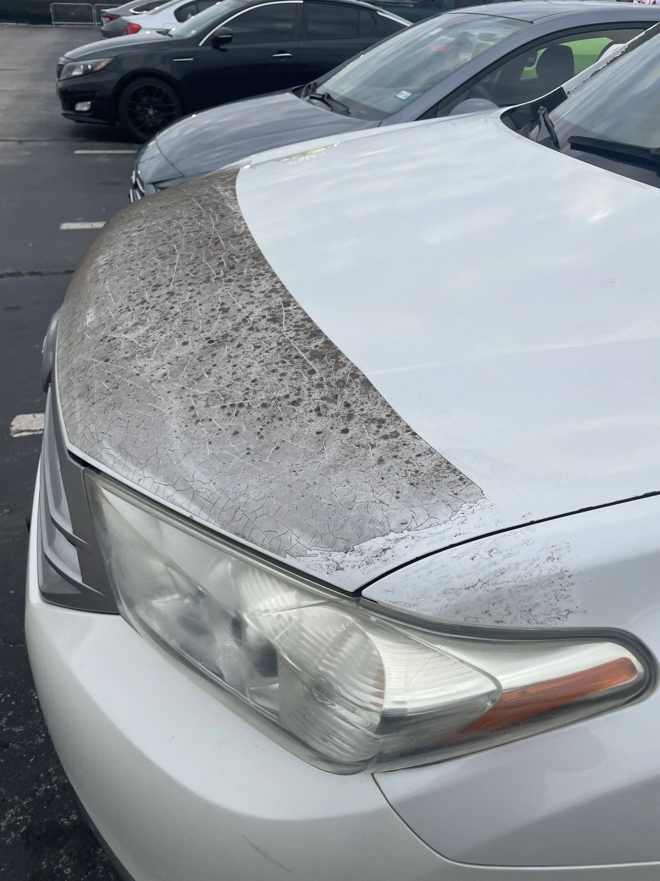

I’ve been hesitant to put PPF on my car because of images like this. Has there been an advancement in the materials that would keep it from turning into this image eventually?
Not sure about other areas of the country, but here in the Houston area we have dealers who insist on installing this and including it in a mandatory "package" for paint protection, with all of the profit margins built in. If that's the case here, I wouldn't doubt that this owner paid over $2K for this disaster of an install.
Also, these add on packages don't necessarily use the higher grades of PPF.
We had a 2015 Rogue that had this "mandatory" package on it - thank you Sterling McCall Nissan. We never had a problem like this but I have a family member who did after ~8 years of ownership. She had mold growing in the leftover adhesive from (and around the sticky edges of) the PPF on a white Maxima. No amount of bleach or other chemicals we had access to would resolve the issue. Eventually she had the whole mess removed and never looked back. She'd rather have rock chips than PPF that looks like this.

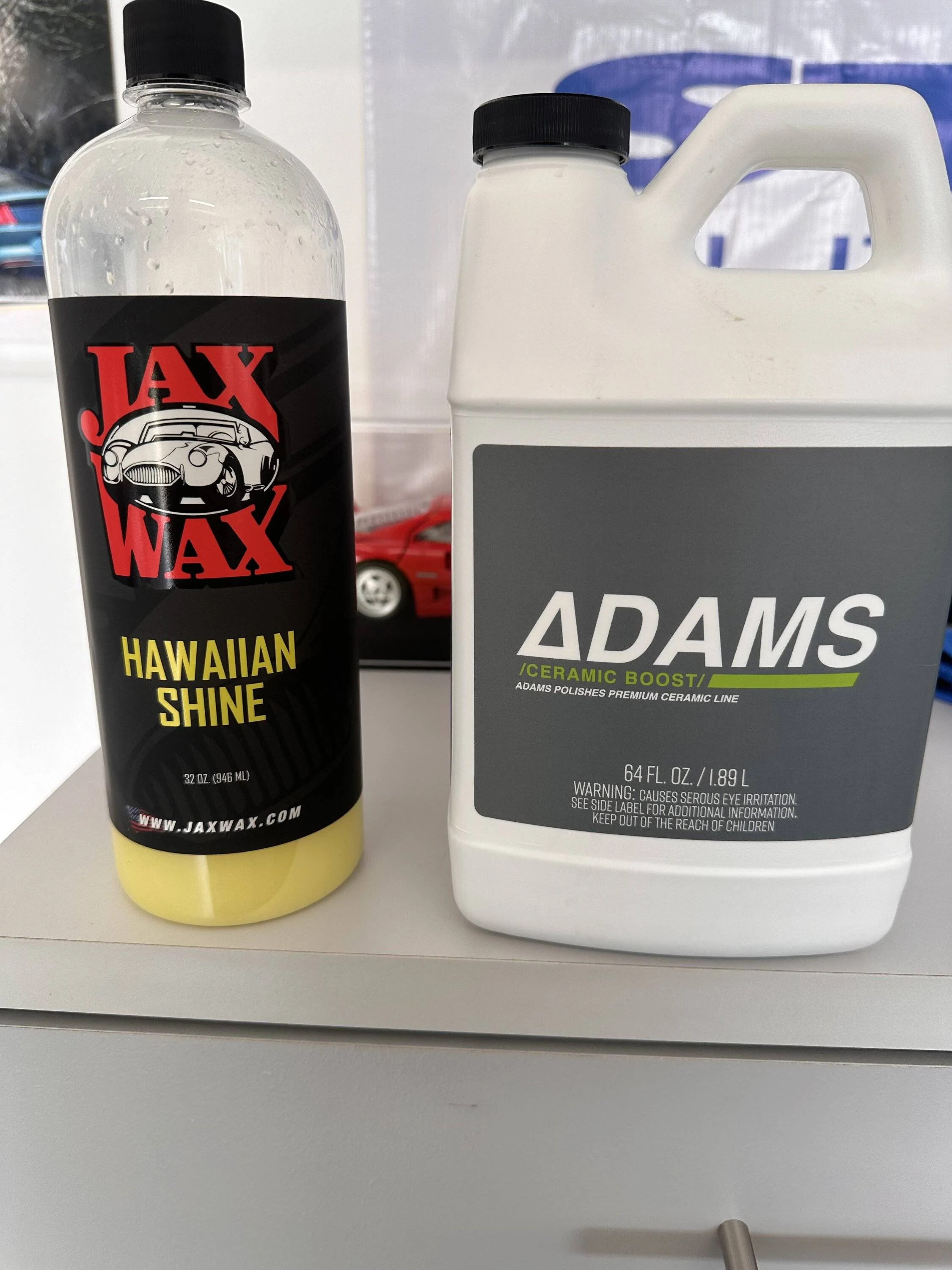

I’ve done the maintenance boosts myself there are a couple that are really good…. Adams Ceramic Boost and Jax Wax every couple months, Iron decon once/year. Even if garage kept and reasonable miles the sides pick up a bunch from the brakes. The last wash I did, used the Adams after the wash wash completely done sprayed on and the pw’ed rinsed off. Big difference in gloss. My XPEL w IGL Ceramic will be three years in April, 100% best decision to spend the $$.
