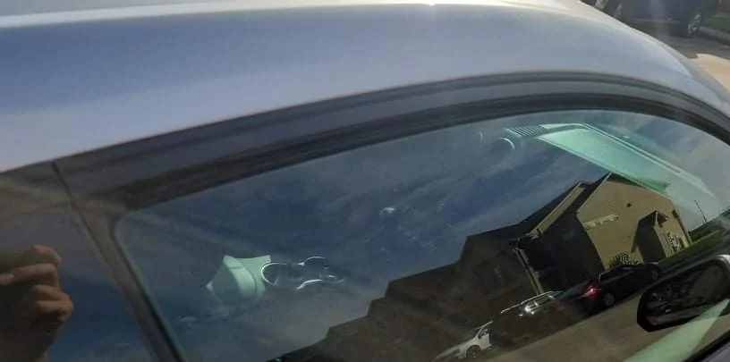

The system that drops the window 1/4 of an inch when opening and closing the door is malfunctioning on my car - passenger side. It has started popping up and down at random as I drive, usually popping down and staying there, causing high road noise to enter the cabin. I have discovered that the door handle feels a bit loose, and by wiggling it (with the door closed) I can cause the window to move up and down as if it was opening. Is the sensor that controls this in the handle itself? Do you think the handle just needs tightening? Appreciate any insight on if this is something I can fix myself, or if I (God forbid) need to go to the dealer... I have limited mechanical fortitude. My theory for fixing things is "if it doesn't fit, get a bigger hammer." Thanks in advance for any advice!

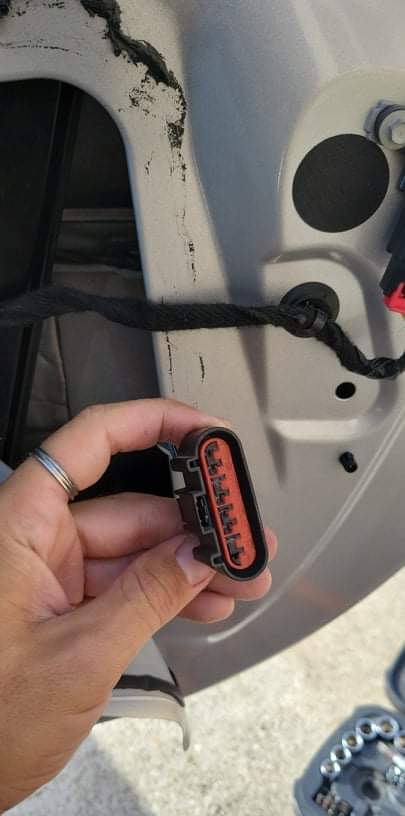

Ok, so I first used dielectric grease on the latch actuator but didn't seem to fix it(tho ostensibly helped..) after more reading about the window motor I cracked the door open like a clam to put some on the window Motor plug, that did have water around it fwiw, and drove it around for a bit and ..... Soooo far it's not constantly fluttering open like it had the last few days.

Possibly very helpful, thank you. Mine stopped acting up for about a week, and then after a day out in the rain started popping up and down again. I was suspecting water may be part of the problem.

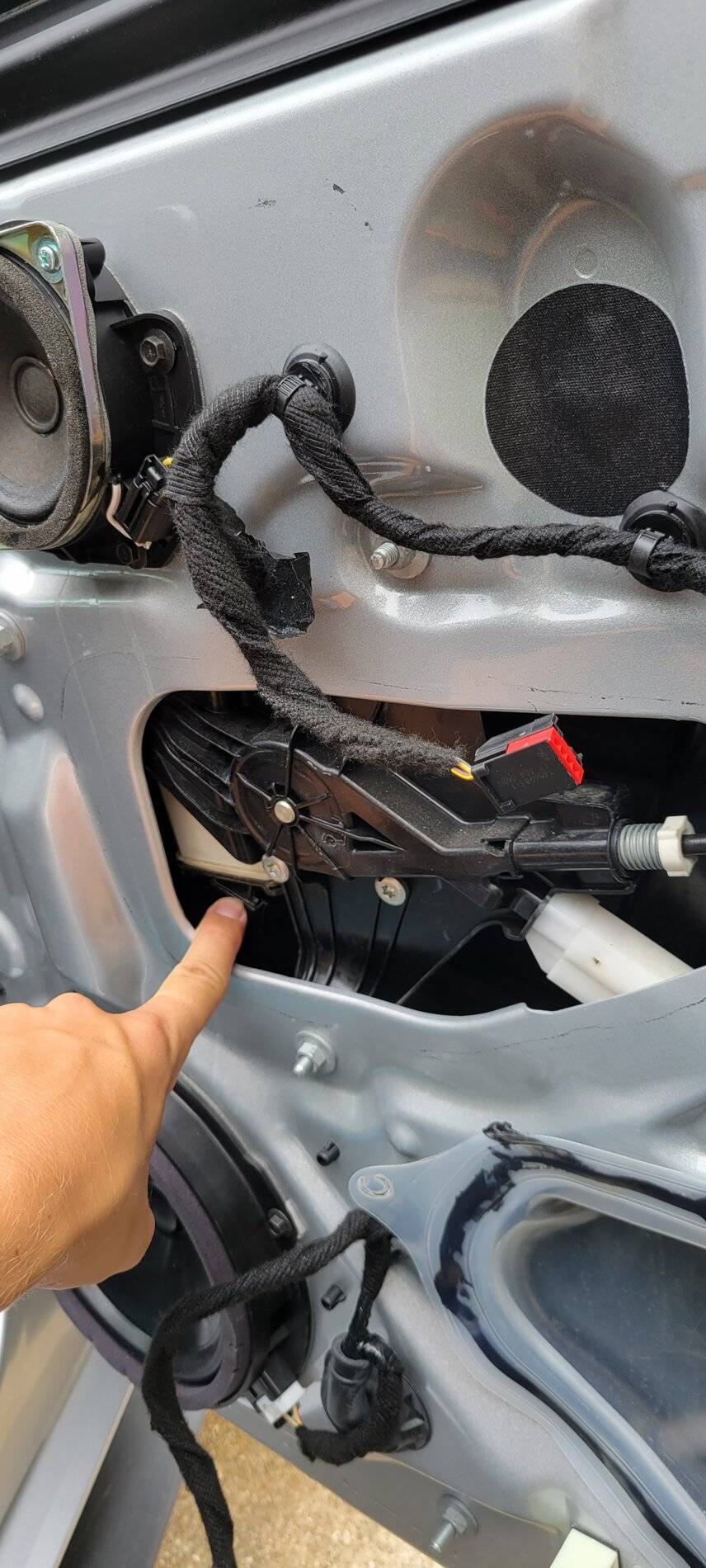

Not very reassuring that it isn't constant but apparently still (fluttering). It looks like the motor is easy to replace once you get to it in that photo, hex screws but how about what looks like the cable that raises and lowers the window. There must be a disconnect somewhere on the window bottom?
I can't understand why the passenger side, like mine, seems to be the one most all complain about here. Less used than the driver door but the one that breaks! Is it the motor that has the control over how far the window lowers and raises when the door is opened or the computer that regulates it?

Quick update: after adding the dielectric grease to the regulator Motor plug I've not had 1 hiccup thus far. 🤞🏻
