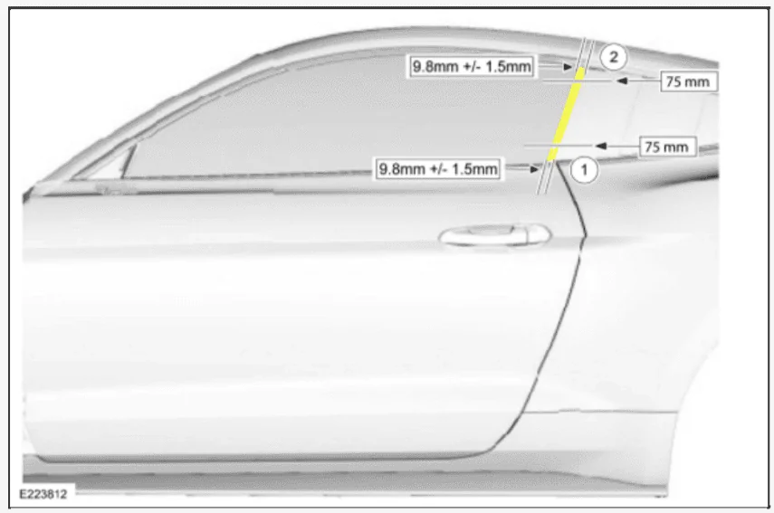

Coming back into this one - attached find the S550 window alignment docs. This is for a COUPE. I had posted similar docs in the convertible section as each is specific to the body type.
Great info thanks, I have saved it for future reference :like:
Looking at this diagram :
It looks like I got lucky with who adjusted mine at the factory !
