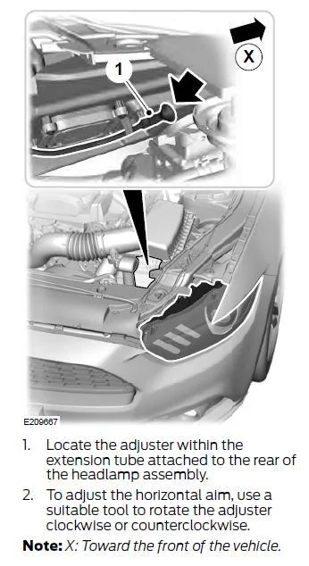

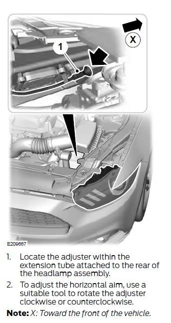

I got my car back from the body shop who had replaced my p/s headlight assembly and it was aimed way too high. Problem is i see to remember the headlights looking like a smooth straight line across the top when I pulled up to my garage door. Now there is a discernable notch between the left and right headlight. So when driving, there appears to be a hole or gap. Can anyone post a pic of what their headlights look like shining at a flat smooth wall?
Sounds like they are not aligned horizontally. Again, see the owner's manual on how to adjust headlights.
BTW - I noticed that there is a 3rd printing of the 2015 Mustang Owner's Manual, and in there they added how to adjust the headlights horizontally. In the older manual, it said there was no horizontal adjustment. You can download the latest owner's manual in PDF form off of Ford's website or other sites, just Google search for it.
Here's the new part in the OM on how to adjust horizontally.

Horizontal adjustment
I went to adjust the headlights horizontal alignment cause the left front points into oncoming and there is no adjuster as per the manual.
Its like Ford purposely left this off to save money. That is GETO Ford.
Anyone else missing the Horizontal adjuster?
Anyone have pictures of it or where it goes into the assembly so I can adjust without bending metal and disassembling front end?
Strange, as I mentioned before, the 3rd printing of the 2015 owner's manual (March 2015) shows a horizontal adjustment. Wonder if earlier 2015s didn't have the adjustment, and Ford added the capability later in the model year? :shrug:
Here's a snip-it from the 3rd OM printing showing the horizontal adjuster and location.
