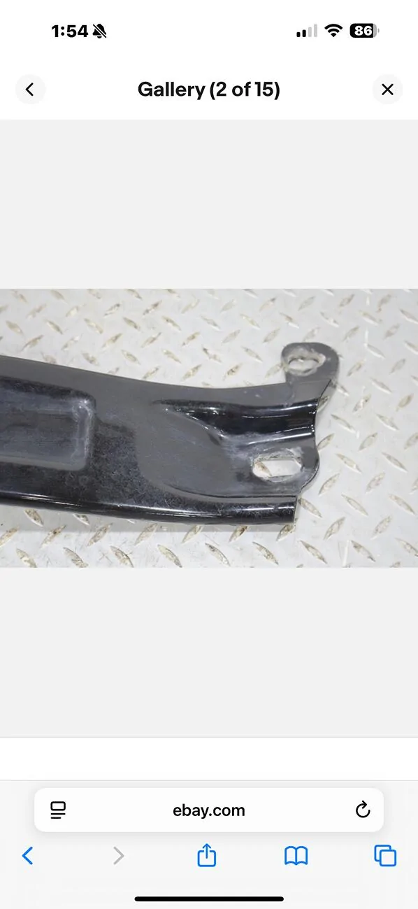

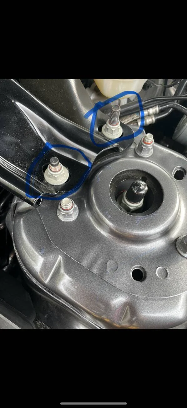

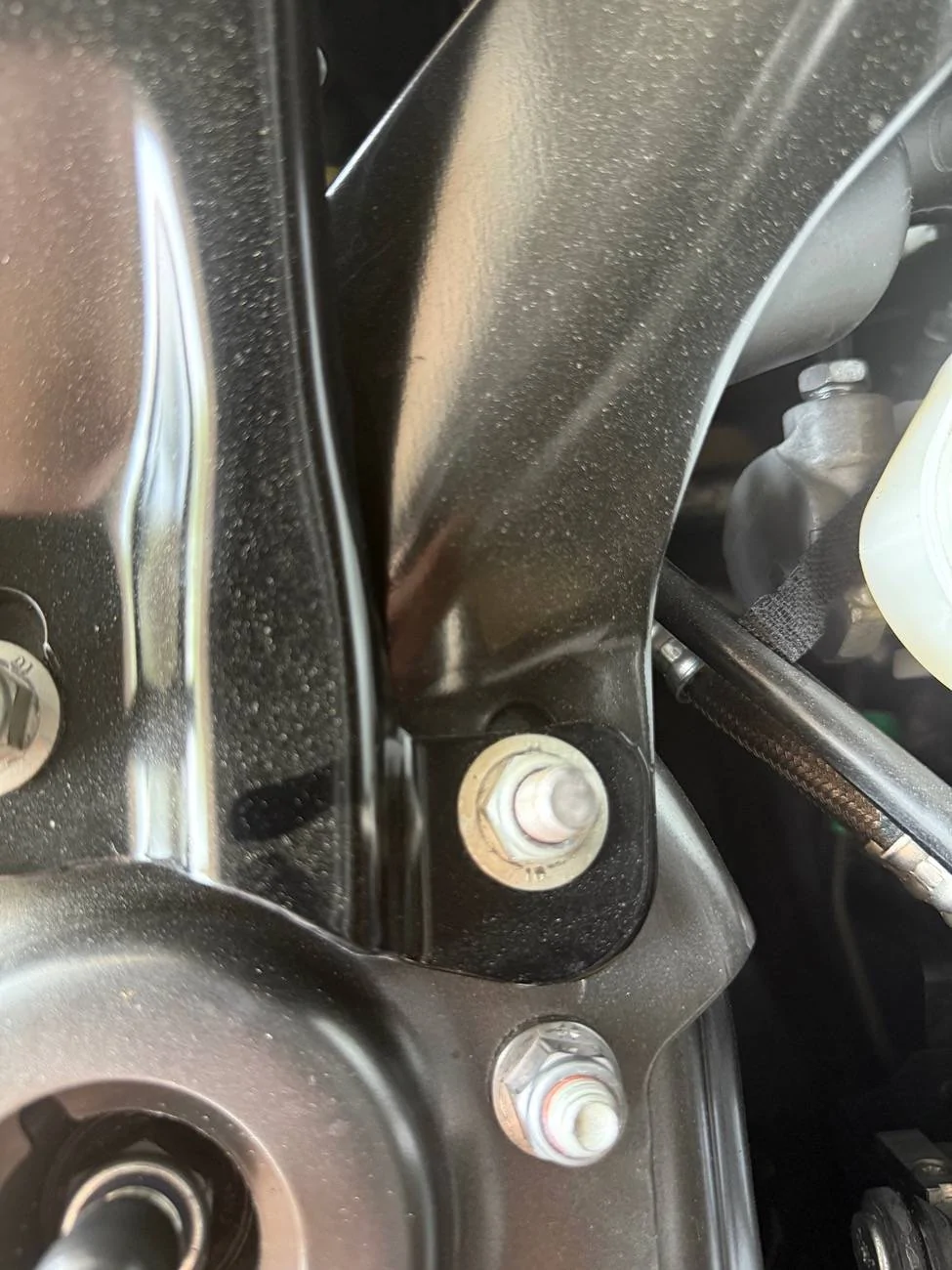

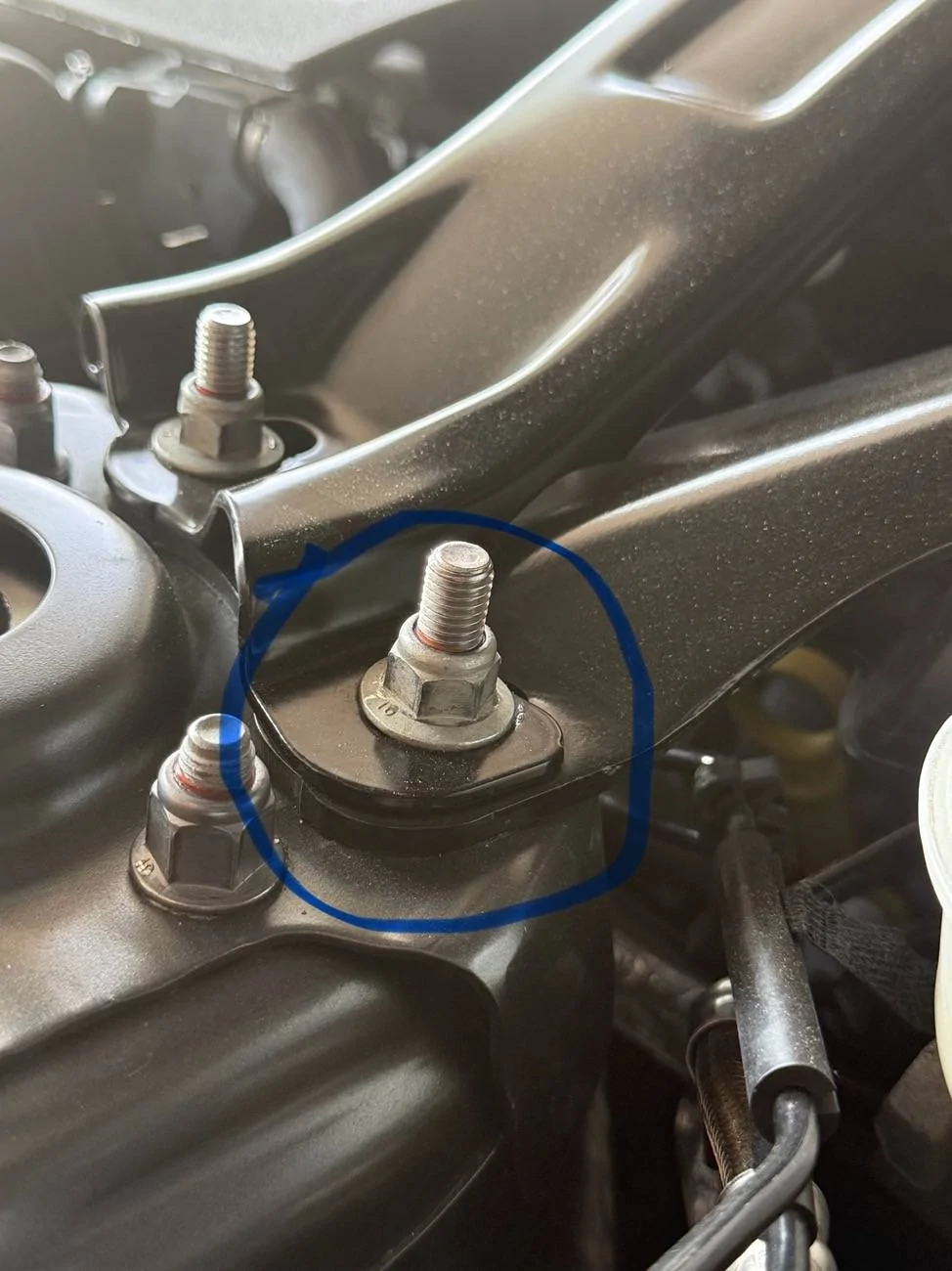

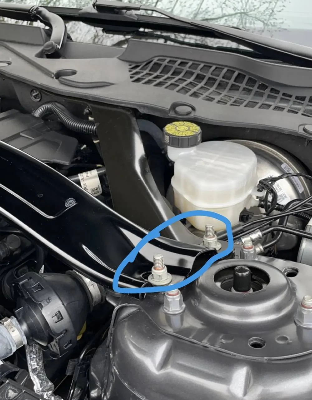

So awhile back around December 2023, I tasked a shop Batavia Body Werx to install a STB on my Mustang while it was in for other body work. While installing the brace, they snapped the furthest back stud towards the fire wall on the driver side, and replaced it with a bolt. I was worried about the replacement and also wanted all 4 of my studs to be uniform. I tasked this to a reputable restoration shop, Custom Classics Auto around April 2024. While I trust Custom Classics work with the upmost confidence, Batavia Body Werx, not so much. They’ve since closed as well. Here’s my question, Custom Classics clearly replaced all four, but is there a way to tell if Batavia Body Werx mangled the hole either drilling or pounding out, short of taking off the brace and looking? Everything sits flush and torques down correctly, so I’d think that’d be the giveaway. I’m also going for a suspension install soon, could I have this shop check from the bottom while they’re down there? Thanks.
Original repair that shows factory stud and replacement
Current Repair
How current repair sits
Stock image of brace off car
To me everything looks good and aligns with the brace hole correctly. I assume if the hole was mangled or widened that I’d be able to tell by how the brace and stud sits. Just wanna put this thought to bed.

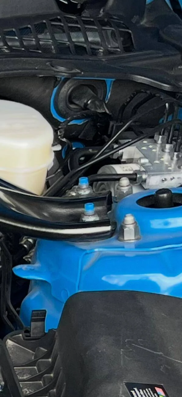

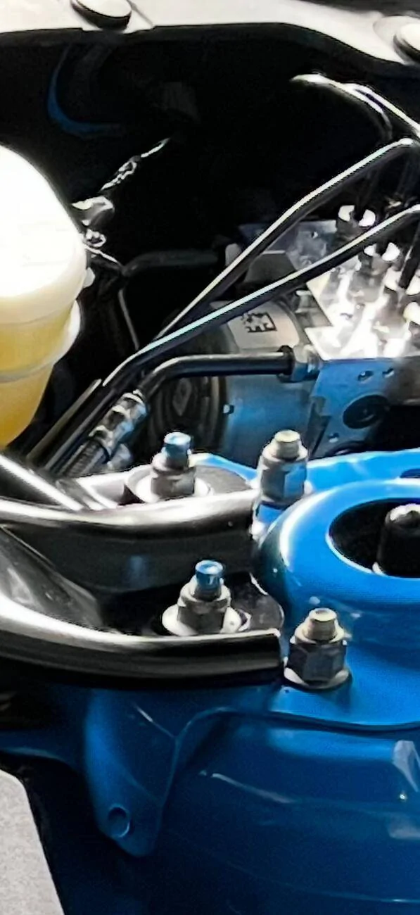

Yours looks fine to me. Here’s a couple close ups of mine. Can get a few more tomorrow if needed
Mach 307
Mach 307
Mar 26, 2023
106
1,445
2,410
Illinois
Alec
2022 Mustang Mach 1 Premium HP – TR-3160 | 2008 Toyota Yaris Hatchback
Thanks Mags, mine seem to sit exactly the same so hole shape must be good 👍

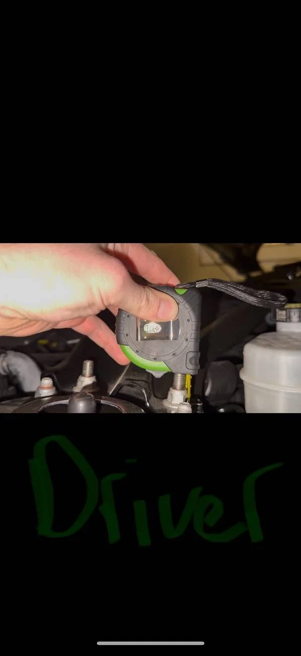

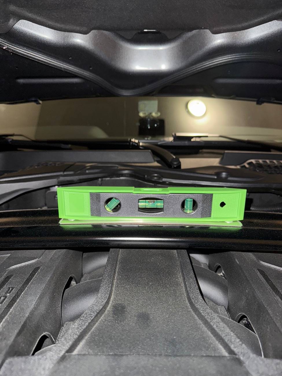

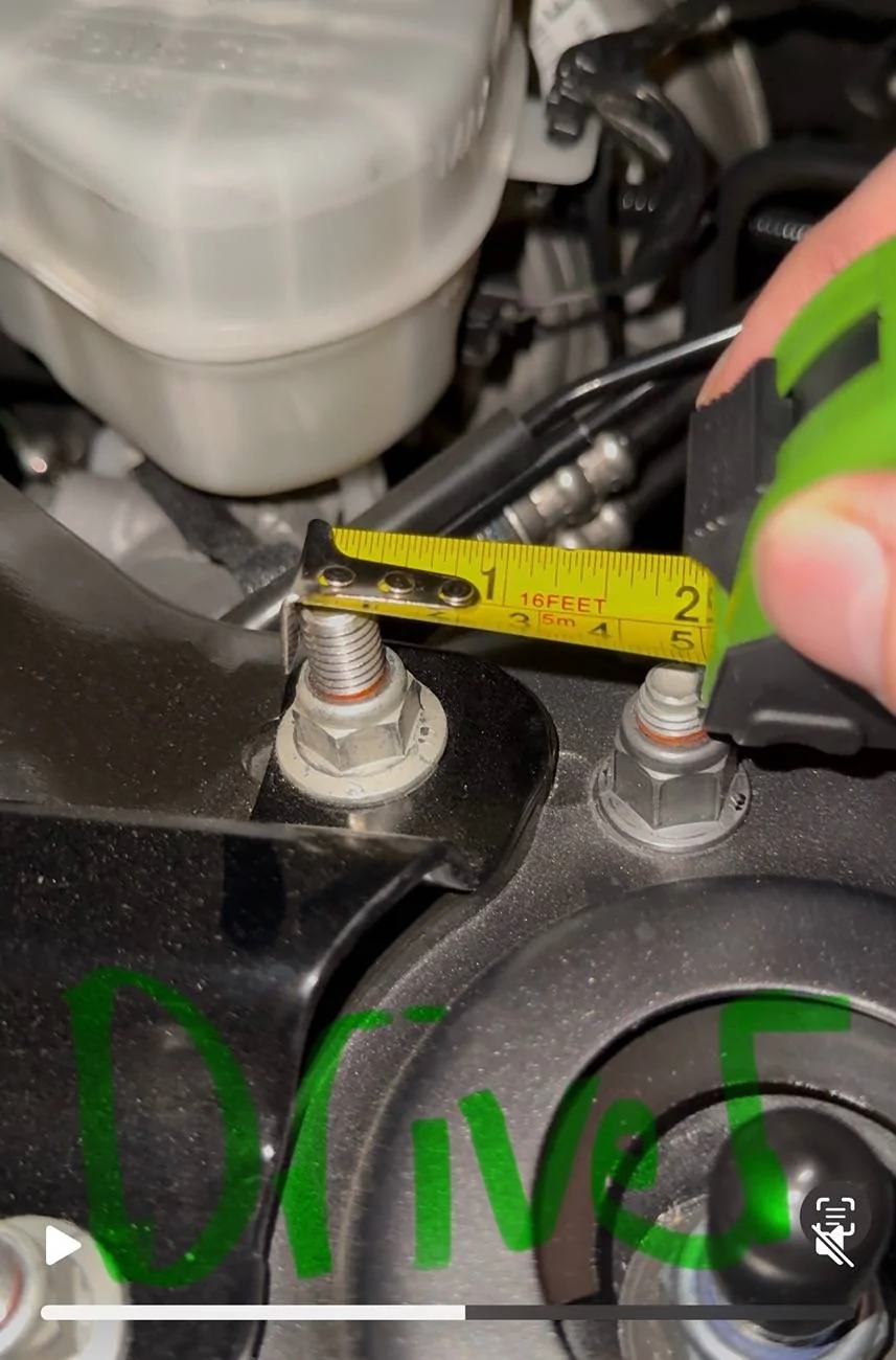

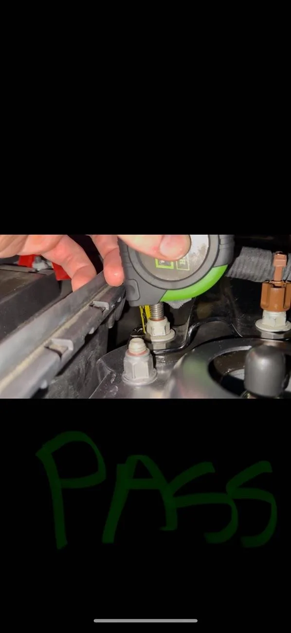

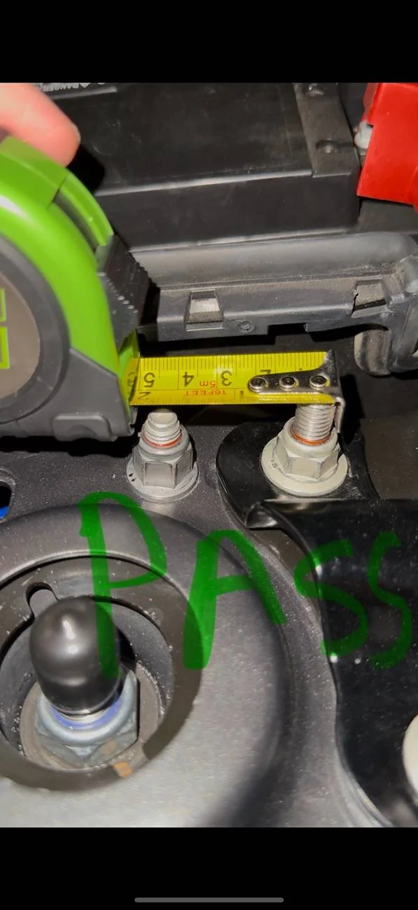

So to give myself some more peace of mind at the moment, I did some measurements I thought might be able to confirm to me everything’s all good, barring taking off the brace. Which I don’t have the means to do at the moment with my current living situation if they are in fact bolts and will fall through if I take off the nuts. I may have the shop who’s installing my FP Track Handling Pack coming up take off the brace because I’m curious.
Brace sits perfectly level
Driver side (touched by both shops) and passenger side (touched by trusted shop only) “stud” protrusion from strut tower exactly the same.
Driver side (touched by both shops) and passenger side (touched by trusted shop only) “stud” distance to strut top mount stud exactly the same.
I know my pictures aren’t the best but in person I was able to confirm. I suppose to me this tells me the driver side hole is the exact same size (not widened or misshapen) as the passenger side hole, among not having any issues while driving with noise, etc.

Honestly those studs are quite easy to break and many who attempt the strut tower brace installation will break one.
The repair is way more simple and straightforward than you may think and by your pictures it looks like they did a good job.
Also, it seems unlikely to me that Batavia mangled the hole but even if they did, again the pictures show what appears to be a well done repair by CCA.
It is my humble opinion that if you can grasp the brace and it won't budge then the hole and the brace are just fine and you shouldn't continue to worry about it.
