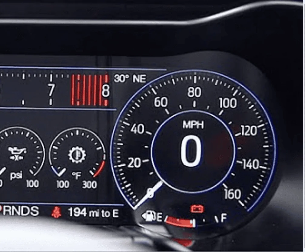

" If successful the battery light will flash 3 times within the next 15 seconds "
Dumb question: Where is the 'battery light' on a Mustang? All mine has is soft gauges.

Bottom of the speedo. Above the gas gauge.

Thanks. Never noticed it, must go off after startup?

Yes, it behaves as any other car. When the engine is off the light is on because the alternator does not produce electricity.

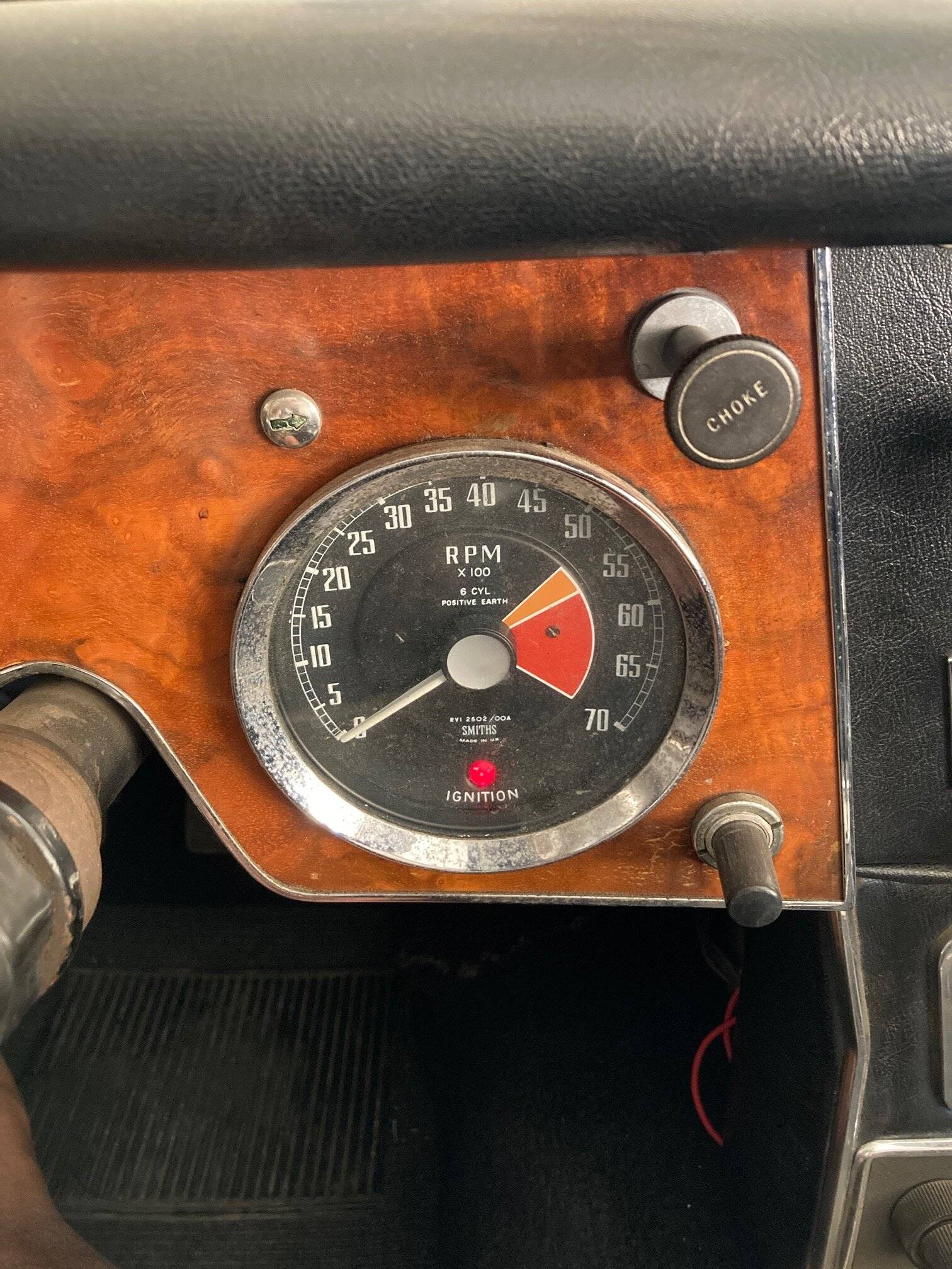

As for the battery idiot light, thanks for the info. Truth be told, I never pay any attention to the idiot lights unless they stay on after startup. This is an idiot light I DO watch (sheesh, looks like I've got some chrome polishing to do):

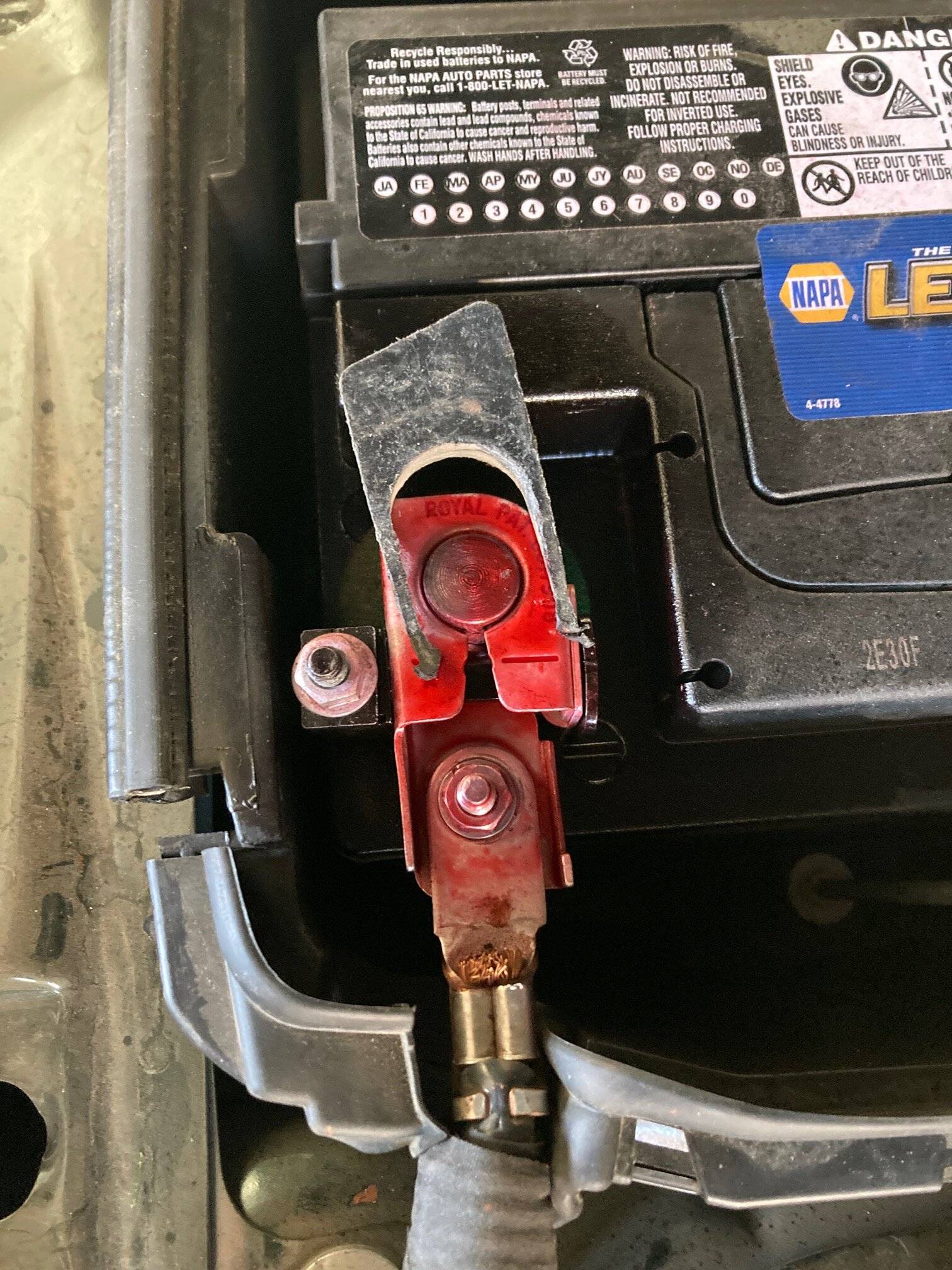

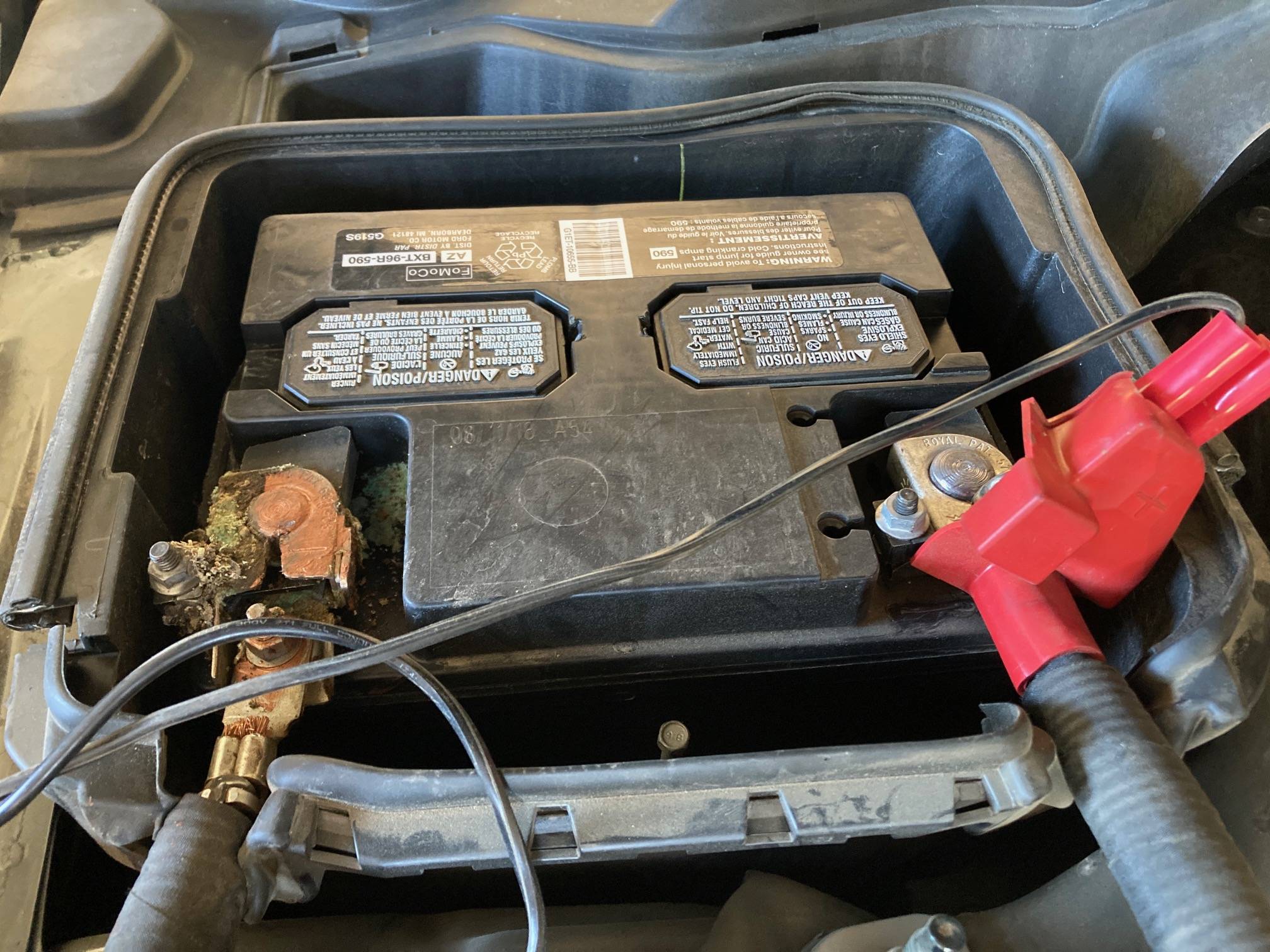

Yep, my result as well. However ... I have a really trivial observation: What is the purpose of this plastic spacer? Apparently, it's to ensure the two-piece ground cable assembly is canted just a few degrees clockwise--the notch in the battery compartment insures the cable goes straight in--but ... why? I noticed it when I pulled the battery for replacement and assumed it came with the clamp, but it fell off on my gravel driveway and I didn't notice it until I'd already compacted the driveway. It's gotta have a purpose--though I can't see it--else Ford's beancounters wouldn't have allowed the $0.03 and 15 seconds it would take to install it, and I've not seen anything like it on other cars.
Edit: Just came across this. Makes sense, I guess, but I've not seen a terminal 'rotate' unless it wasn't torqued down sufficiently. Also just noticed the slightly different one on the pos. terminal, which didn't fall off when I replaced the battery.

I definitely had that same blue fuzz on the negative terminal, and the connector was definitely not salvageable. I bodged something else together, but getting an OEM terminal back on the negative side is on my to-do list.
