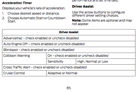

Bikeman315
Apr 12, 2015
583
16,194
21,915
Myrtle Beach, SC
Ira
Surprisingly, when I go to the display it only gives me the option to turn it to low, there isn't an option to turn it off. Hopefully it won't be beeping all the time at the track.
You do not see this? Maybe your dealer can help.

Torched10
Torched10
May 15, 2019
107
1,320
542
Atlanta
Bob
2019 gt premium convertible. 2017 caddy xts vsport twin turbo.2011 caddy ext
I don't see those options on my 2019
Where is it in,owners manual,or on info display
Vlad Soare
Jan 21, 2020
67
3,674
4,510
Bucharest, Romania
Vlad
2020 Mustang GT 6MT
I believe they're still optional in the US (lucky you!). They're only mandatory in Europe.
