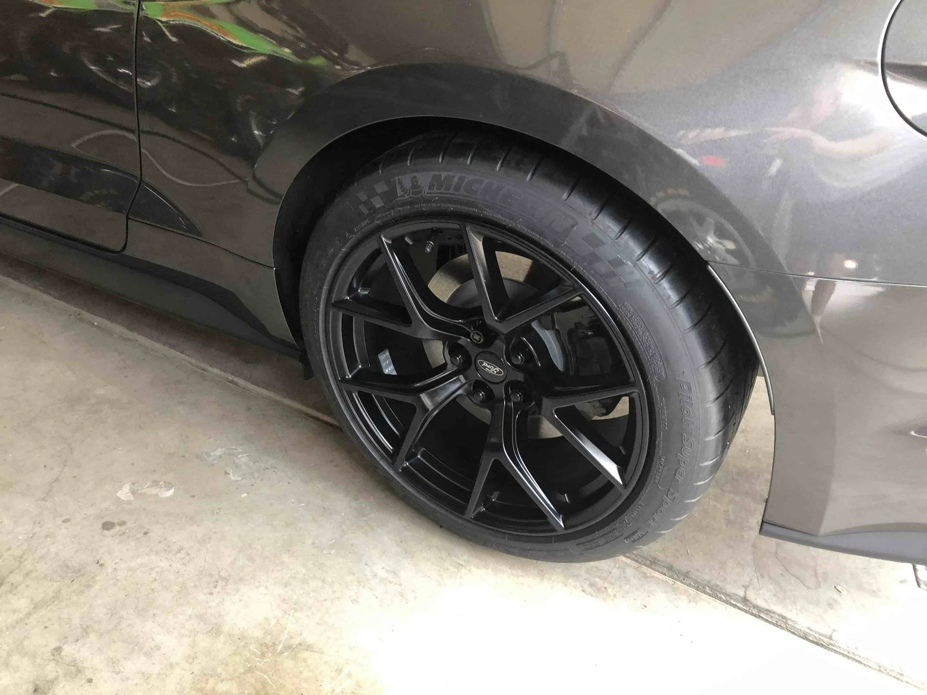

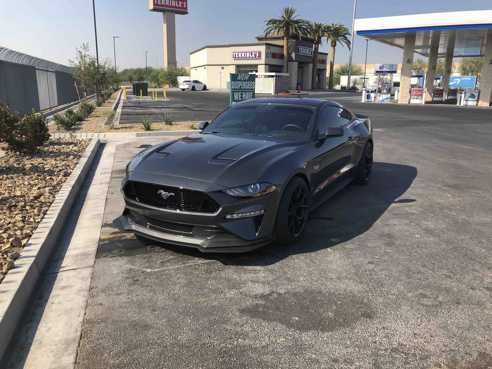

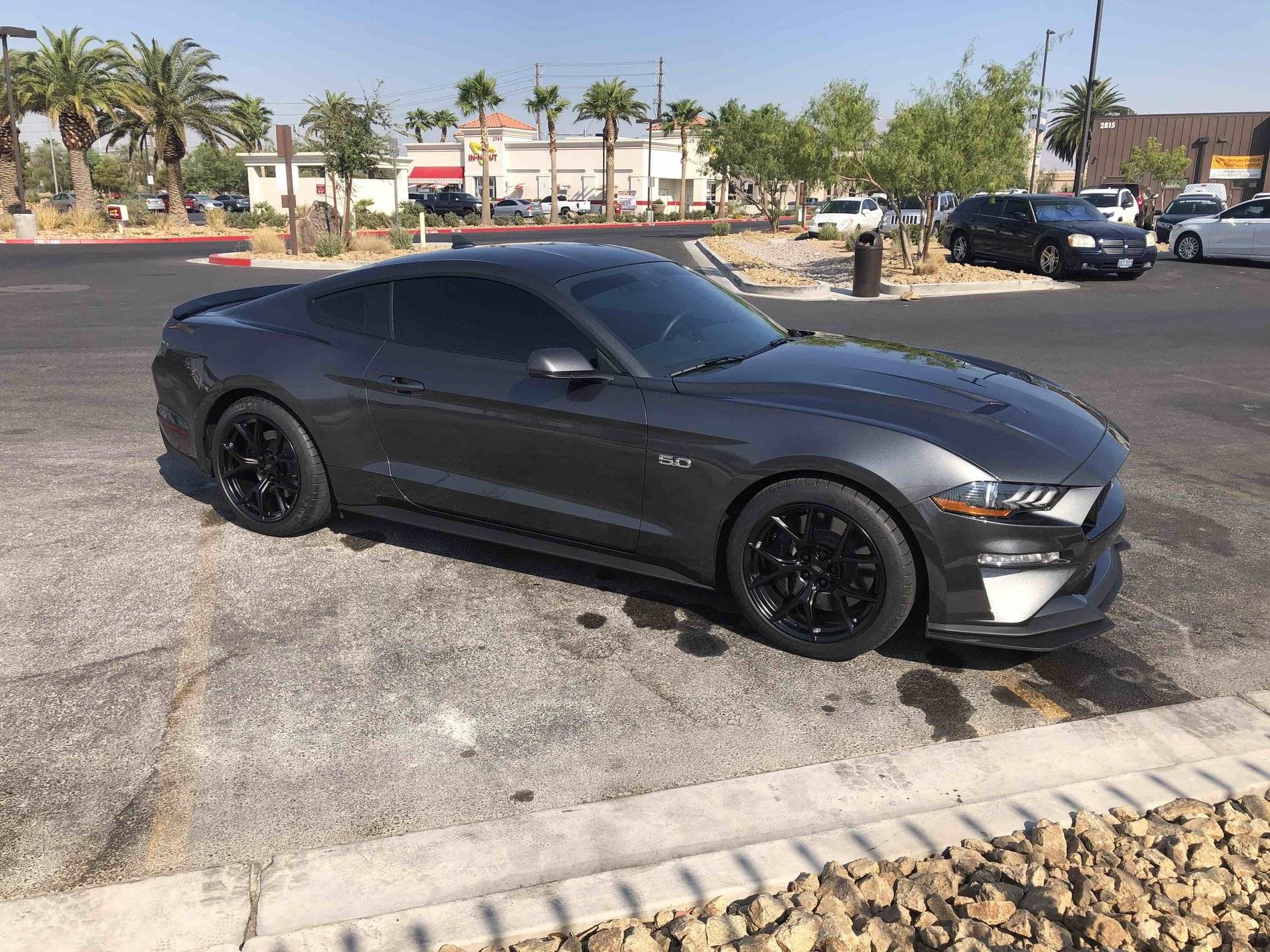

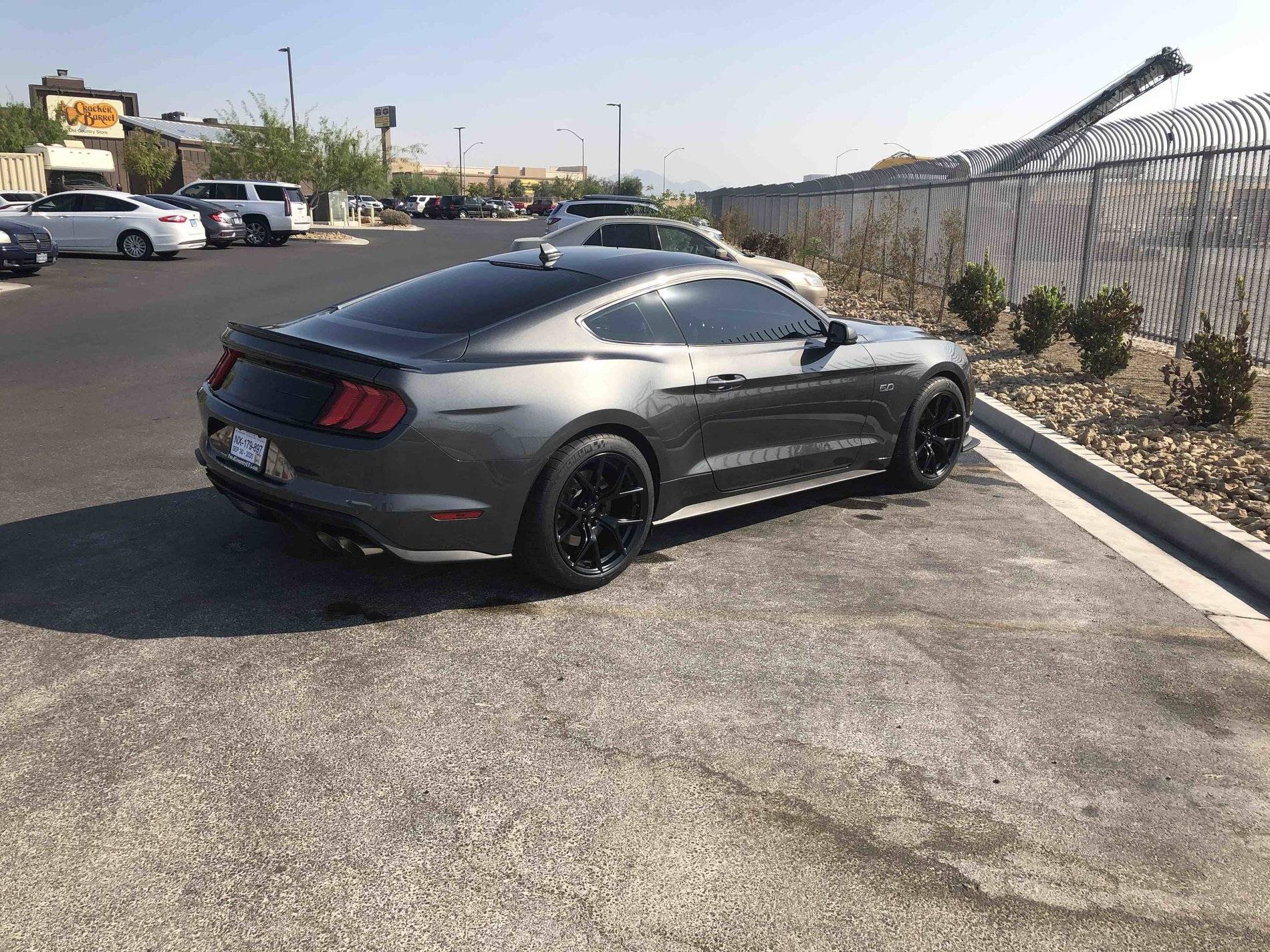

Got the new tires mounted up on the new Ford Performance wheels yesterday and got them installed on the car this morning with some Gorilla black lugs. Only pic I have so far, but will get some more once I get it out of the garage over the weekend.
Doug
Mikepol2
Jul 17, 2018
140
3,986
7,093
Pittsburgh, PA
2021 Mach 1, 2019 Ram 1500
Excellent choice with the black wheels to go with the magnetic car.
Jonyxz
Apr 16, 2017
354
269
San Juan, PR
2019 5.0 401A 10R80
looks fantastic, you added the gt350 center caps?

Yes, I already had them. Was running them on the SVE wheels I had on my 2017 GT.
Doug
HoustonGT
Aug 8, 2015
71
330
87
Danville, CA
2020 GT PP2
Yep that was me. I actually ran the 295/35 front and 305/35 rears on both stock GT350 wheels and the PP2 wheels. Different offsets between the two. Zero rubbing with the stock suspension and the GT350 wheels. @Jonyxz is right, I did get a little rubbing in the front with the PP2 wheels but that was with a 7/8" drop spring. Now running the GT350 springs which gave me about 3/8" drop, and solid as a rock, no rubbing.
