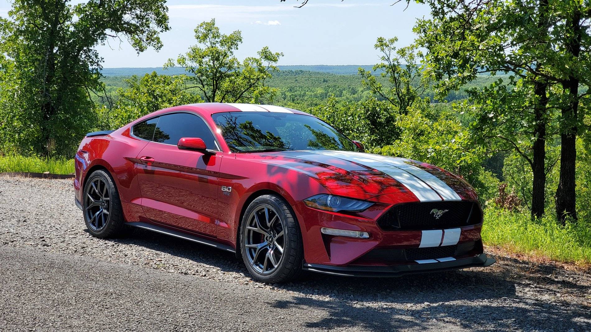

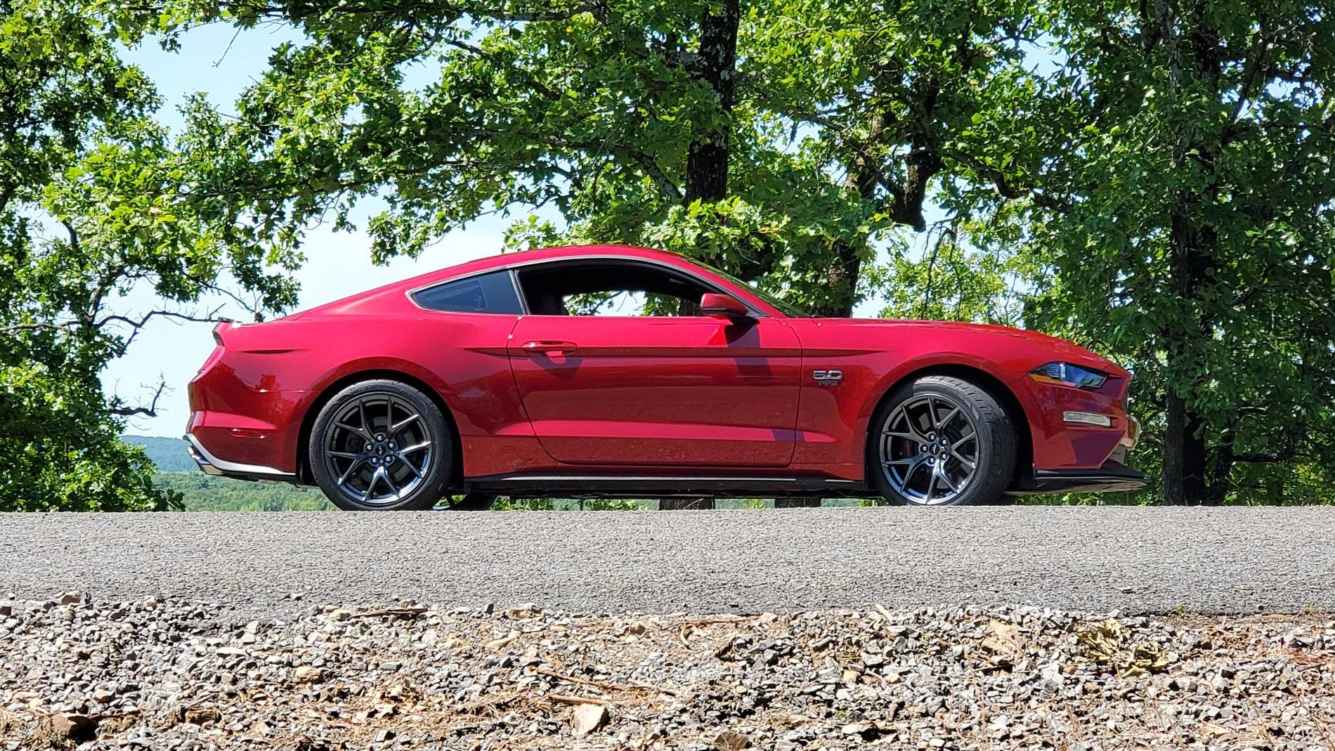

I have a PP2 and change my cup 2s out to nitto 555 G2s 305/35/19 all the way around with no issues. The gap looks better too. No rubbing issues either other than one time at high speed in normal mode on a very rough hard corner. Just a slight touch that one time. On a track it has never rubbed.

So you are running 305/35's on the oem PP2 wheels? Have any pics you can share of your setup? I have been thinking about doing a 305/35 square setup on a new set of 19x11 wheels all around. If 305/35's will work on the oem wheels, I may just do that for a bit and then get some 19x11 Apex wheels when the black Friday sales hit in a couple of months.

Yep, stock PP2 wheels on a PP2 car...no issues with the 305/35s. Here's a couple side shots of them so you can see the gap.
Thanks for the pics. That looks awesome, I think you just sold me on 305/35's all around! Is your suspension all stock? You mentioned you did have a slight rub in a high speed rough corner, did it rub on the fender itself, of the inner liner? I will end up going with Michelin Pilot Super Sprits and by looking at online specs, they appear to be slightly smaller then the Nitro's. Smaller by hundredths, but still smaller!

Thanks. Yes stock magnaride suspension. It just barely touched the very inside of the fender. Didnt even rub the paint. Just left a shiney spot around the very edge of the tire. If I had been in track mod I doubt it would have rubbed at all.
