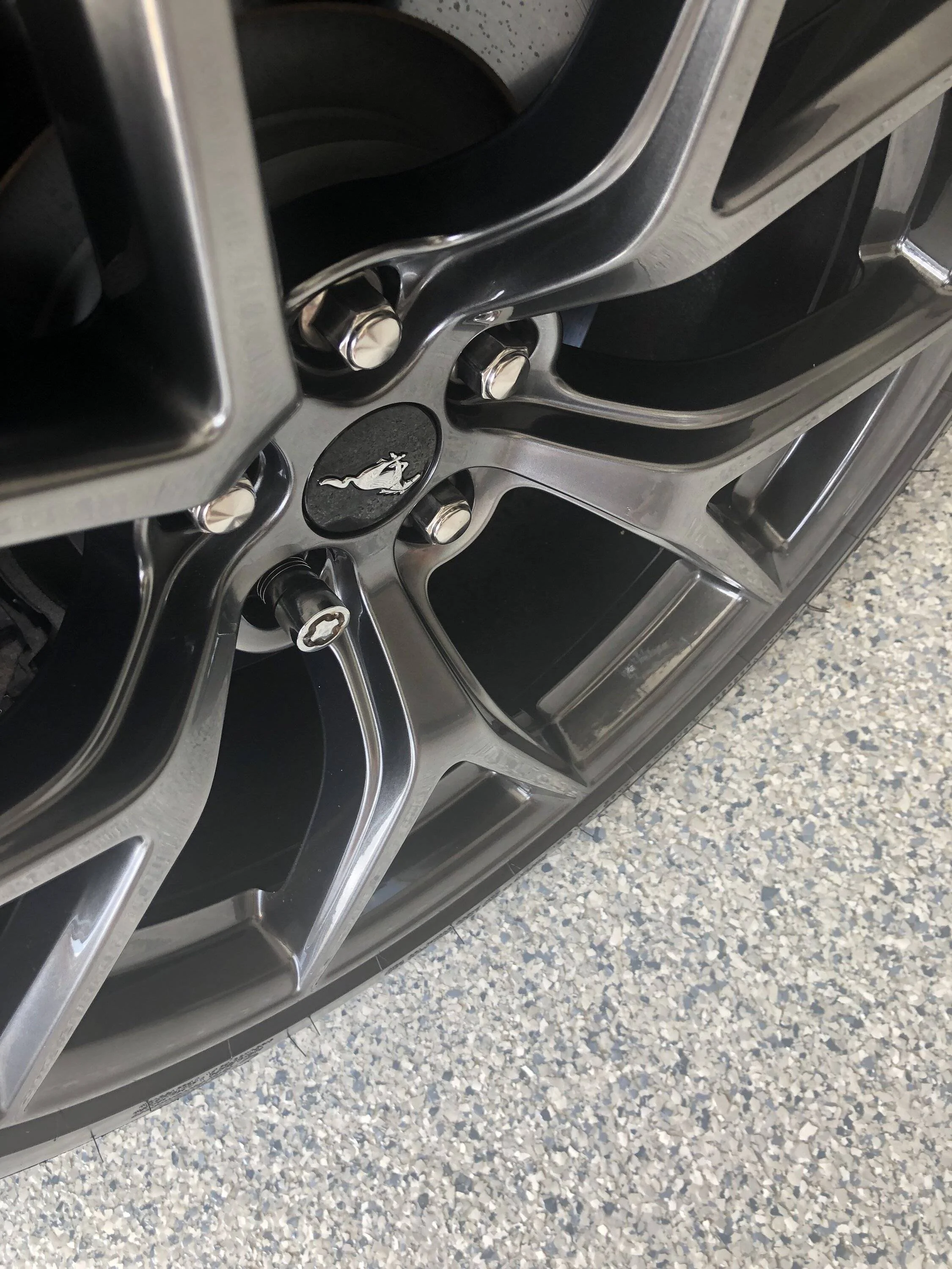

OEM same size front and rear. Lugs sit out further on rears. Normal? Why? different hubs?

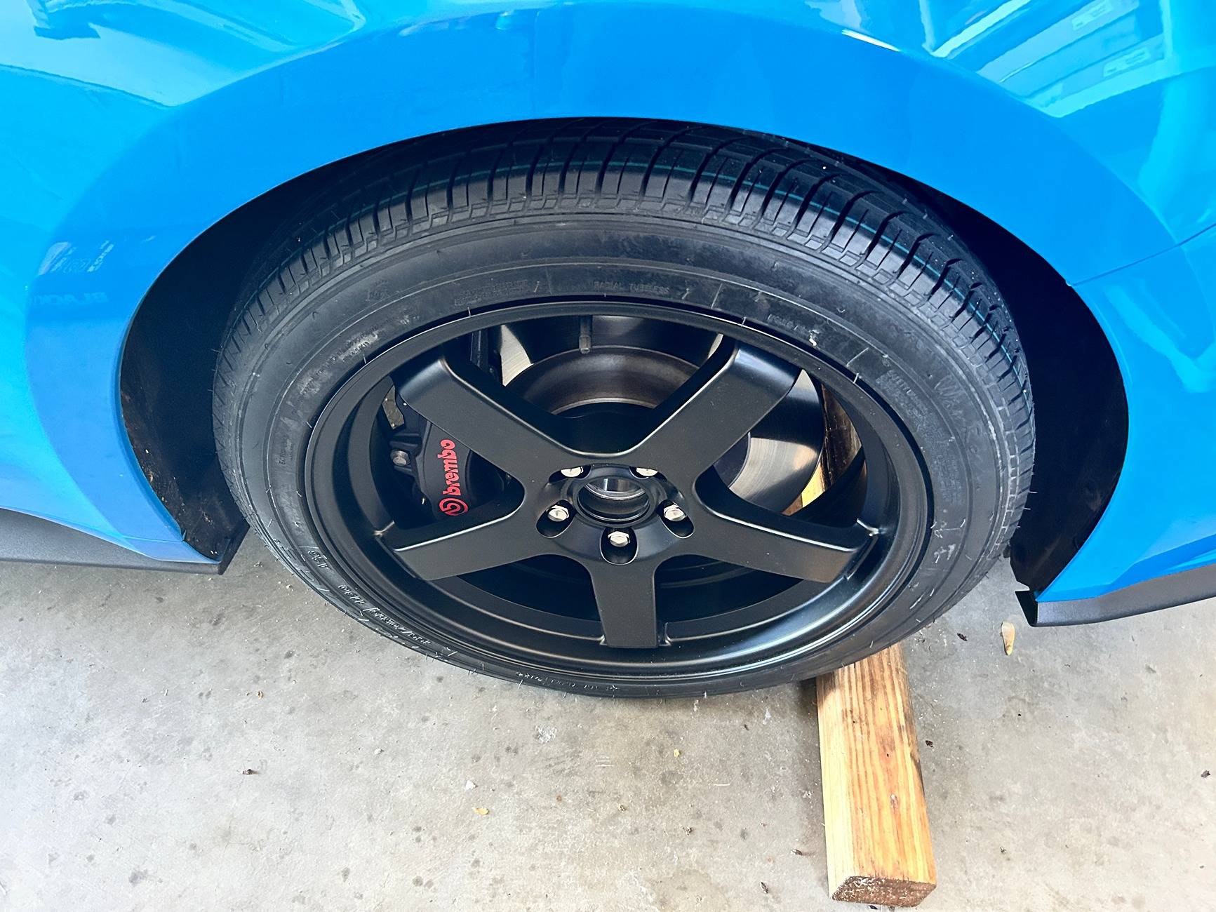

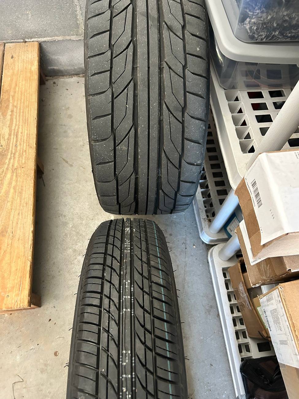

hey, I just got an automotive authority spare tire that they say will fit all around???
Had it for my mach 1 but never even tried it.
skinnyb
Jun 25, 2022
3,670
9,289
Knoxville TN
Alex
21 Mach 1. FJG, Tremec, ESS G3X
I would think so. The PP2 has Brembo's like my PP car has and my AA tire fits beautifully. I put it on the front a while back and ripped around the block.
And it is definitely a Skinny compared to my 275 wide fronts :)

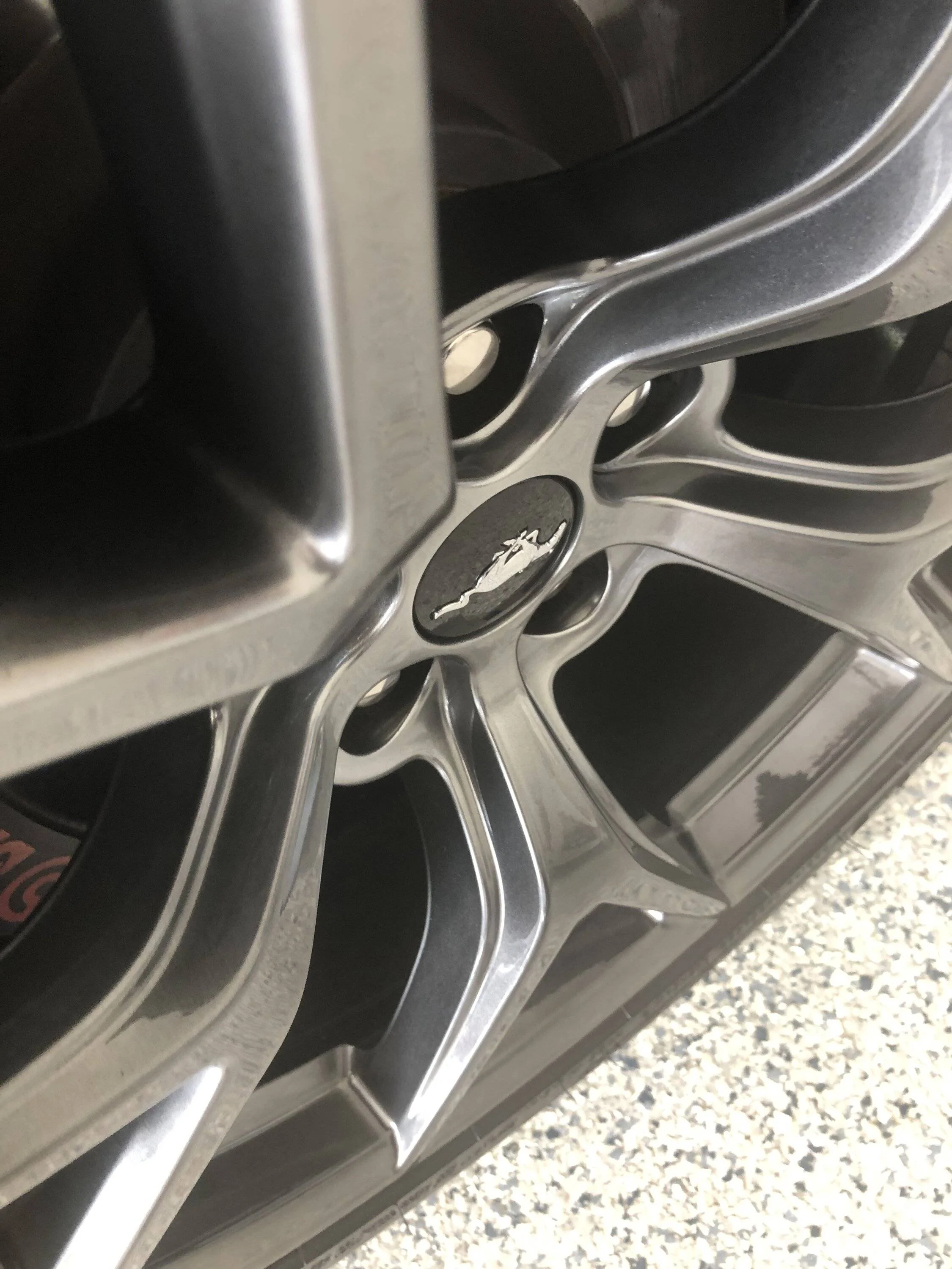

Different offsets front/rear is not the explanation. They don't just change the amount of machining of the back pad to achieve a different offset.
OP, if/when you remove a front and rear wheel, compare the depth of the straight area of the bore around the stud, i.e. below the cone area. I bet you will find that the rear wheels have shallower bore hole depths for the studs, and that is why your lugs stick out a little more.
So long as both wheels have sufficient stud/lug thread engagement, you'll be safe, but that still doesn't help your OCD with the different amount of lug "poke".

Thanks, I m confident that they are correct, just wonder why because I first thought all four were interchangeable . Learned something new.
I m not OCD enough to take wheels off just to check but the next time they are off I will, LOL.

On the PP2, the front tires look wider because the sidewall bulges a little more due to the slightly narrower rim. Along with the lug depth, that always messed with my ocd lol
