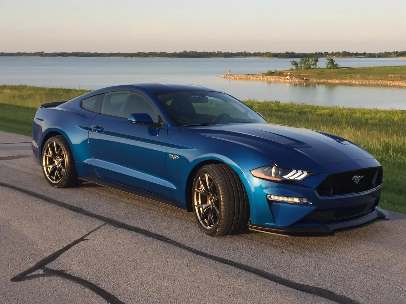

I'm running Bridgestone Potenza S-04 Pole Position summer tires in 305/30/19 on all corners. Good handling tire wet or dry. Considerably cheaper than the MPS4's, but definitely not the same overall characteristics of the MPS4's. If you want the best, get the Michelins, but you are looking at about $1,600. If you want plenty of tire for the street, the Bridgestones can be had for about $1,200.

thankyou guys and thankyou silver bullitt I see you also have a pp2 car! tires look good

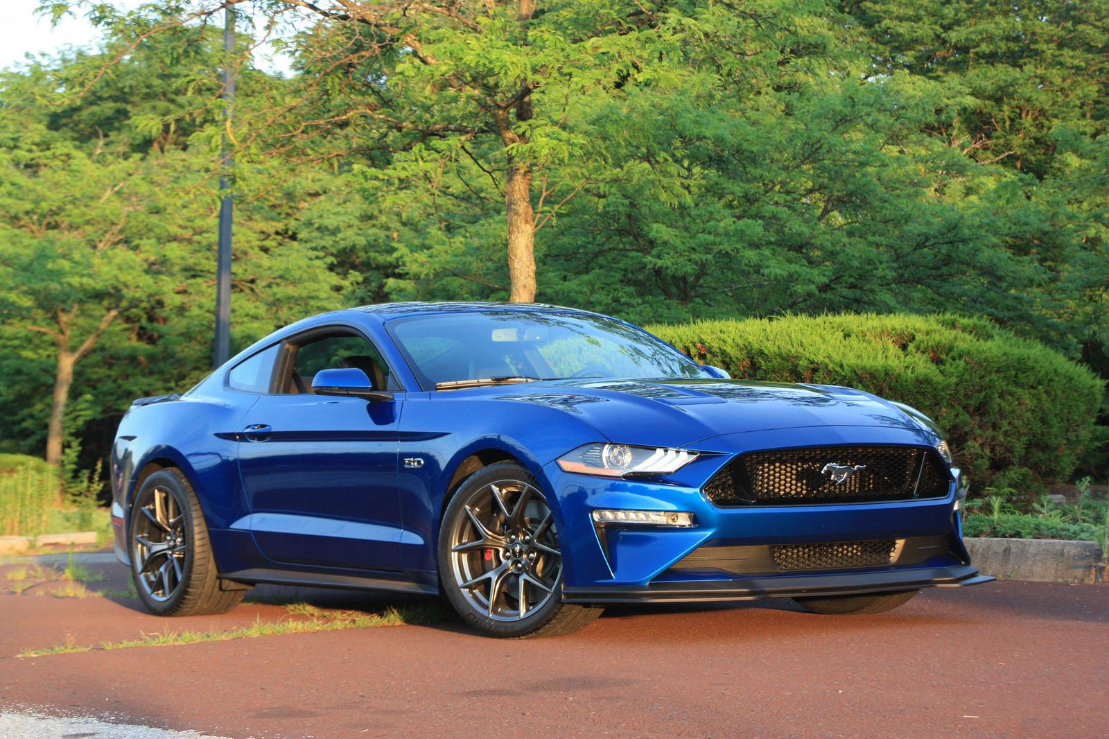

i went with the michelin 4S all around when i swapped out my SC2s. daily driving duties, these tires are perfect. i've driven through torrential downpoars and flooding with them and zero slippage. seriously impressed with them.
i went with 305/30 up front with 325/30 out back.
