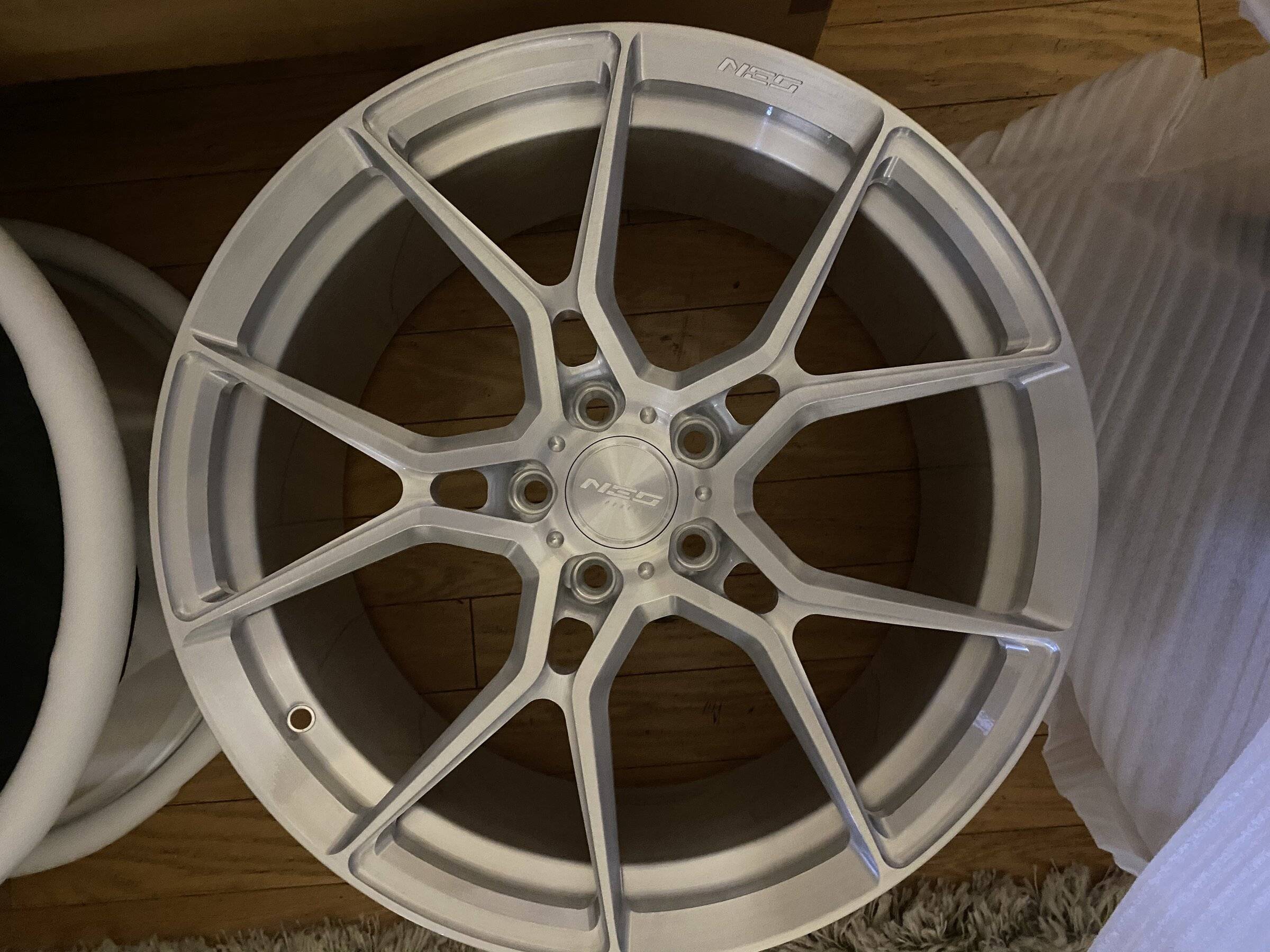

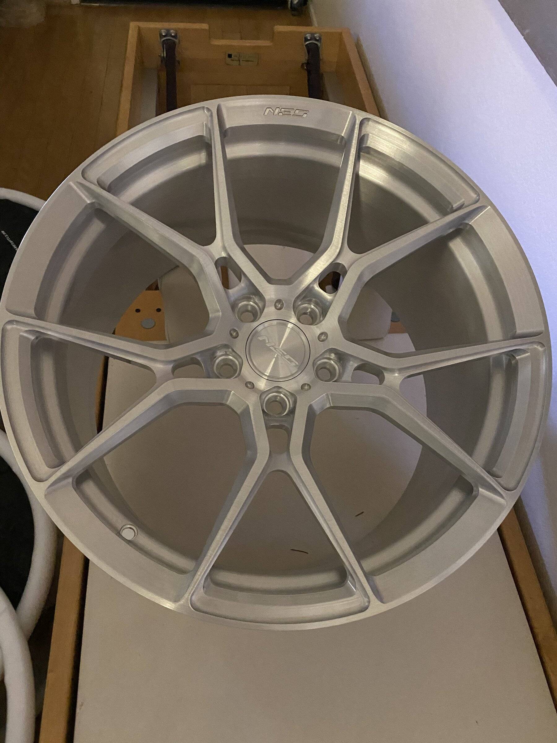

@js19 @Biggus Dickus Can you explain how Ford would sell the "Replicas" at ~$400 and the OEM at $900 when they are the same weights? Seems criminal.
Because they can (?). It is crazy because my NES wheels cost ~$1K per rim
