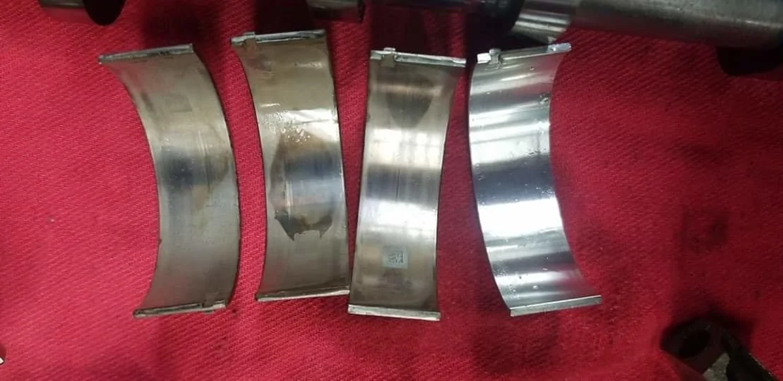

Got my car back yesterday! Have not driven far though just 2.5 miles from the dealer to garage. I am going out to Cars and Coffee tomorrow, so that will be my first real drive time.
Ford said the connector rod bearings were bad. Not sure what caused it but they were marked. Photo shows three bad ones (not sure if more were bad) and one new one.
We will see how it does, got to break it in again now.
