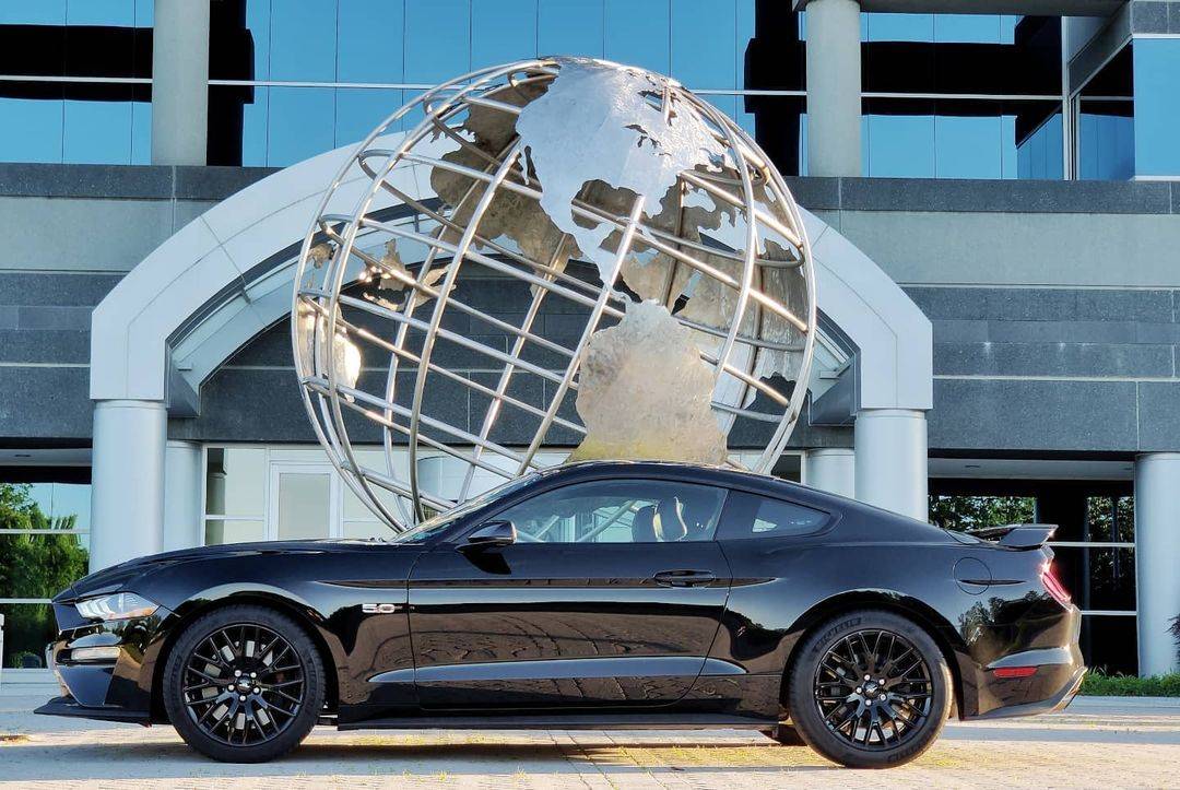

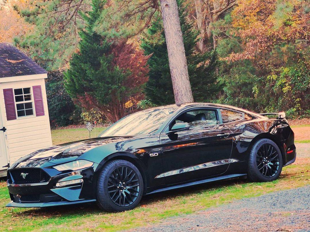

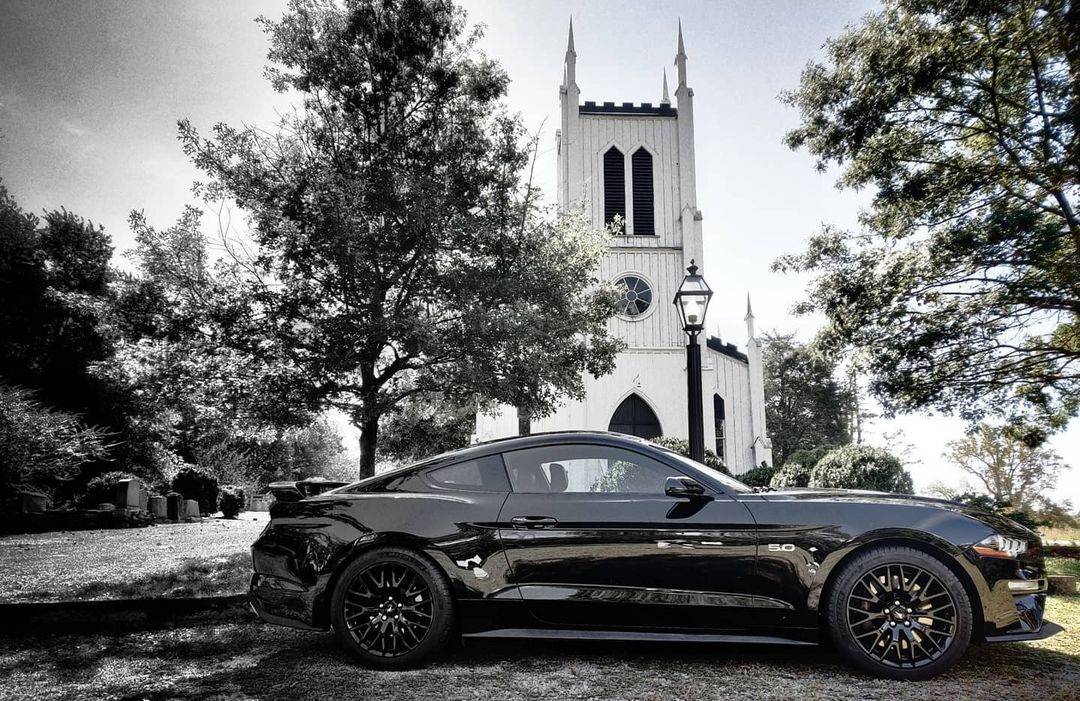

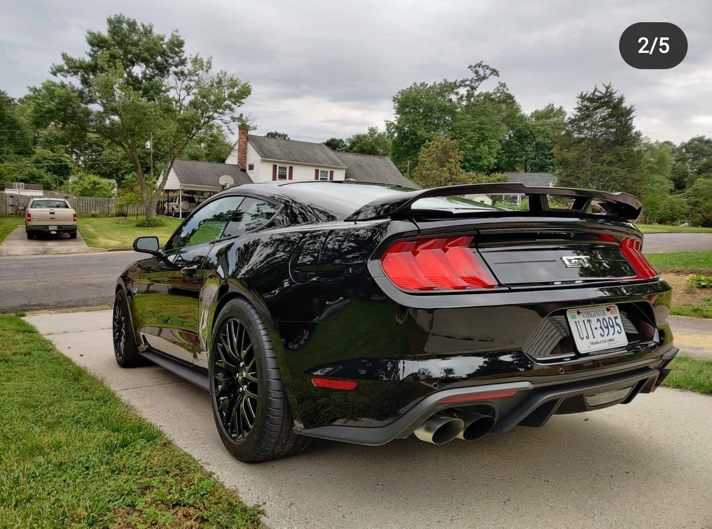

Here is my car running 1" hub centric Steeda spacers. Stock magnetic ride suspension.
When I look at these 2 pictures it looks like the wheel gap is smaller on the 1st picture. I can also tell the first picture is older than the second one because of the temp plates and dealer badge. So, did your suspension settle somewhat or is this an optical illusion? I have a 2020 PP1 with magneride 100% stock and trying to decide what springs and/or spacers to get.
Most likely the suspension settled but I don't remember the millage between the two. The 2 in the driveway were the day I got it back from ceramic coating and I think the car had around 1.2k miles.

This was november so 8k ish miles

I really appreciate the extra pictures.
I had ordered one set of 20mm spacers from Steeda and it turns out they don't work with the stock PP1 wheels without trimming the studs or drilling out the wheel pockets. I was only going to do the front to bring them more inline (or more squared)with the rears.
I'm sure that info is somewhere on the forum but I could not find it.
After looking at your pics I might just do 1" in all around also. I am not crazy about the rear tire poking past the fender edge but it's so subtle that I think I can live with it.
