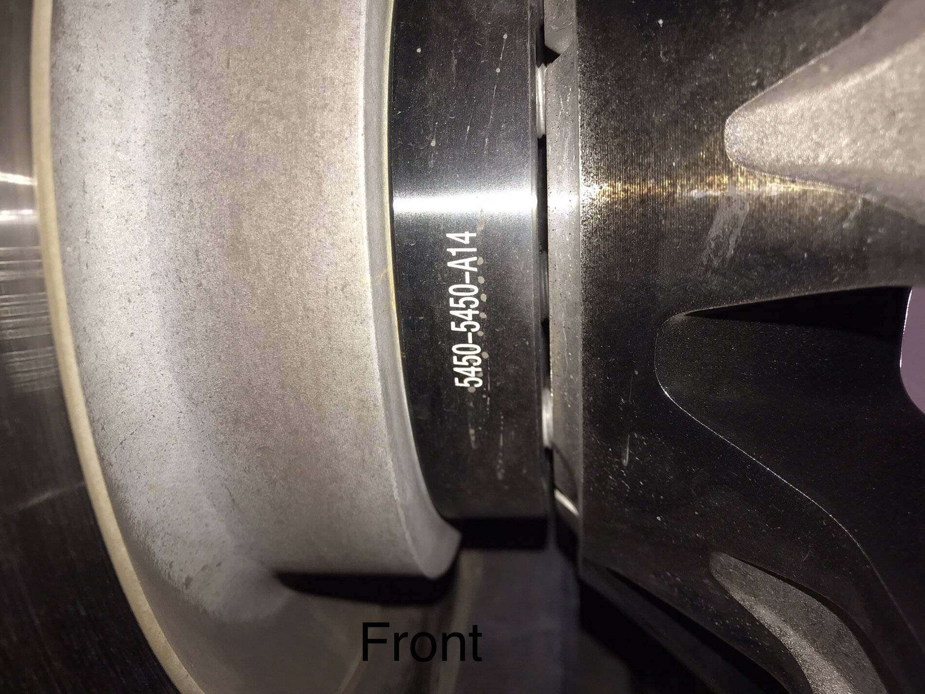

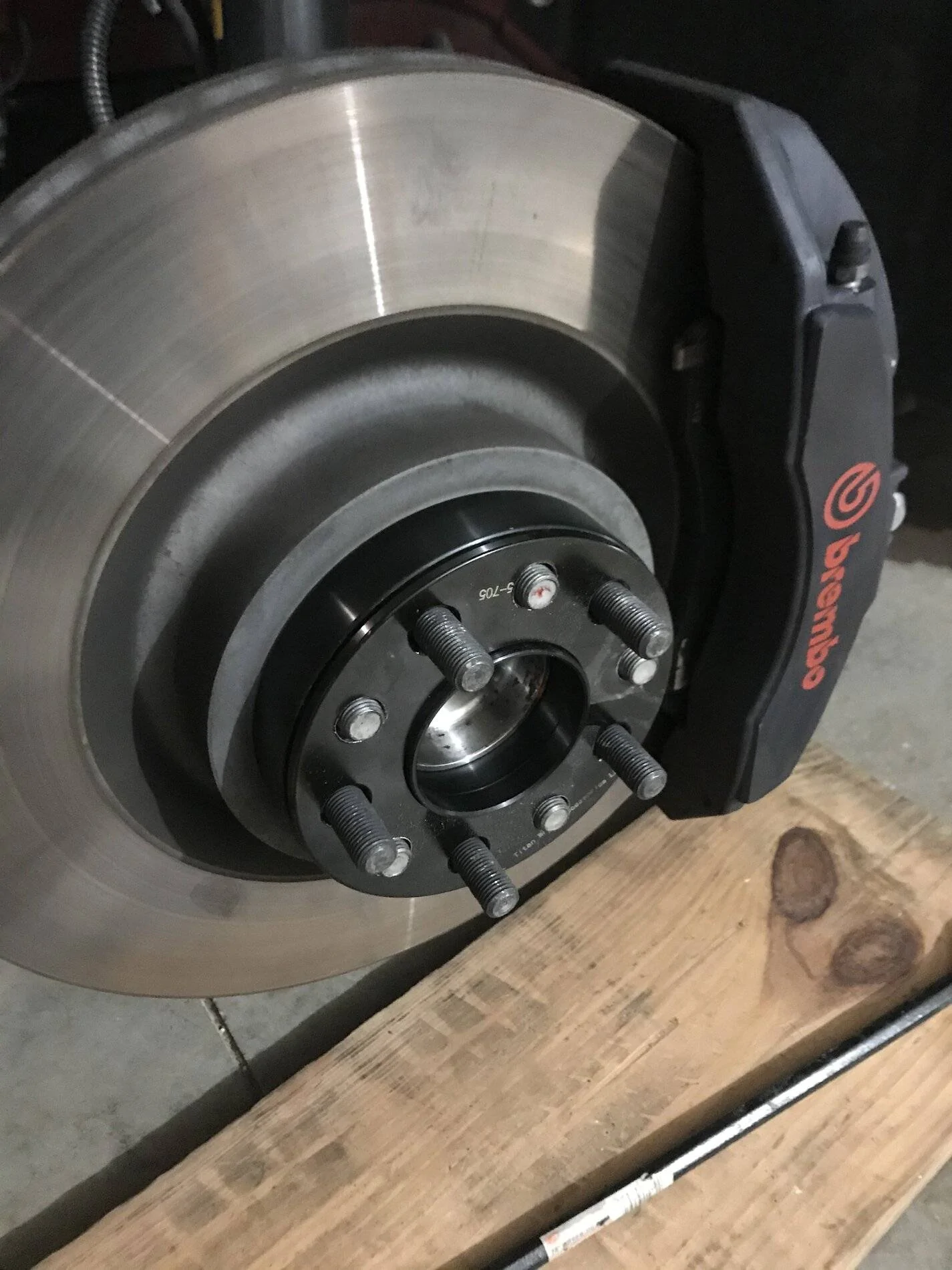

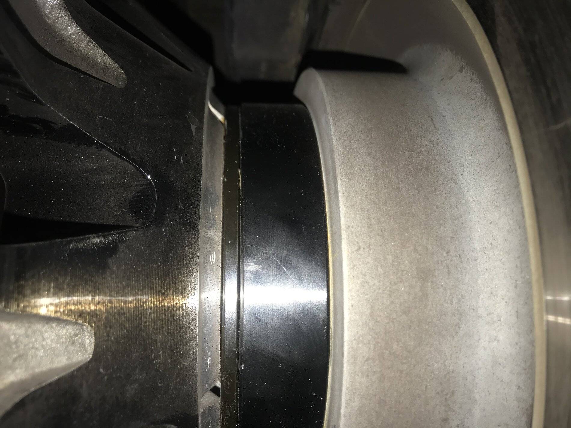

Guys if your doing wheel spacers on PP1 magneride cars then get 25mm rear and 30mm for the front. The front studs are to long and the reliefs in the back of the wheel to shallow for a 25mm spacer to fill the gap. I put the Steeda 25mm spacers all the way around on my car and ended up having to get an extra 5mm spacer to close the gap. If you put the 25mm spacers on the front and torque the wheels down it “feel” like it’s sitting flush against the spacer but if you reach your finger in there you can feel the gap. “Canadian Cruisin” on YouTube did a write up on this a while back. First pic is driver’s side front before 5mm spacer and second and third pics are after.
