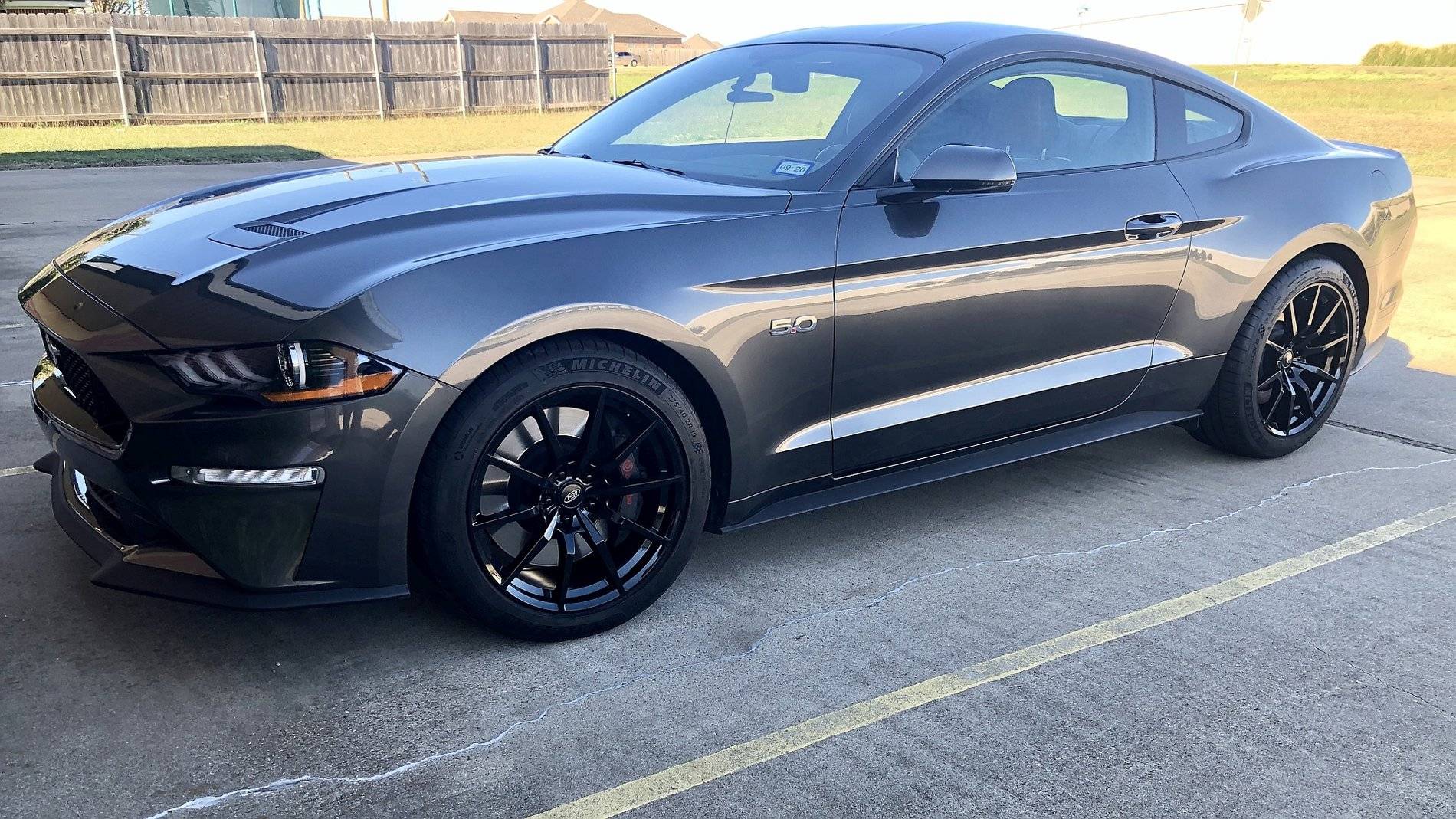

I'm running 275/40s for the same reason, to close some of the wheel gap. Since all you'd be doing is getting the fronts to match the rear, I doubt there would be any impact to how magneride works. I suspect the only reason stock magneride cars come with what they do is because that's what all PP1 cars come with.
